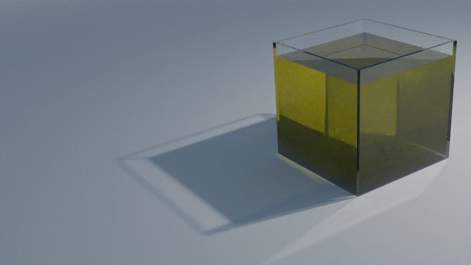

The original problem, leading to the implementation in BiDir, was described in this forums post (with example images):
viewtopic.php?f=4&t=4219
The contrasting observation for Path+Light (with example images) was posted in this GitHub issue:
https://github.com/LuxCoreRender/LuxCore/issues/671
In the SDL, the syntax is as follows:
scene.materials.MaterialName.transparency.shadowoverride = 1
The mechanism of shadow color is a biased technique, and using it leads to different behavior between path- and light-rays unless some explicit decision is made.
In case these paths are very similar, this just leads to double brightness. (See the linked original problem)
In case the paths are very different, there may be some merit for artistic applications. (See the linked GitHub Issue)
BlendLuxCore now features an "override" setting that allows light-tracing rays when the shadow color is not black.
With this setting, the present behavior of Path+Light can be restored, and likewise be achieved with BiDir.
