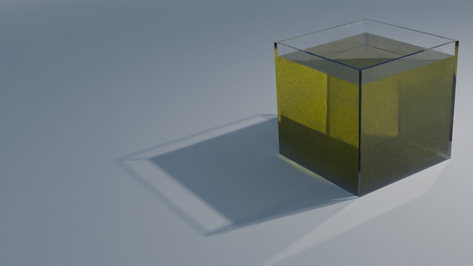

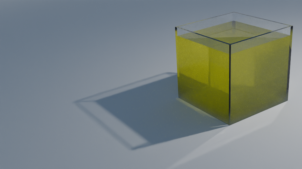

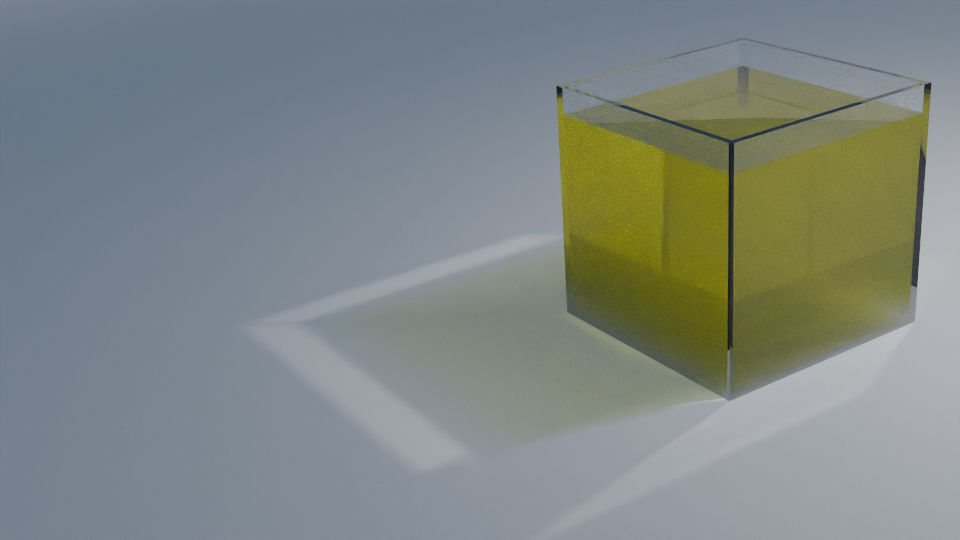

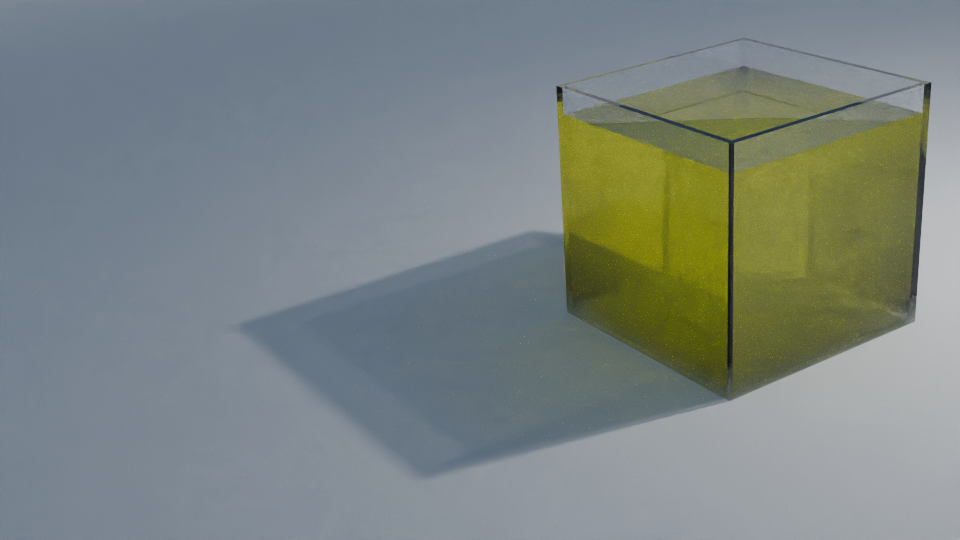

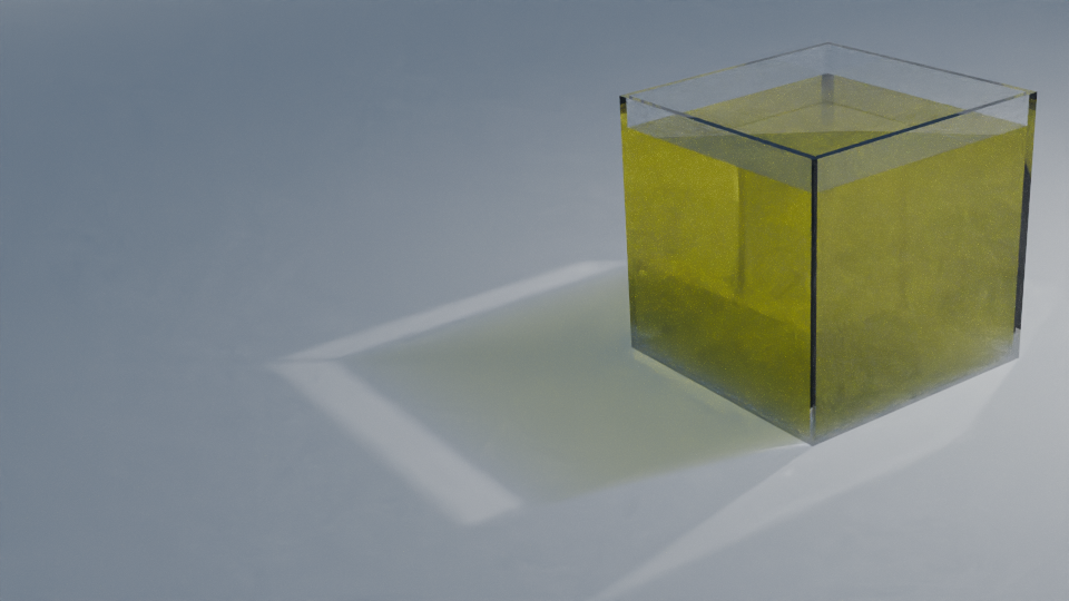

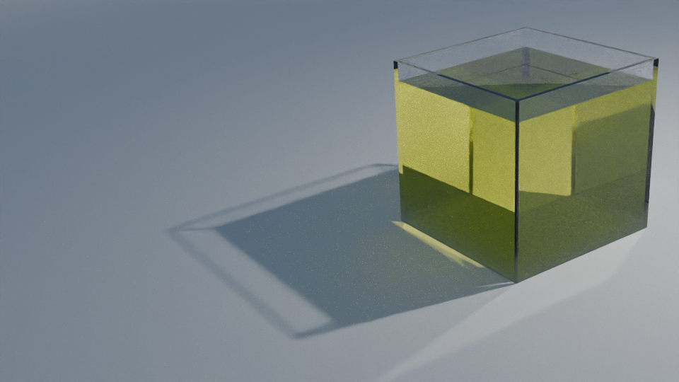

BLC 2.10.1 | Glass Cube, no Volumes
Post by FarbigeWelt »
I've tested different settings for a simple glass cube box filled with a yellow liquid.
First tests are material settings without volume.
I've encountered an issue with GPU rendering.
GeForce RTX 2080 Super renders only about 5% faster than Radeon RX 5700 XT (see LuxMark 3.1)
But here the combination CPU/Radeon renders much slower than CPU/GeForce.
If Light Tracing is enabled in combination with GPU RX 5700 XT the CPU AMD 5950X renders with the same speed as CPU only.
Compare AMD with aRX/AMD times for 0.5 HD renders in the lists below.
AMD: AMD Ryzen 9 5950X 16 cores, 32 threads
aRX: AMD Radeon RX 5700 XT
nRTX: NVIDIA RTX 2080 Super
CPU: Apple M1 16 GB
GPU: Apple M1 16 GB
Glass, sharp edges
Liquid, cube, sharp edges
Path-, Light Traycing Sobol
CPU, 128 samples, 2:38
AMD, 134 samples, 00:33
GPU/CPU, 128 Samples, 1:42
aRX/AMD, 134 Samples, 00:25
nRTX/AMD, 135 Samples, 00:15
aRX,nRTX/AMD, 152 Samples, 00:11
BiDir Metropolis
CPU, 128 Samples, 1:33
AMD, 131 Samples, d12, 00:23
CPU_BiDir MLT
CPU_BiDir MLT
CPU_Path, Light Tracing
CPU/GPU AMD, NVIDIA
CPU/GPU AMD, NVIDIA
CPU/GPU AMD
CPU/GPU AMD
CPU/GPU NVIDIA
CPU/GPU NVIDIA
