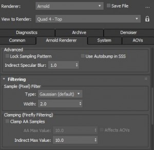

As I can see Arnold renderer also add support for the FireFly filter too and it is in the Clamp Filtering category. is this the same luxcore clamp option or a different one?
