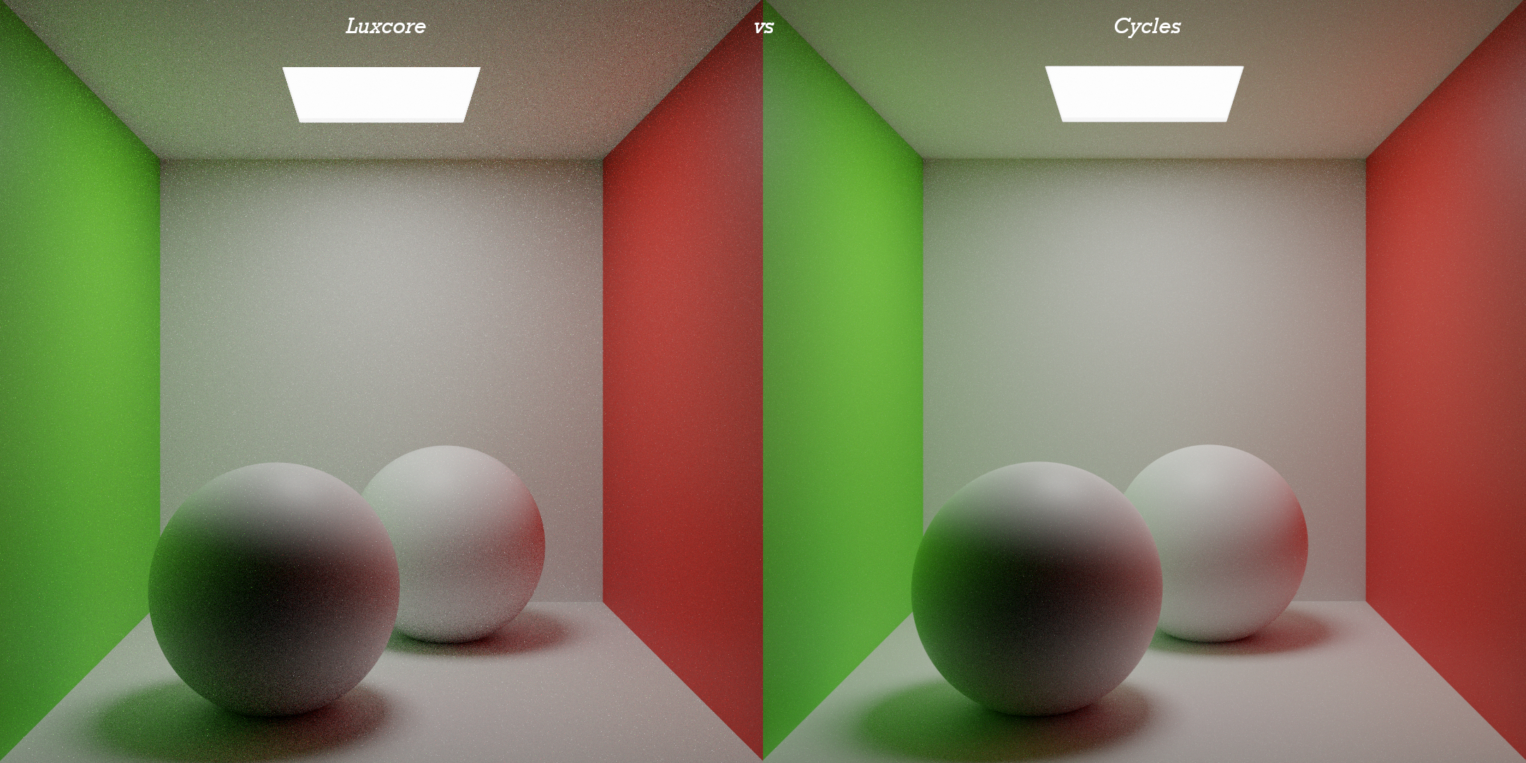

Aside from this issue the problem is that without clamping Luxcore start to produce too much fireflies
and noise. It is something i have already noticed myself in the past even in simple scene. In my test It
Look like Cycles tend to have something that stop this to happen like an invisible clamping code operating
behind the scene. I'm not a dev so can't confirm this.
But here is a simple scene where you can see the behaviour :
Just render first with cycles and use the render time of cycles
as Luxcore halt time value to compare noise level. In my test
Both took 113 secs on a i7 4930k
Blendfile
CvsLX.blend
(1.69 MiB) Downloaded 1604 times
Luxcore is much noisier and you can see fireflies don't clear
fast enough.
To reach the same noise level as cycles you have to run
the render for at least 3X the cycles time.
Cycles 113 secs
luxcore 348 secs

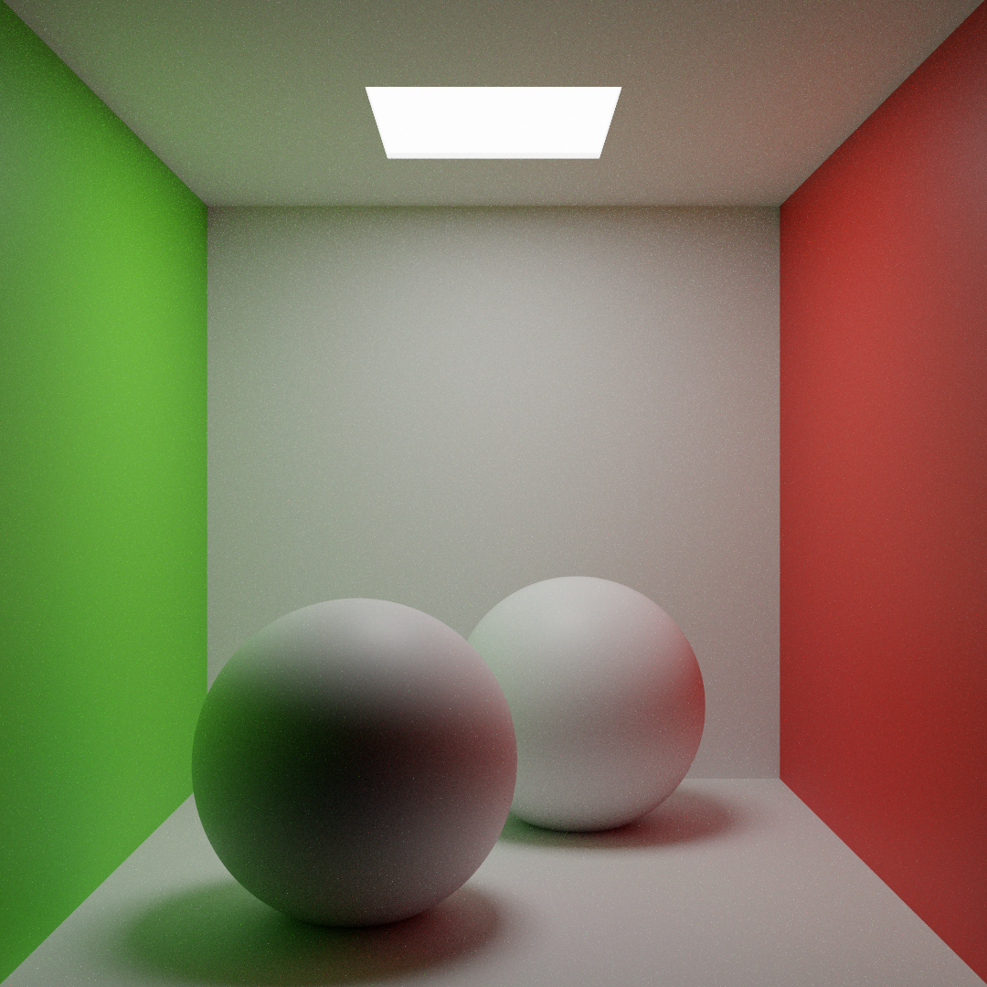

I have already try to show that in the past :
viewtopic.php?f=4&t=1603&hilit=porsche
viewtopic.php?f=4&t=2612&p=25539&hilit=porsche#p25539
The Porsche test :
Luxcore
Cycles
BlenderBrit
