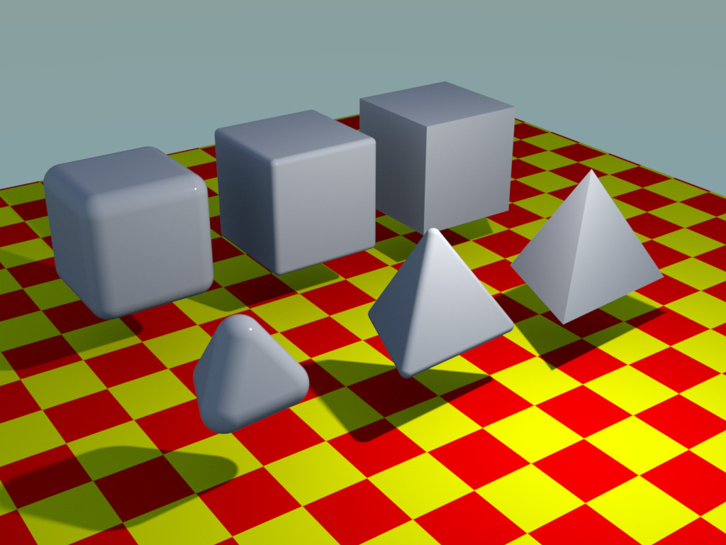

This render of the cube is the coolest render over the past few years.

Re: Baking Bevel in Cycles
The agony of having to wait. Ahhhhhhhhh!
amazing results as always.
and now..concave shape ...
Great results Dade ! This will be very useful for realistic renders...

A last follow up on the normal mapping issue. Here are two comparisons. The left one uses displacement to create the surface structure, the right one uses normal mapping to do so. As you can see, in the displacement version the gray floor is properly reflected in the elevated areas. In the normal version, the reflection is very dark.
I'll leave it up to you guys now to decide if this is worth investigating.
AndreasResh, I find you test well done and test / illustrate well current limitations. Comparing with displacement is a good idea. So thanks for taking time for this and sharing your results.
I wonder if displacement in Lux would exhibit the samed bright border (fresnel?) seen in the Cycles renders, but it might also be due to the shaders.
