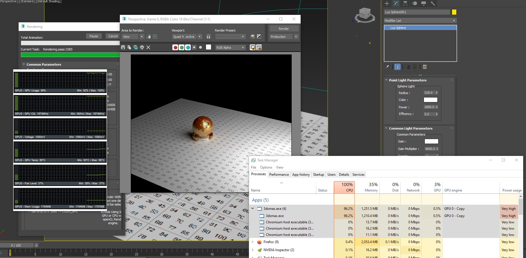

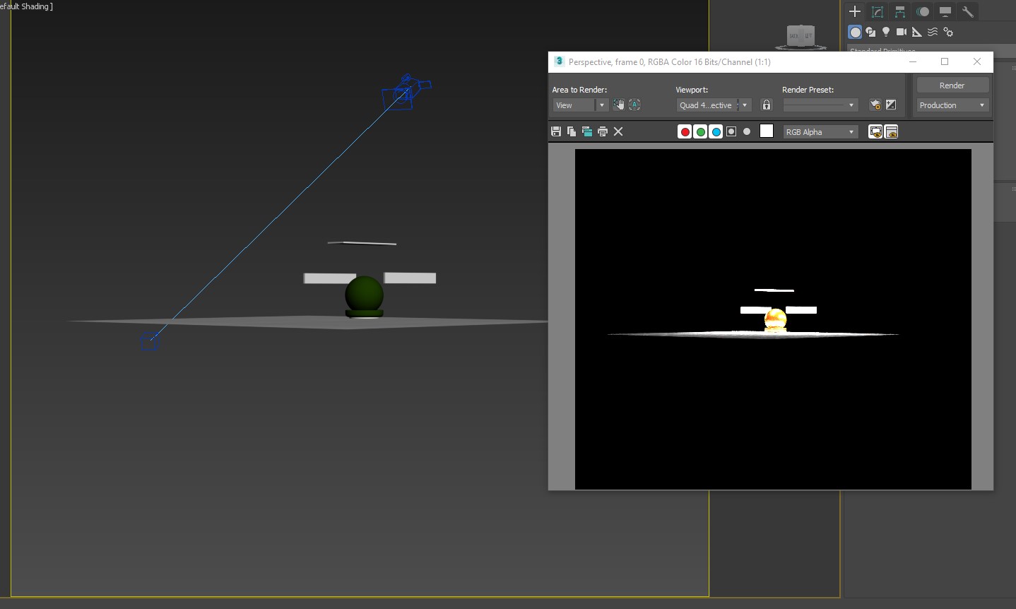

Sphere light issues fixed.
more than 3000 passes and no issue. I'll try to upload a new build by the weekend. if any problem persists, you need to provide me a scene that shows the issue.

TAO wrote: Wed Mar 10, 2021 2:32 pm Sphere light issues fixed.
important that you could replicate the reported issue, it was a bug of the light. For other issues i share always the scene.
the sphere light issue escalated after few pass, 3000 passes I can safely say it is fixed :D
