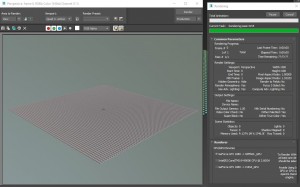

maybe i can explain that in a screenshot in next post.
