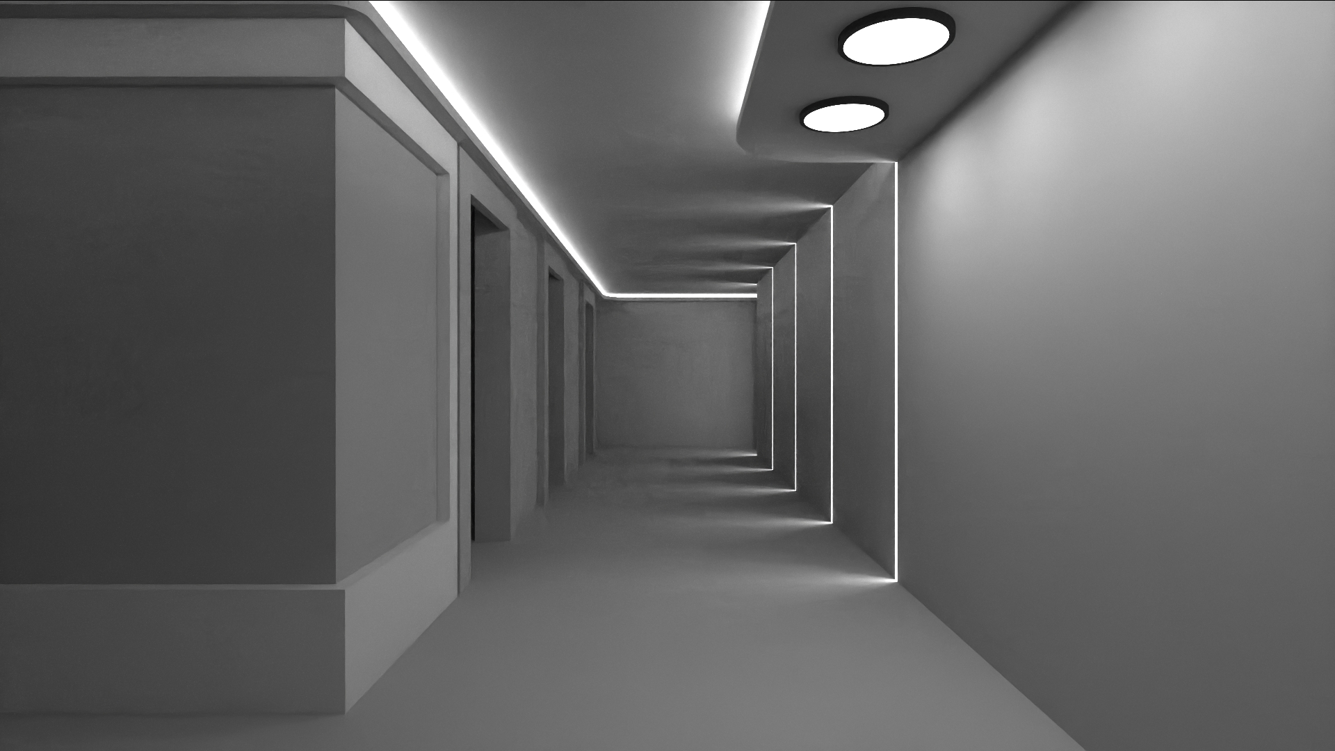

I think you can optimize it more. Gpu vs Cpu can give you a big advantage.
In my personal project, i will never use this much light at the same time instead i use bigger light with more segments, not the exact same but LuxCore uses every segment as a different light emitter source.
Like in this render, all done with mesh light and just in 120 seconds.
Of course, too many lights will take too much time to process.

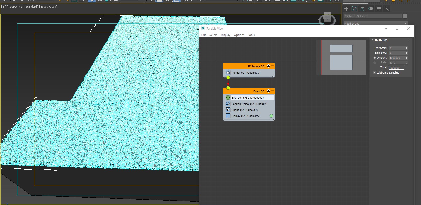

Re: Light emitting instances
I tried a scene with 1.000.000 lights in 3dsmax, and it takes no time to translate, and with 80 sec of rendering is pretty good looking.
i used particles as light sources and material light emission. so all lights are cube mesh light sources.
TAO wrote: Fri Feb 19, 2021 10:12 am i used particles as light sources and material light emission. so all lights are cube mesh light sources.
The previous test scene uses a sphere with ~4000 triangles as particle. It is a huge difference when compared to the 12 triangles of a cube.
