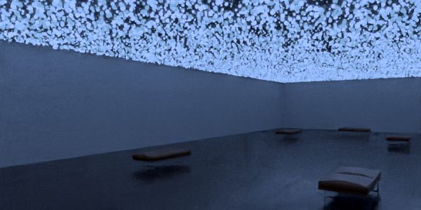

Hi, this scene, which has three instance groups, each of 5.000 instances of an 2200 polygons sphere, is making some troubles. Luxrender keeps doing something for 3 minutes and but then makes the redering itself in 15 seconds.
Are there some known issues with Lux dealing with many light source instances?

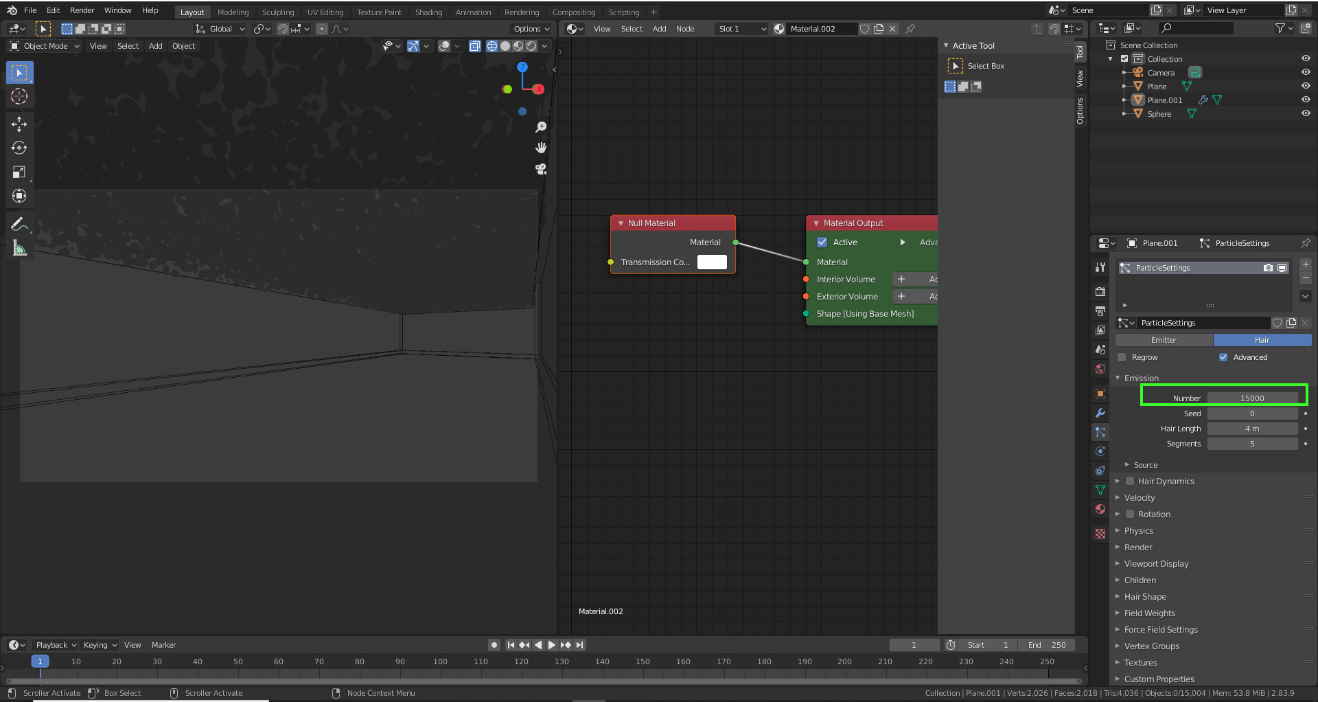

Play with the number in green to increase or reduce instances (Put 150 or 1500 to not process forever)
BTW you can switch to cycles to see the difference.

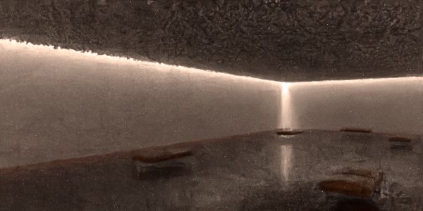

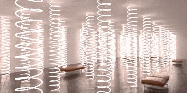

By the way, the instanced shpere schene has almost the same total amount of light emitting polygons,1.2M, as the full geometry no instances spiral scene (1M).
The instance scene reaches 16GB ram.
35 seconds
4 minutes

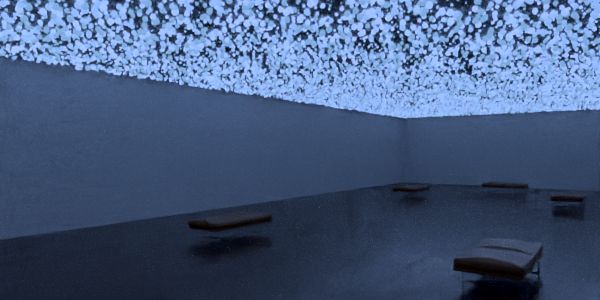

Is the parsing process related only to instanced emitters?
16.000 light emittings instances
4 minutes
