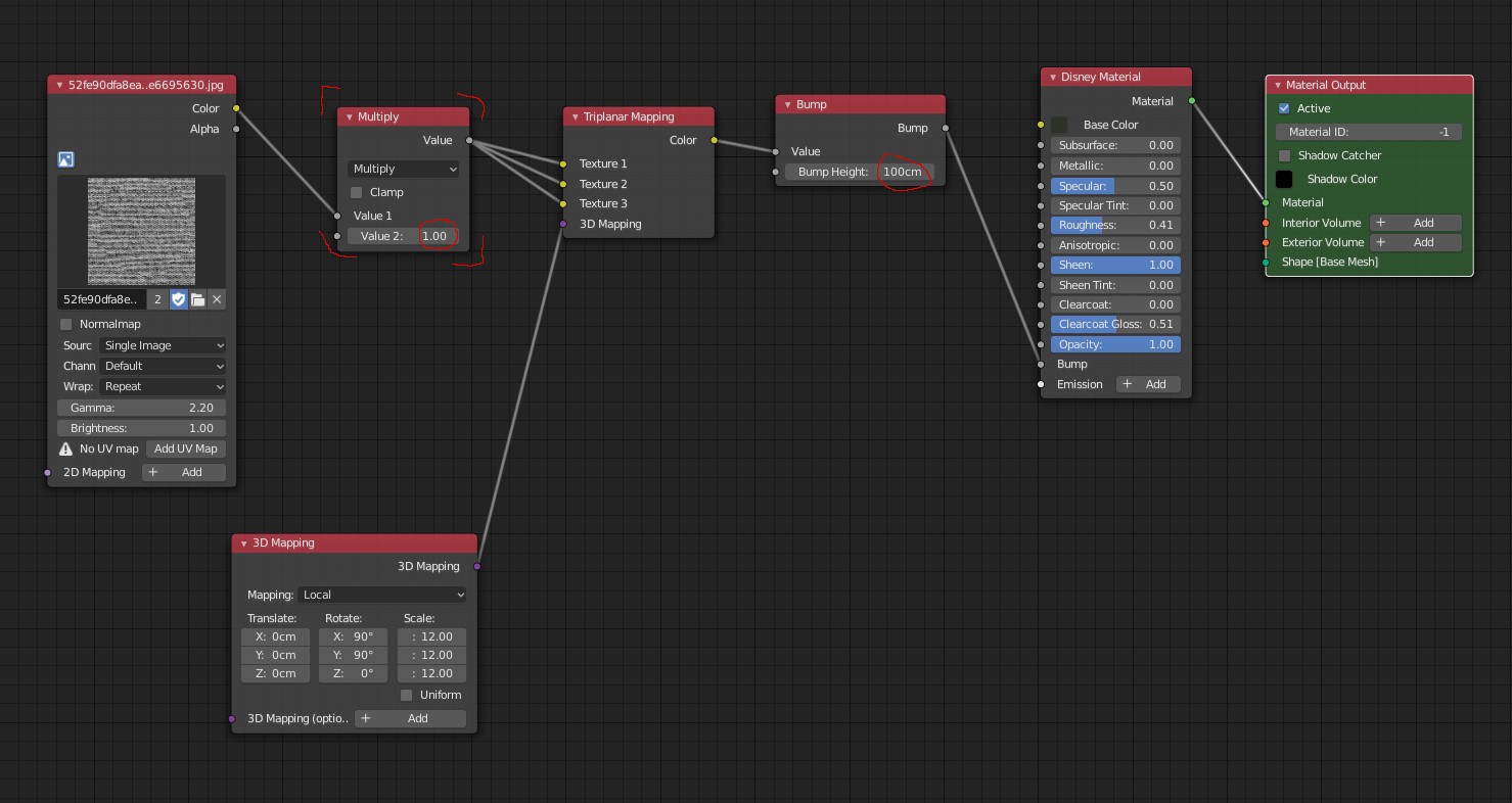

I had to write the OpenCL code.
I pushed the source with UV-less bump map support for triplanar texture. It is enabled by default so you can try it with the current version of BlendLuxCore. However you need to use a specific node setup:
You must:
1) set the bump height to 100cm so BlendLuxCore will use a scale of 1 (to neutralize the node BlendLuxCore add under the hood);
2) than you must use a Multiply node to really scale the bump map intensity. Values are similar to usual bump map, something like 0.01 will work however the bump mapping is a bit stronger so you may have to adjust the value.
This is a test, we can than implement this support as a flag in BlendLuxCore "Bump" node (and BlendLuxCore can take care of the above stuff): something like "Enable UV-less".
You must:
Ok, thanks for this. But it needs to be much more straightforward. This even more emphasizes the need to have this embedded in image node. Like an UV/check (user input check for cases where uv exists but is shit - "has proper UV's = boolean yes/not check) and then auto enable scaling and maybe even enable multiplier for basic scaling and add tooltip that for advanced scaling a proper uv's are needed and a separate 3Dmapping node...

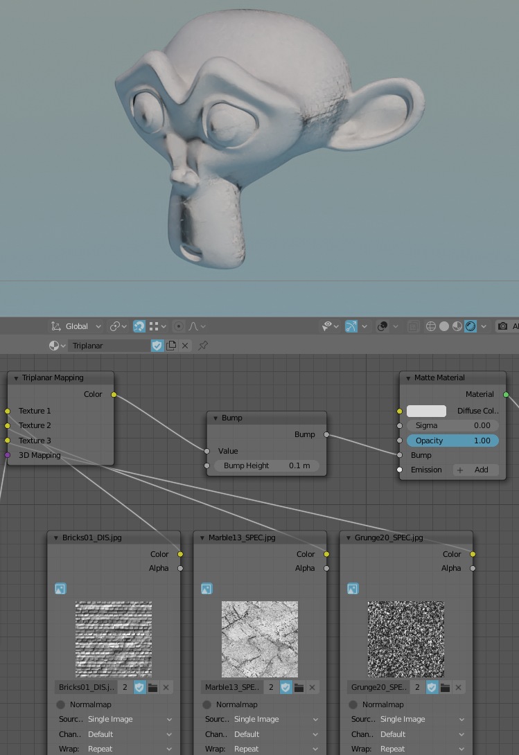

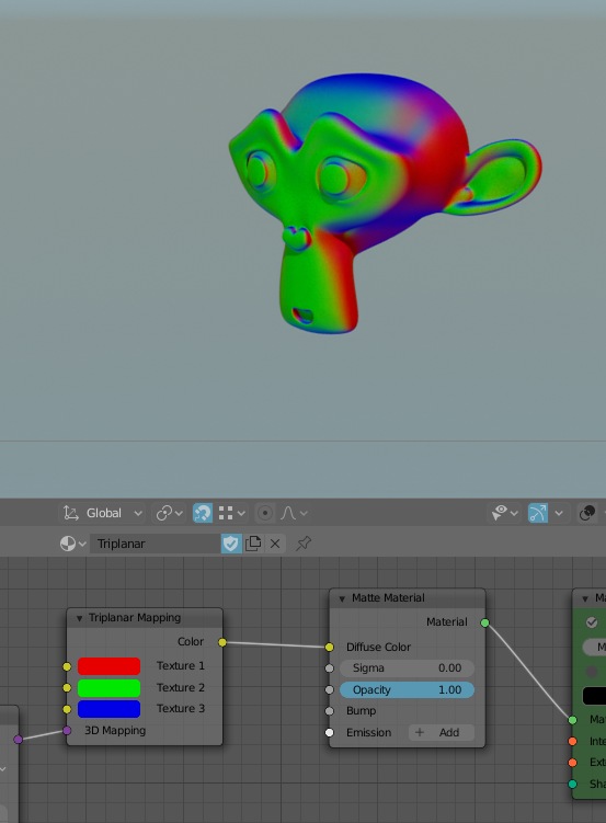

So, does it work ?
Posts: 822
Dade wrote: Tue Jan 14, 2020 3:44 pmSo, does it work ?
Suzanne looks OK.
Q: Is there any control to manipulate the overlay blending like it can be done with Cycles (Blend value)?
ie
Edit
Ah, the Bump seems to have no effect where textures blend.
- Bump only
- Bump + Diffuse
Edit2
Used another, different set of textures from CC0textures & well, this time everything looks OK.
e.g.
- Bump only
Triplanar_test_LC.7z
(4.78 MiB) Downloaded 1660 times
