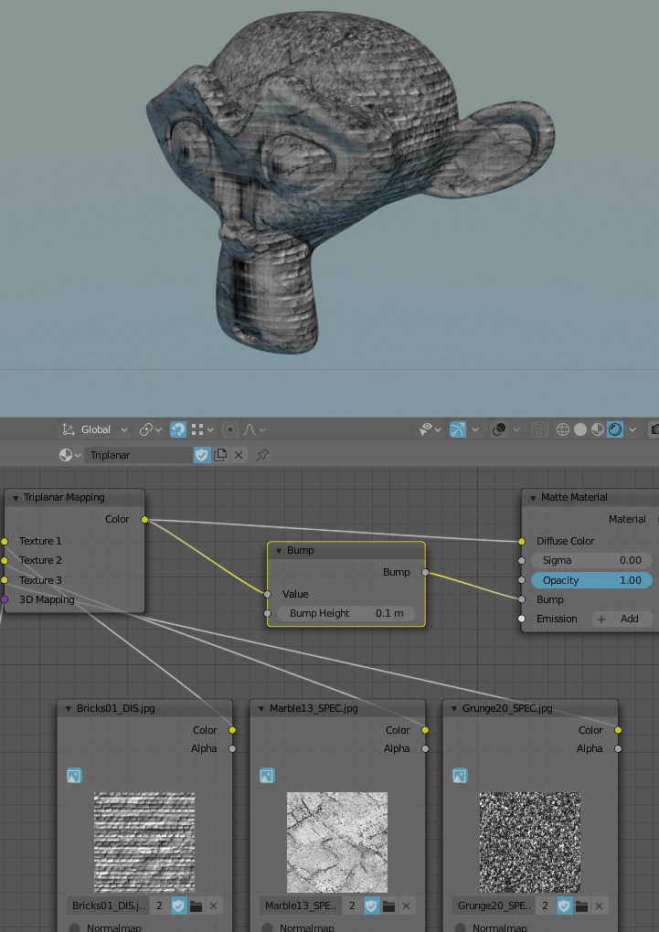

Suzanne looks OK.
Q: Is there any control to manipulate the overlay blending like it can be done with Cycles (Blend value)?
ie
Edit
Ah, the Bump seems to have no effect where textures blend.
- Bump only
- Bump + Diffuse -----------------------------------------------------------------------------------------------------------------------------------------------
Edit2
Used another, different set of textures from CC0textures & well, this time everything looks OK.
e.g.
- Bump only
- Attachments
Triplanar_test_LC.7z- (4.78 MiB) Downloaded 1659 times
