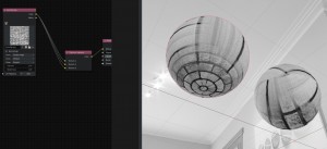

When i've put texture in the triplanar node inputs it didn't do anything and when i made some basic uvs for the mesh, texture showed up on object but it was weirdly stretched and had different density on different parts of the mesh.
I'll try to play around with it llater today or sometime tomorrow on few other objects.
I know it wasnt merged, I just created files and copied the code etc manualy. (that actually might be the problem, lol)
You probably need to set the 3 textures to use LOCALMAPPING3D and have the center of the mesh object well placed to have the expected behavior.

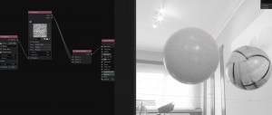

ok, a simple sphere.
the one on the right has uv mapping (wih seam accross the center which you can clearly see) the one on the left has no uv mapping
1. it's pretty clear that if an object has uv mapping the triplanar mapping is somehow using it as it's different as with an object that has no uv's
2. if object has no uv's the mapping is stretched weirdly
3. 2d texture node in blender doesn't even allow to input 3d mapping
So, maybe I'm doing something wrong, maybe I broke something while "hacking" this thing into blendluxcore from pull request or maybe it's not working properly...? Can someone esle test a basic sphere(or other object) without UV's and using a texture?
EDIT:
Actualy it's a bit different, cause the sphere has some uv mapping already, if I delete the uv's I get no texture projection on the object
I have the feeling the BlendLuxCore support is wrong, you have to set the mapping of the triplaner texture node to LOCALMAPPING3D ... but it looks like you don't have a mapping setting there.
I will try to check.
P.S. it is than very important to have the object local reference origin at the center of the sphere.
