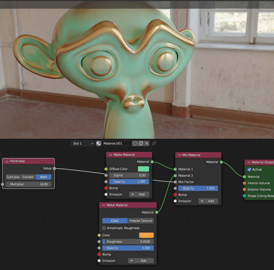

Re: What happens with Pointnes Scene in 2.6 and later
Here is pointness under Blender 3.41 and blendluxcore lastest :

Thank You! Maybe, its because of algorithms was changed.. For me Pointness is inconceivable thing.. Big thanks for a simple solution and understandable node tree!

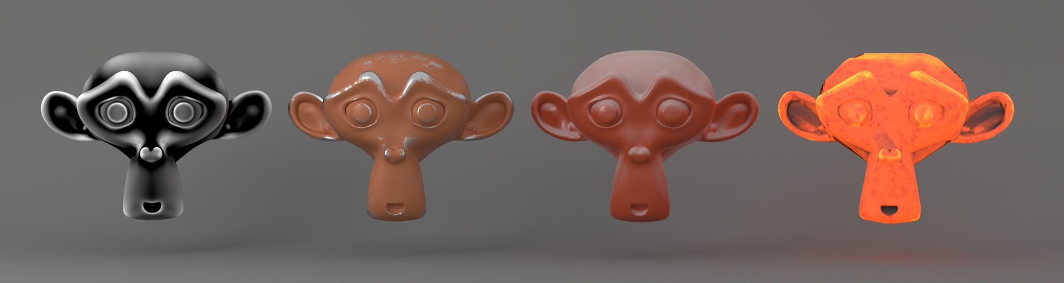

I remade the scene to work with luxcore 2.6:
PointinessExamples luxcore 2.6.blend
(1.64 MiB) Downloaded 812 times
It was not working because in version 2.6 the pointer node does not work properly, in blender 2.92 with luxcore 2.5 the original file also works fine.
Also, works fine on Blender 3.6.0 LTS w/ BLC 2.71beta
tnx Luximage!
