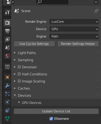

It wont detect my GPU even though its under system preferences. I have rtx 570 4th gen and it doesn't show up under devices and when I set it to render under GPU it doesn't change and stays with the CPU.

This is what shows up

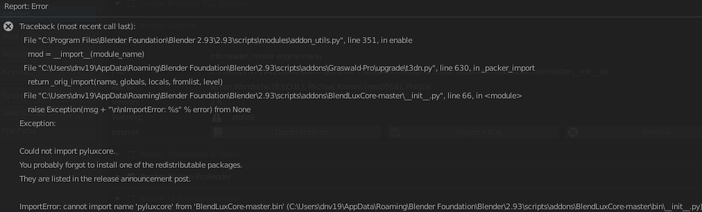

I have the feeling you have downloaded the wrong package, have you downloaded from here (viewtopic.php?f=9&t=736) ?

Did you try to do a final render? Your screenshot only shows the viewport, which by default uses the CPU even when you set GPU for final renders.kornflakekilla wrote: Sun Oct 31, 2021 7:27 pm It wont detect my GPU even though its under system preferences. I have rtx 570 4th gen and it doesn't show up under devices and when I set it to render under GPU it doesn't change and stays with the CPU.
By the way the LuxCore GPU API settings are in the addon user preferences, the Blender/Cycles setting is not used by BlendLuxCore.

Yes I did I thought I had to because it says id need to use an older version of blender for the other one!!Dade wrote: Sun Oct 31, 2021 11:04 pm I have the feeling you have downloaded the wrong package, have you downloaded from here (viewtopic.php?f=9&t=736) ?

Yes and nothing shows up I tried the same render using prorender and it showed up. And I tried to add the addon ill try again thank you!!B.Y.O.B. wrote: Mon Nov 01, 2021 12:00 amDid you try to do a final render? Your screenshot only shows the viewport, which by default uses the CPU even when you set GPU for final renders.kornflakekilla wrote: Sun Oct 31, 2021 7:27 pm It wont detect my GPU even though its under system preferences. I have rtx 570 4th gen and it doesn't show up under devices and when I set it to render under GPU it doesn't change and stays with the CPU.

Yes, correct.kornflakekilla wrote: Mon Nov 01, 2021 1:31 pmYes I did I thought I had to because it says id need to use an older version of blender for the other one!!Dade wrote: Sun Oct 31, 2021 11:04 pm I have the feeling you have downloaded the wrong package, have you downloaded from here (viewtopic.php?f=9&t=736) ?
