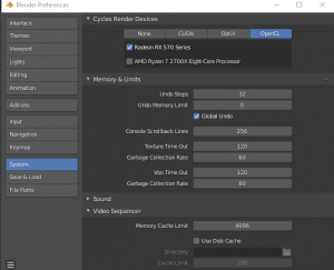

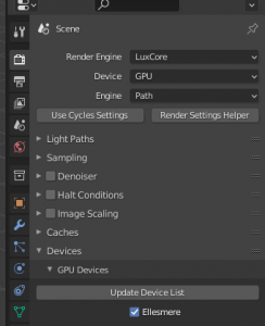

It wont detect my GPU even though its under system preferences. I have rtx 570 4th gen and it doesn't show up under devices and when I set it to render under GPU it doesn't change and stays with the CPU.

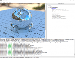

Try to run LuxMark, does it work ?

Dade wrote: Sun Oct 31, 2021 8:11 pm Try to run LuxMark, does it work ?
This is what shows up

kornflakekilla wrote: Sun Oct 31, 2021 7:27 pm It wont detect my GPU even though its under system preferences. I have rtx 570 4th gen and it doesn't show up under devices and when I set it to render under GPU it doesn't change and stays with the CPU.
Did you try to do a final render? Your screenshot only shows the viewport, which by default uses the CPU even when you set GPU for final renders.
By the way the LuxCore GPU API settings are in the addon user preferences, the Blender/Cycles setting is not used by BlendLuxCore.

B.Y.O.B. wrote: Mon Nov 01, 2021 12:00 am
Yes and nothing shows up I tried the same render using prorender and it showed up. And I tried to add the addon ill try again thank you!!
