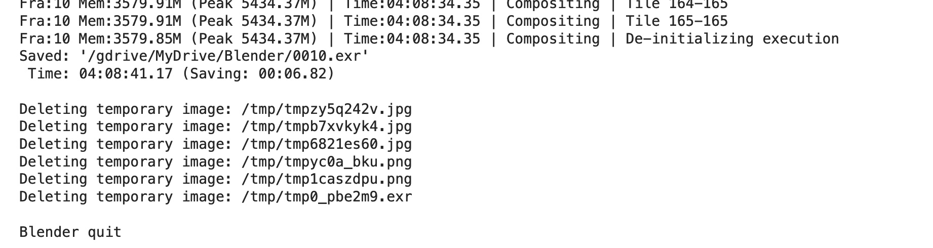

Maybe the fact I'm doing things on a small scale (1:1) could have something to do? I rendered with and without smoke to mix them latter,Smoke does make a huge memory difference,Was able to render in Colab the non-smoke version: But no avail with Smoke, couldn't even render with GPU mostly because my Linux boot started working weirdly after a CPU upgrade in my iMac (changed from i5 to i9 9900KF). In Mac and Colab it crashed, so rendered with Path CPU in Mac (a few tries in Linux saw memory usage going to around 70GBs):
