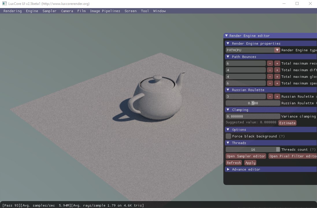

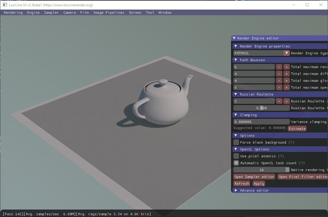

In addition to the last dark render with bump texture on LuxCore 2.4 and up. I keep seeing the same pattern with geometries even with no texture at all. low poly and high poly.
This is happening only with openCL.

The same scene with CPU render and GPU render.

It is a numerical precision problem, the size of your scene is HUGE, it is about 200m large.
You can fix the problem by using a realistic size or changing the default epsilon for something appropriate for you scene size:
scene.epsilon.min = 0.01
scene.epsilon.max = 0.1
The default epsilon values in LuxCore are appropriate for rendering something like a room (i.e. something 4m large). You need to increase the espilon for a lot larger scenes or reduce for a lot smaller.
