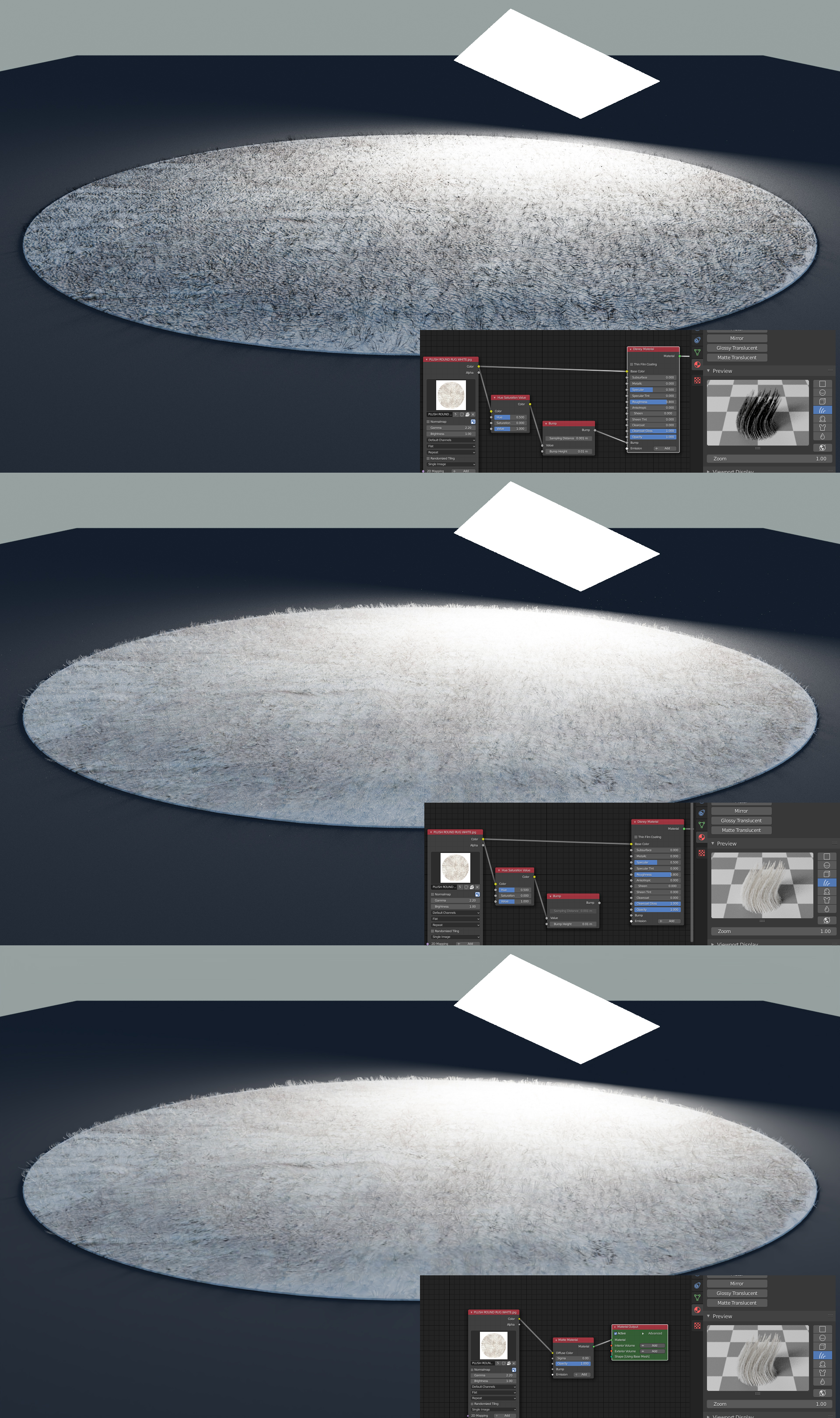

Hi guys!
I´m trying to make "fur" for a rug. In Cycles, it´s possible to use the material of the emitter, in the hair. I noted that this is possible in Lux, too, but hair keep rendering in black color. How can I fix it?
I´m using Lux 2.5 Beta1

Sorry. Here´s the file.
testRug.blend
(2 MiB) Downloaded 306 times
Thanks.

Leandro Oliveira wrote: Thu Dec 10, 2020 12:53 pm I´m trying to make "fur" for a rug. In Cycles, it´s possible to use the material of the emitter, in the hair. I noted that this is possible in Lux, too, but hair keep rendering in black color. How can I fix it?
Man, it's all onto bump. Also in Cycles usually used second material, like Principle Hair (it's optimised for strands rendering). So If you want your carpet using bump create separate material for particle system.
