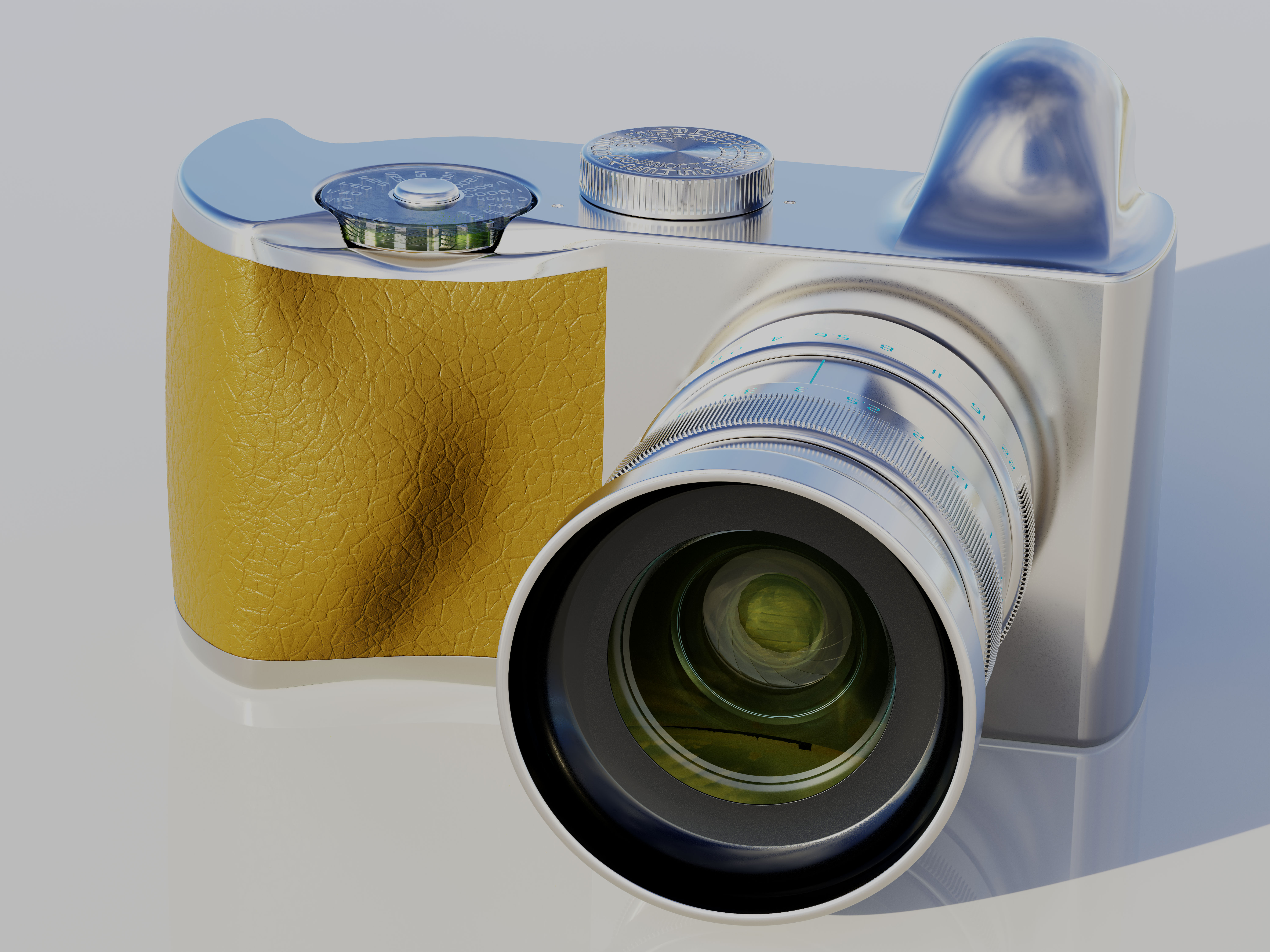

Very cool feature, thank you.
I tested this out on my camera scene:
