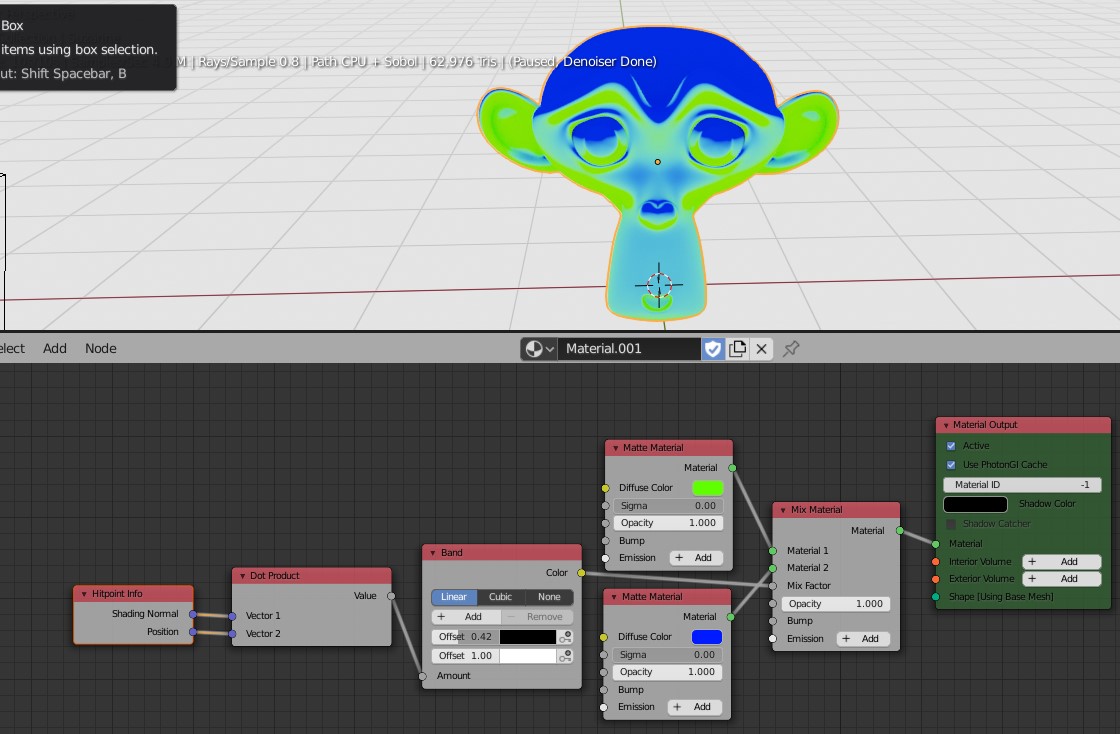

Is this how to create a type of falloff :?: (attached)
Thanks

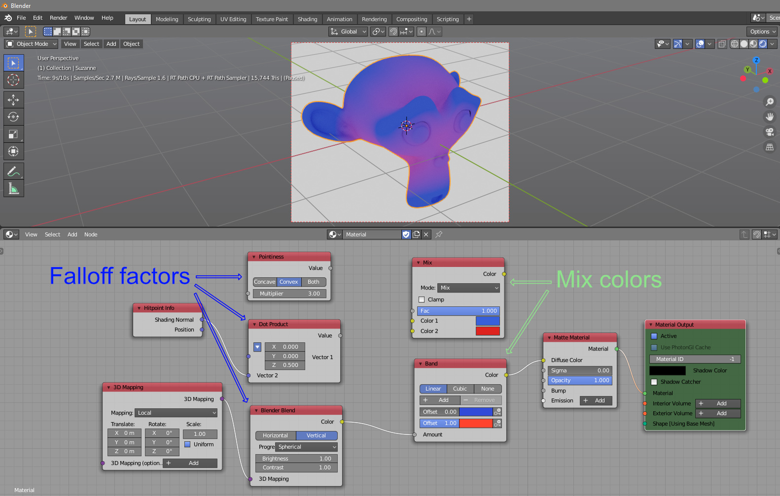

Also you can use a combination of these factors with the mix color or the band node.
falloff factors.blend
(577.51 KiB) Downloaded 321 times
(577.51 KiB) Downloaded 2 times
Many thanks. This info will be really helpful! :D

You should calculate dot product between (shading normal vector) and normalized(camera_position - shading position).
I hard-coded the position of a camera.
It would be great if we could get the camera position and calculate a normalized vector from nodes.

Hi SlowHand
I will create the setup and play around with it quite a bit to try and get an understanding of what the nodes are actually doing. I'm a bit out of my depth at the moment. :oops:
Many thanks :D
