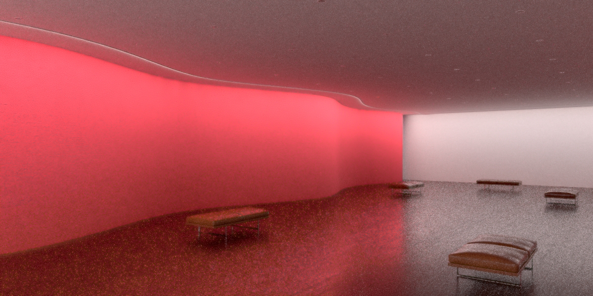

Ops, it is getting worst and worst for Maxwell.
Maxwell 60 seconds

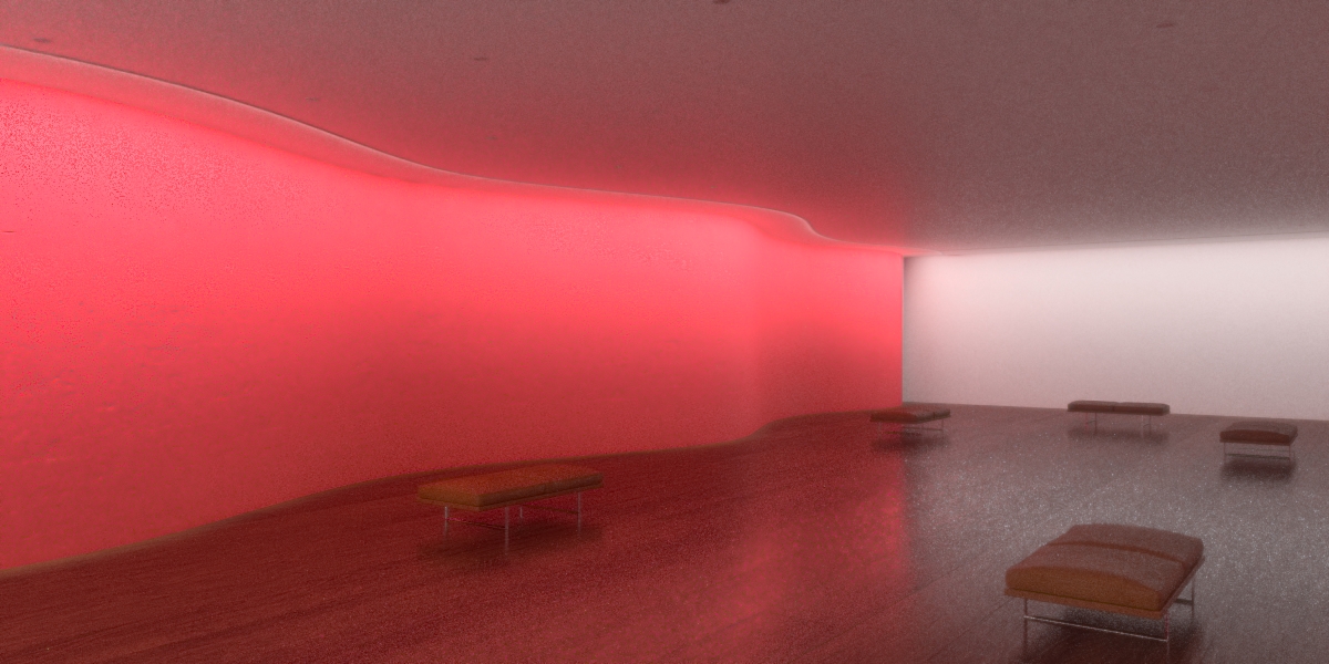

Luxcore 60 seconds

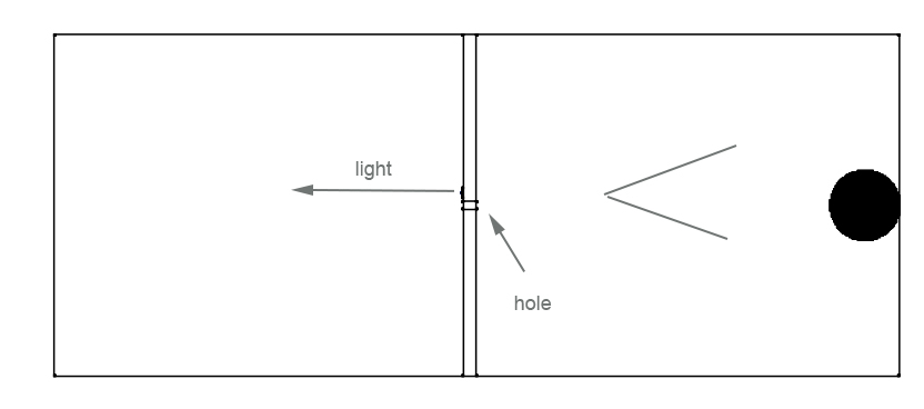

test set-up
Attached the scene file

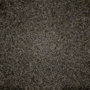

Sharlybg wrote: Sun Jul 11, 2021 7:13 pm Cycles
"Pitch black" ... or to use another movie tittle: "The Mist". Cycles (like Blender internal before) is really intended for toons animation, I have no idea why people use it for ArchiViz or Photorealism.

Most of the light in this scene is indirect light.
You can see how maxwell is faster in removing the overall noise. But there is a big cost in acccuracy compared to Luxcore.
Maxwell 2 minutes
Luxcore 2 minutes
Maxwell almost completely ignores reflecting surfaces illuminated by indirect light. Similarly, Maxwell is unable to reflect caustics in a mirror.
Suddenly a small tweak on the code in one of the most reputable rendering engines gives a completely wrong result.
If you are working in a project with these lighting conditions, which are quite common, you can go crazy if the rendering engine doesn't behave correctly and gives you dull images. What would Corona do with a scene like this? What about Cycles?

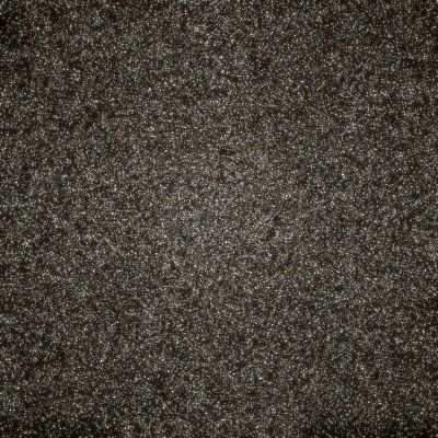

Dade wrote: Sat Jul 10, 2021 11:00 am This is a rendering with intentionally fast RR settings (6.12M samples/sec):
As you see I can manipolate the samples/sec however I want. But check the "rays per samples": the first one traces ~36 rays per samples while the last one only ~4 per samples. Clearly the last one is perceived 6 time "faster" ... but it isn't, it has just more noise and potentially fireflies.
I trust on you and your words but I can't match what you wrote with what my eyes is watching.
I mean that you wrote it has more noise and potentially fireflies but in your example it seems the reverse.
At least the noise is many many times lower and I really like the noise free reflection.
About the fireflies it seems lower as number but probably they could arise later when an higher sampling level will be reached...but as now we can clamp, it could be interesting to see if it's possible to avoid them just with clamping.

marcatore wrote: Mon Jul 12, 2021 12:01 pm I trust on you and your words but I can't match what you wrote with what my eyes is watching.
Are you mislead by the number of samples per pixel ? I took the screen shots at random points to show the difference in samples/sec and not in noise.
First was taken with 31 samples per pixel while the last was taken with 207 samples per pixel (clearly the last has less noise even with fast RR settings).
marcatore wrote: Mon Jul 12, 2021 12:01 pm About the fireflies it seems lower as number but probably they could arise later when an higher sampling level will be reached...but as now we can clamp, it could be interesting to see if it's possible to avoid them just with clamping.
Yes, like I wrote before, now with clamping and denoiser it may be worth having more aggressive RR settings.
