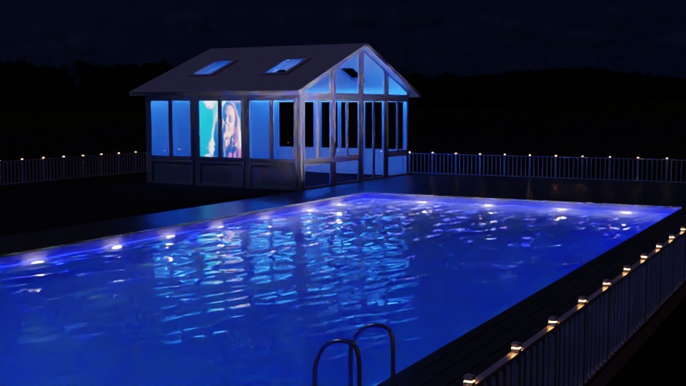

I have tried to adapt your parameters to my scene and this is what I got in night time.
I'm not sure whether these are caustics...
Still in progress but I don't know what else to do with the lights in order to get caustics.
The idea is to achieve an awesome water.
Best regards.
Re: Problems for getting the caustics in a pool
You have a quite peculiar setup there: the light sources are under water. Tomorrow, I will check the scene you posted, is it the one shown in your renderings ?
