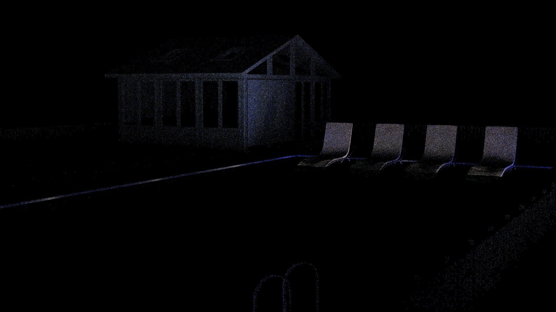

I have tried to adapt your parameters to my scene and this is what I got in night time.
I'm not sure whether these are caustics...
Still in progress but I don't know what else to do with the lights in order to get caustics.
The idea is to achieve an awesome water.
Best regards.
Best regards.

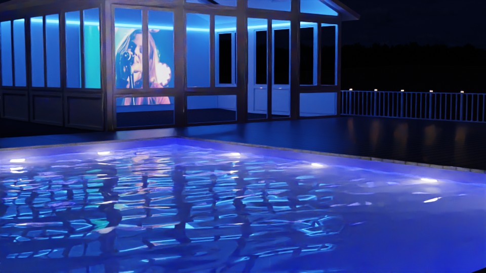

And this is a day time render changing the lightgroup configuration...
I can't distinguish whether they are caustics...Are them?
Is it possible that the OIDN denoiser blurred the caustics?
It's the first time I do that so I'm not an expert.

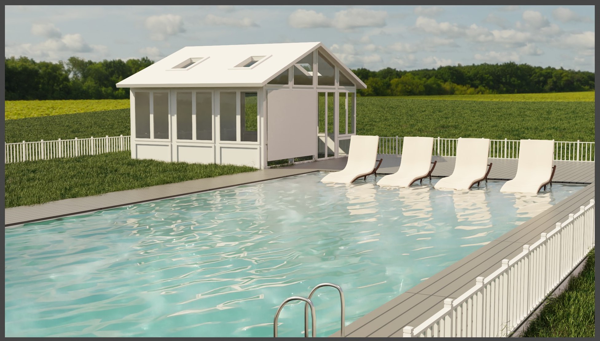

It looks a bit blurred, you can use the Caustic AOV to isolate and check the caustic output alone.
Keep in mind that caustics are the result of a direct, intense and sharp light source and they are typically more visible indoor. So both your day and night renderings may simple lack the conditions for visible/dramatic caustics.
Re: Problems for getting the caustics in a pool
Hello.
But this example is not indoor and it's illuminated thanks to a HDRi light source.
The only difference respect mine is the height of the doors in which is contained the water and the pool.
Thanks for your comment.

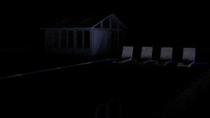

This is a capture of the caustic pass...As you can see there are no caustic created:
