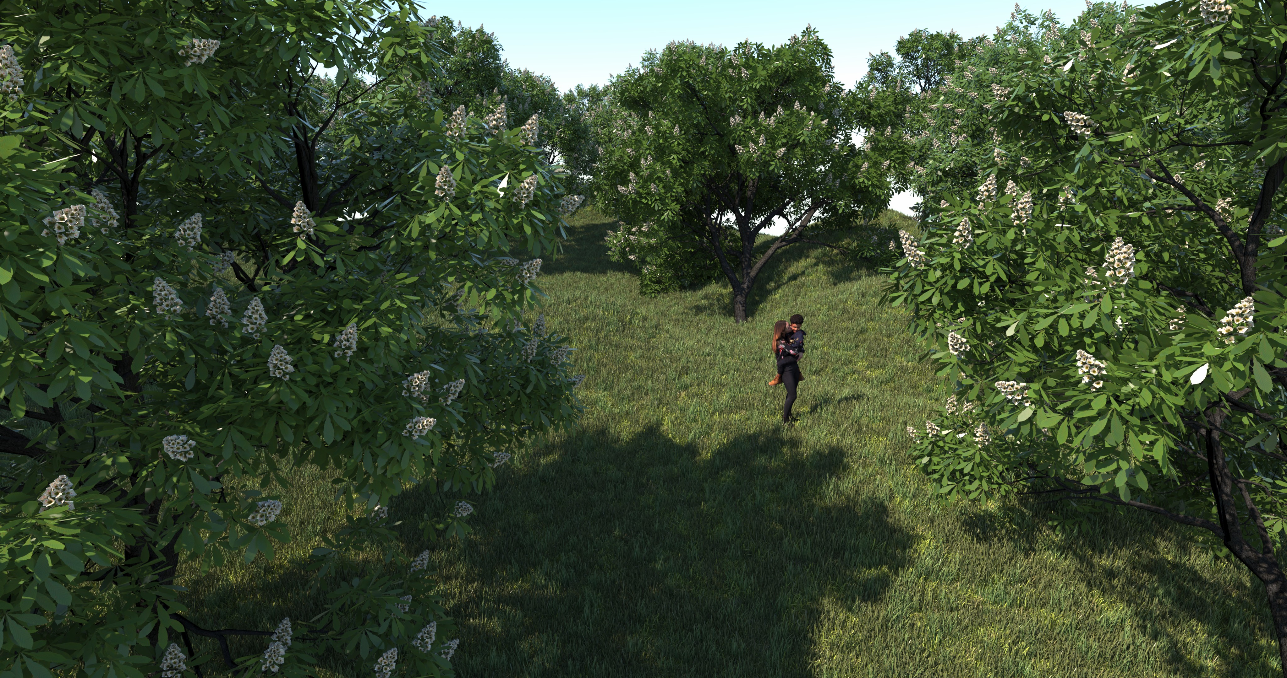

LuxCoreRender v2.4. Deep FX Studio for scattering and instancing. Objects sourced from third parties.
Walk in the park
Re: Walk in the park
Good looking render, for leaves you need to add translucent material or any equivalent material that supports translucency.
That will make your trees more realistic.
On my way home I take a photo that may help you.
If you look closely you will see the varsity or color for leaves. the younger leaves are brighter because, and it's usually happening on the tip of branches.
take a look.
Thanks for the reference. Noted, I will attempt to emulate the variation in a future piece. I was mainly interested in instancing in this case, and how easily LuxCoreRender handles lots of data. I can get into the billions, it's very fast, but the initial stage seems slow since it's single threaded. I'm assuming LuxCoreRender is building some sort of optimization structures. I will ask if it is possible to make that step multi threaded.
