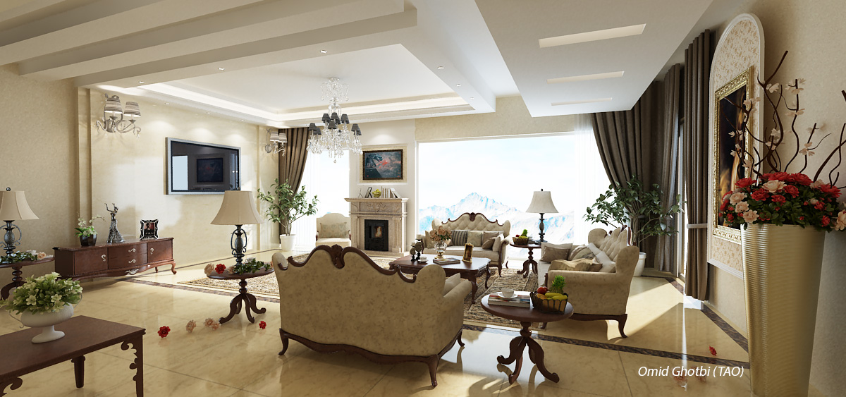

I am very proud to announce the Very first MaxToLux beta release (3dsmax internally renderer for LuxCoreRendere).
Huge improvements, compatibility, and bug fixes.
final render with a little color correction in photoshop.
Base on an old scene that I created with Vray and now completely moved it to MaxToLux.
Sample scene Base on Danish Mood Scene Sample scene Available on GitHub https://github.com/LuxCoreRender/MaxToL ... mpleScenes
