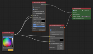

Which parameters of the Glossy Translucent shader and/or Homogeneous Volume node should I adjust? Here's my SSS shader node setup for the soft yellow parts (scene is modeled in the correct scale for a large pumpkin):
Any advice will be much appreciated, thanks in advance.

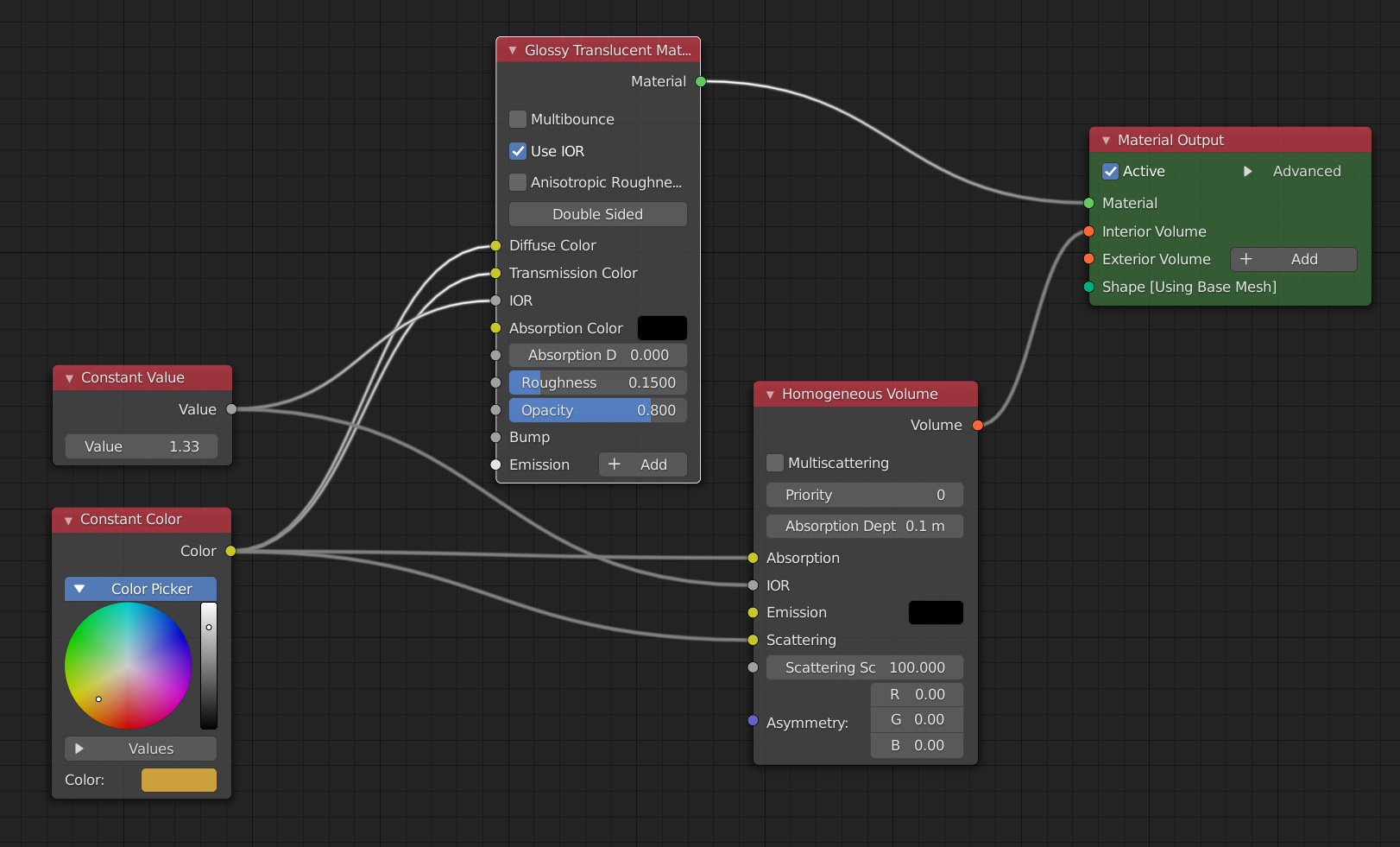

New node setup for the soft yellow parts:

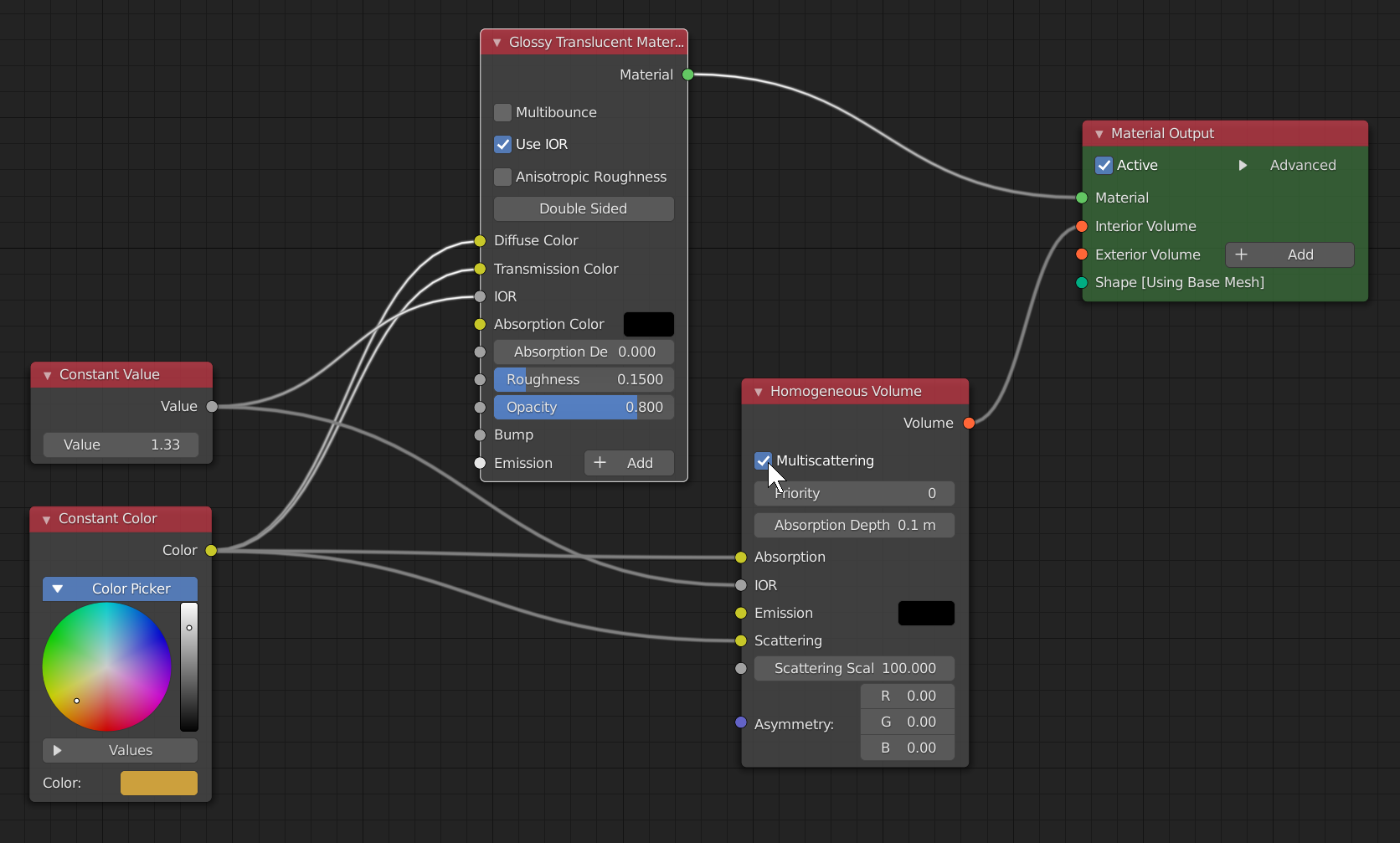

Another slight improvement. Turned on Multiscattering in the new node setup.
New rendering:
Node setup for the soft yellow material:

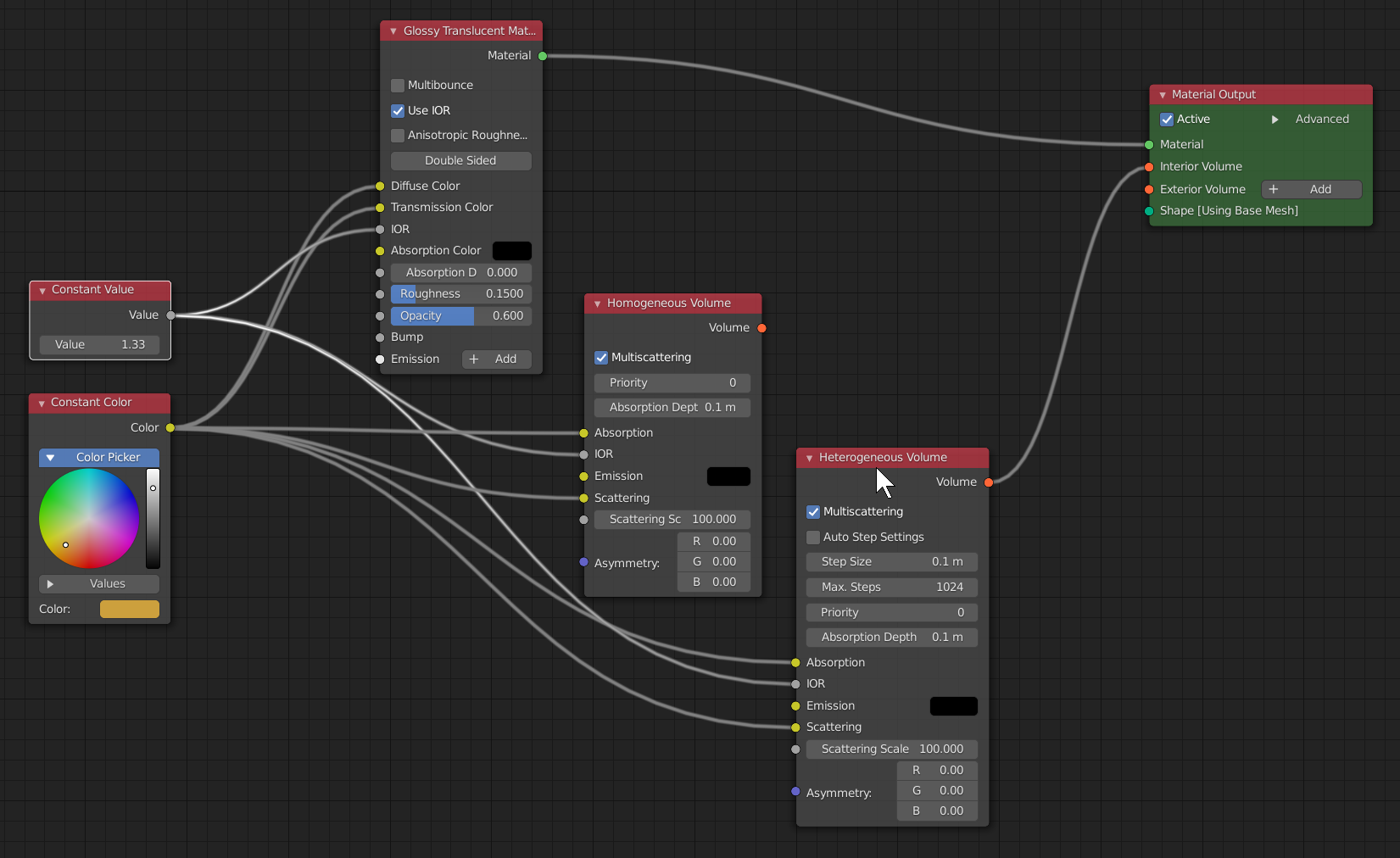

Slightly closer again, using a Heterogeneous Volume now, and turned down Glossy Translucent material transparency a bit further...
Nodes:

MetinSeven wrote: Tue Nov 03, 2020 9:15 am Slightly closer again, using a Heterogeneous Volume now, and turned down Glossy Translucent material transparency a bit further...
Some notes about your last setup:
  • You might want to leave the transmission color of the glossy translucent material white. Then you can control the color inside the volume solely via the absorption color.
  • On the same topic, you might want to leave the scattering color of the volume white, so only the absorption color influences the color.
  • Only use a heterogeneous volume if you need to texture volumetric properties with a spatially varying texture. If the properties are constant over the whole volume, it is better to use a homogeneous volume since it has much better performance.
  • Because the glossytranslucent material does not refract light rays, the volume IOR does not matter here. It only really matters in combination with a glass material.
