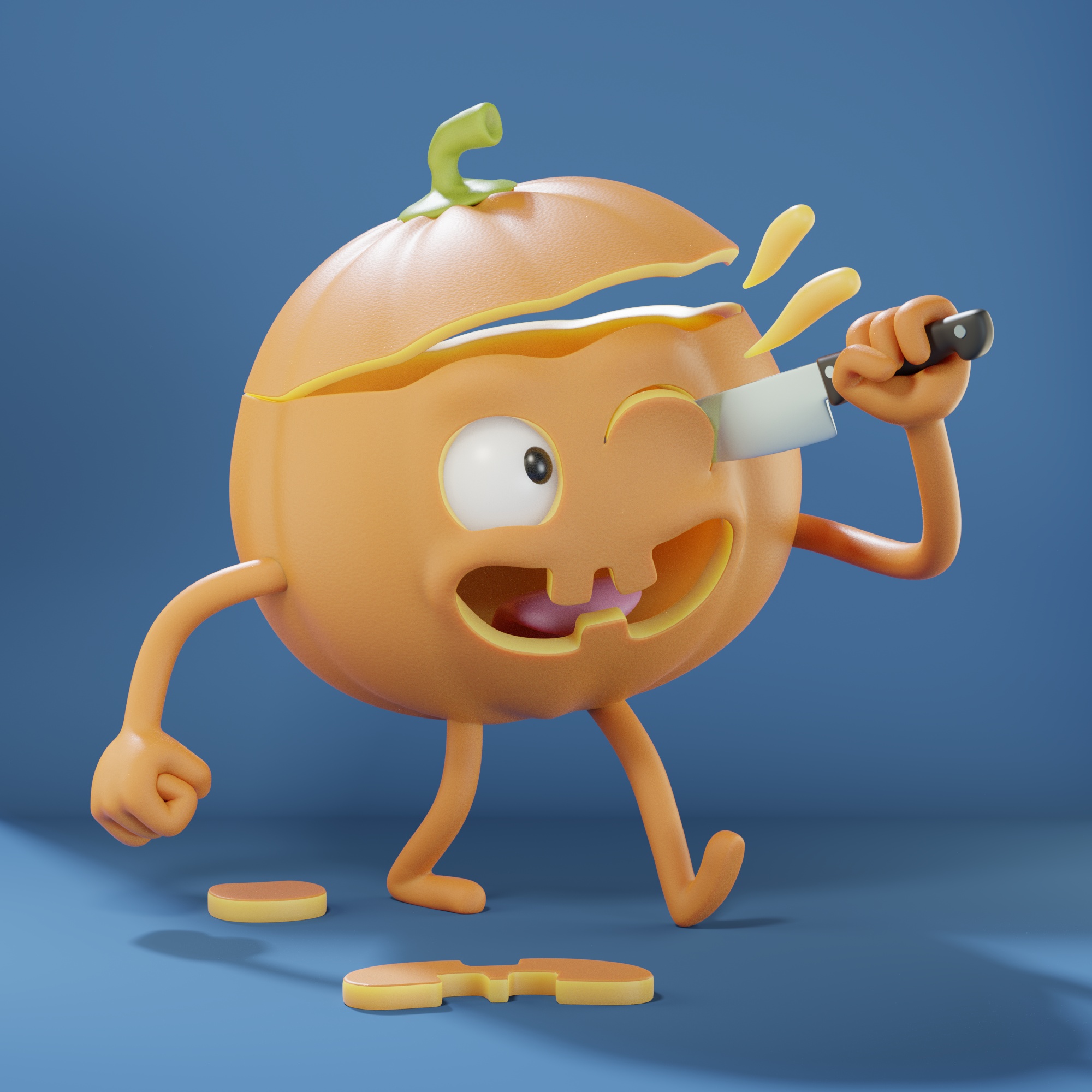

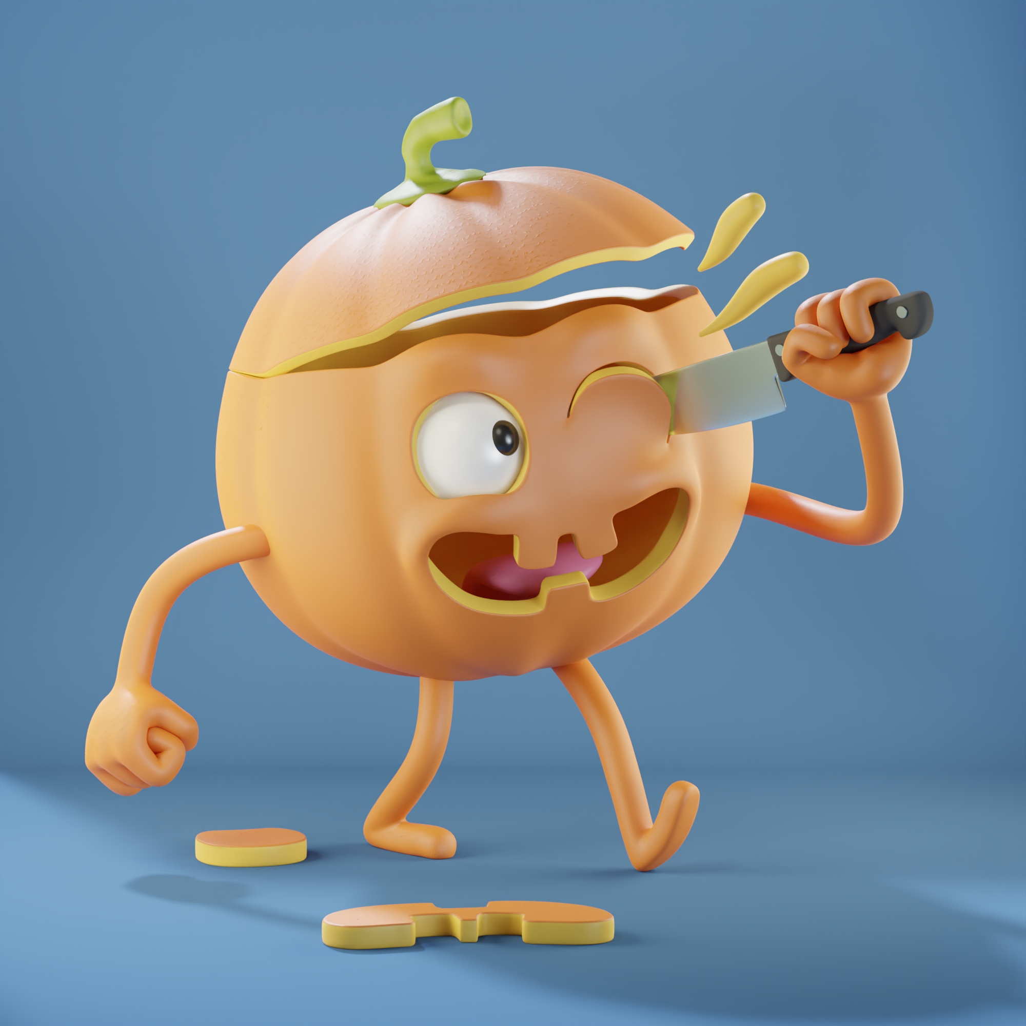

I've rendered a scene using LuxCore and Cycles, and although I like LuxCore's shaders, lighting and shadows better, to me Cycles wins in the SSS area.
I used Random Walk SSS in Cycles, which is the same algorithm as LuxCore uses, unless I'm mistaking.
LuxCoreRender version: Cycles version: I find it hard to achieve the same visible SSS light falloff in LuxCore as is present in the Cycles rendering (the gradual, glowy light transitions in the yellow, soft parts of the pumpkin).

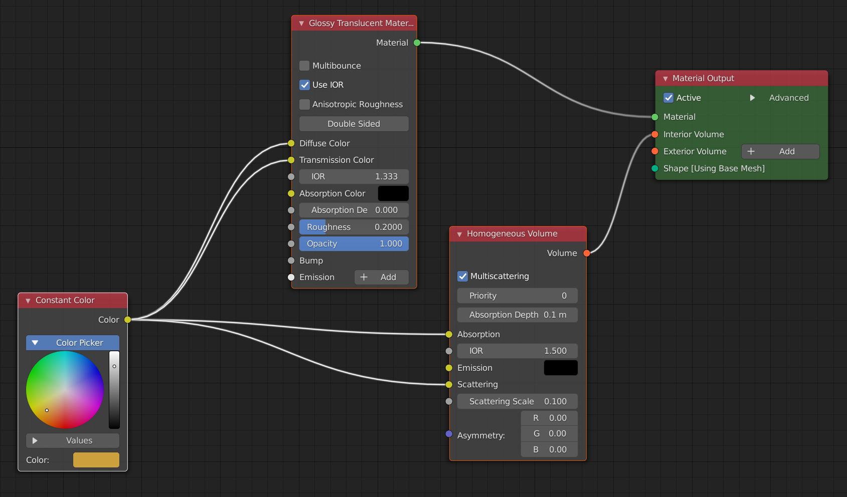

Which parameters of the Glossy Translucent shader and/or Homogeneous Volume node should I adjust? Here's my SSS shader node setup for the soft yellow parts (scene is modeled in the correct scale for a large pumpkin): Any advice will be much appreciated, thanks in advance.

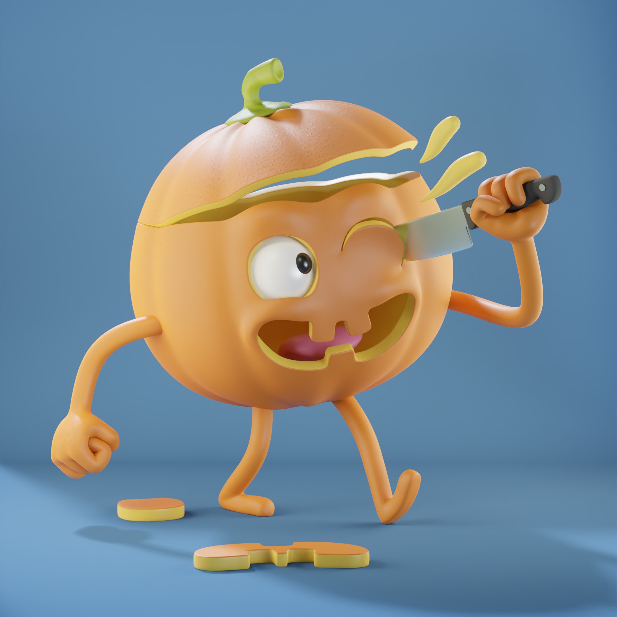

Experimented some more.
I managed to get a bit more visible SSS light falloff inside the pumpkin, but still not the glowy liquid SSS of Cycles.
New Luxcore rendering: New node setup for the soft yellow parts:

Another slight improvement. Turned on Multiscattering in the new node setup.
New rendering: Node setup for the soft yellow material:

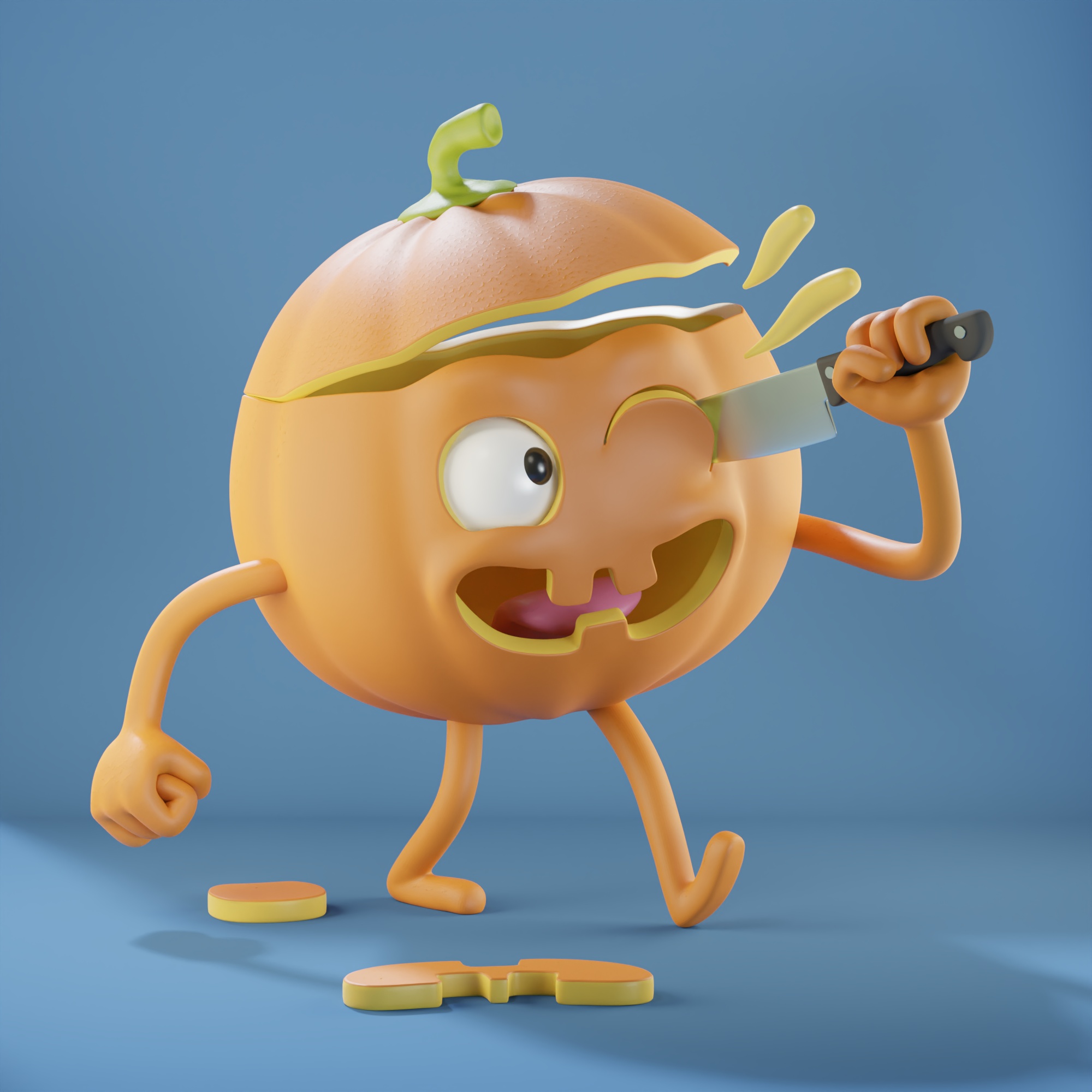

Slightly closer again, using a Heterogeneous Volume now, and turned down Glossy Translucent material transparency a bit further...
Nodes:

Some notes about your last setup:MetinSeven wrote: Tue Nov 03, 2020 9:15 am Slightly closer again, using a Heterogeneous Volume now, and turned down Glossy Translucent material transparency a bit further...
- You might want to leave the transmission color of the glossy translucent material white. Then you can control the color inside the volume solely via the absorption color.
- On the same topic, you might want to leave the scattering color of the volume white, so only the absorption color influences the color.
- Only use a heterogeneous volume if you need to texture volumetric properties with a spatially varying texture. If the properties are constant over the whole volume, it is better to use a homogeneous volume since it has much better performance.
- Because the glossytranslucent material does not refract light rays, the volume IOR does not matter here. It only really matters in combination with a glass material.

OK, adjusted the light strength of both the HDRI environment as well as the direct lights to get more light energy going and match the Cycles scene more.
It looks a bit brighter now, but still not the nice light falloff inside the volumes.
