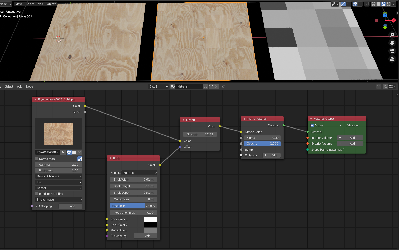

In LuxCore, the 2D/3D mapping can't be textured.
However, in Lux v2.5, there's a new "Distort" texture that can be used to at least texture the "transform" part of a texture mapping (but not rotation or scale).
It can be found in Add Node > Utils > Distort.

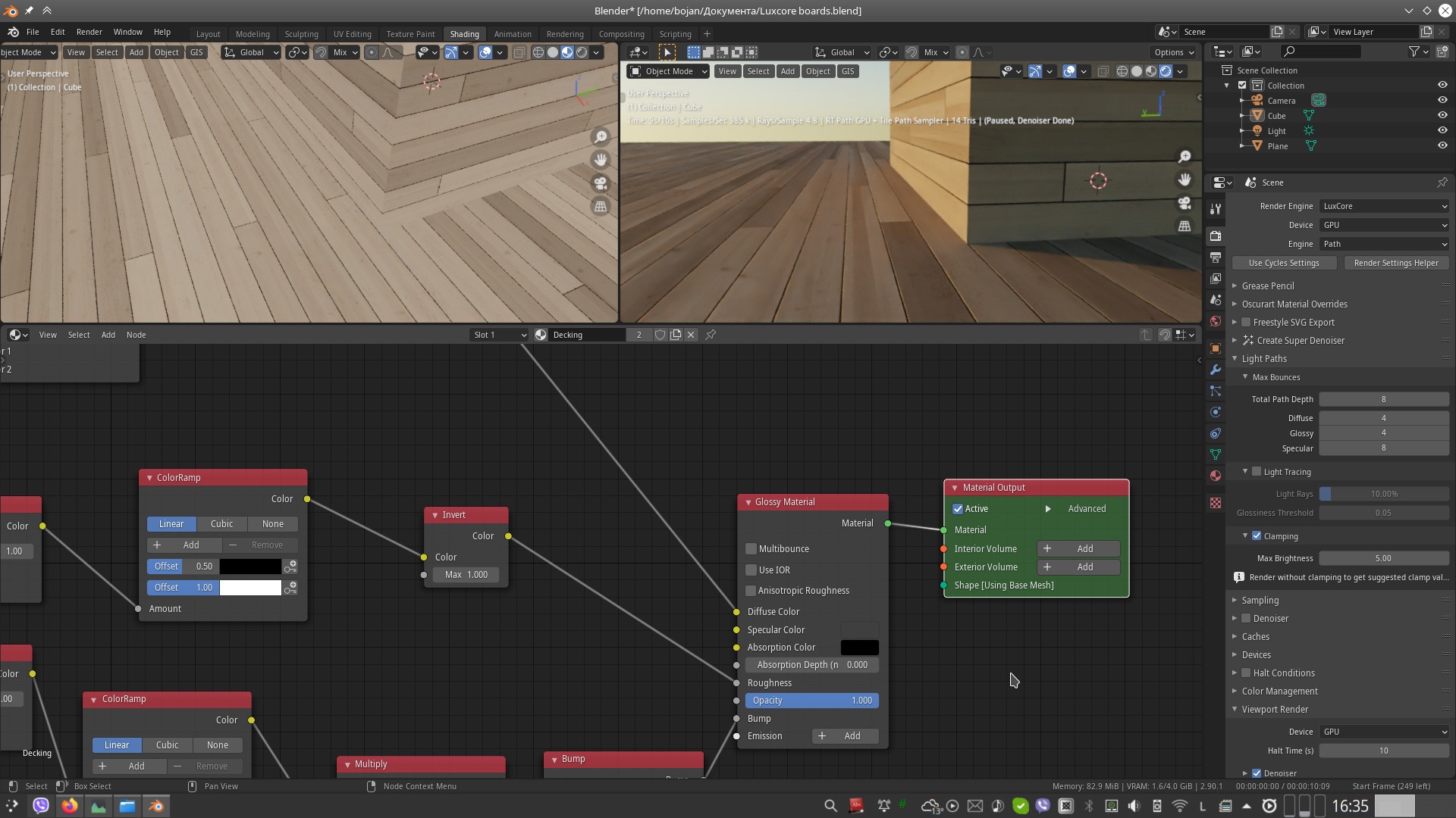

Thank you, that's exactly what I needed!
I managed to do a setup very similar to Cycles, and even a bit better in some respect, since the Luxcore's brick tex is more advanced then Cycles one.
Maybe someone else finds it useful.
