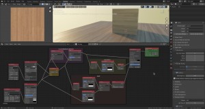

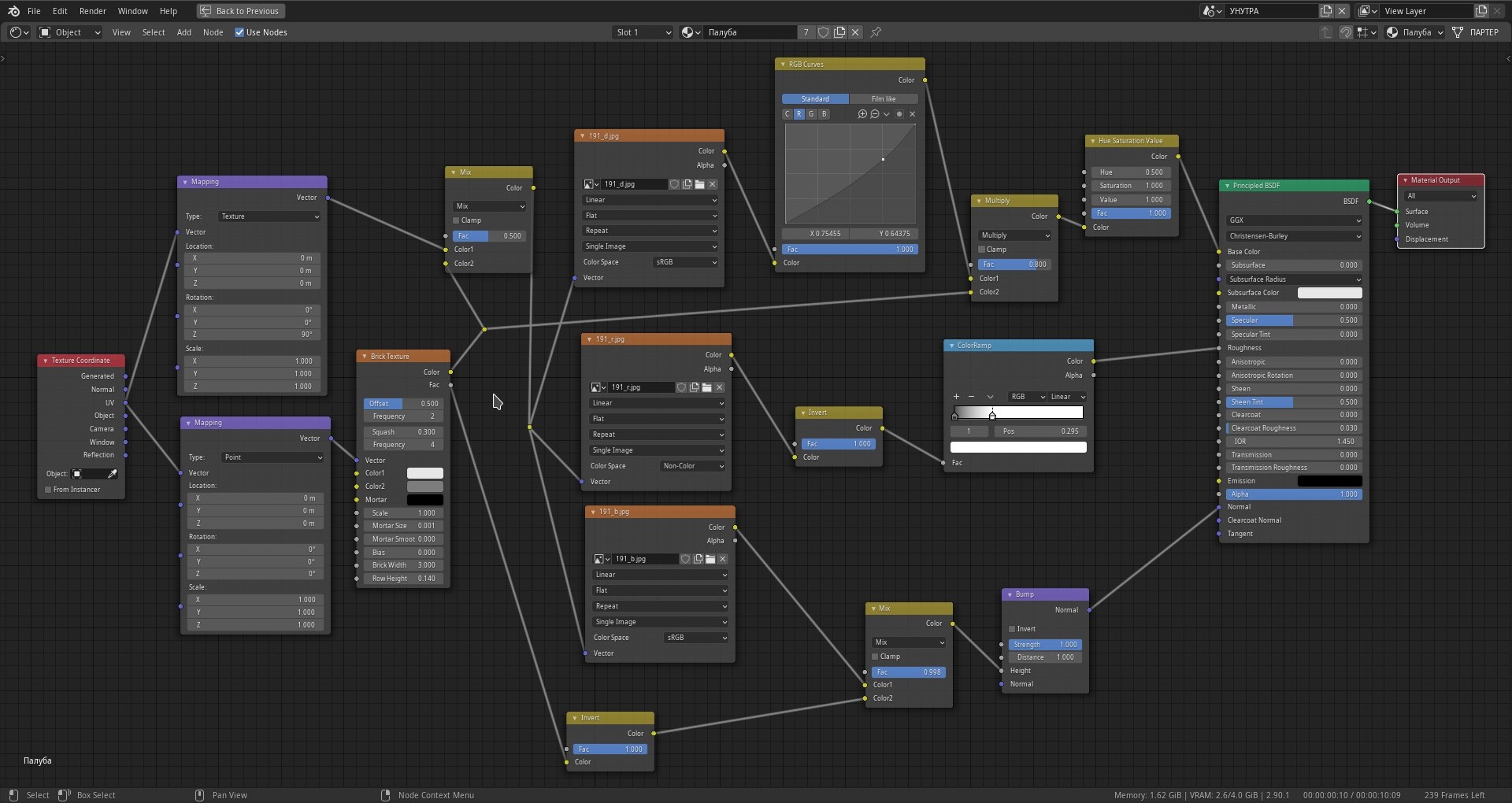

Working on Archviz in Cycles, there's a super useful way to do semi procedural material for decking and similar stuff. It uses the brick texture to offset UV's of diffuse, roughness and bump maps, drive the color and roughness variations by color multiplying those maps, and of course, bump.
Material nodes
Material nodes
Material previews
Material previews

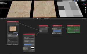

Thank you, that's exactly what I needed!
I managed to do a setup very similar to Cycles, and even a bit better in some respect, since the Luxcore's brick tex is more advanced then Cycles one.
The attachment Decking mat lux nodes.jpeg is no longer available
Maybe someone else finds it useful.

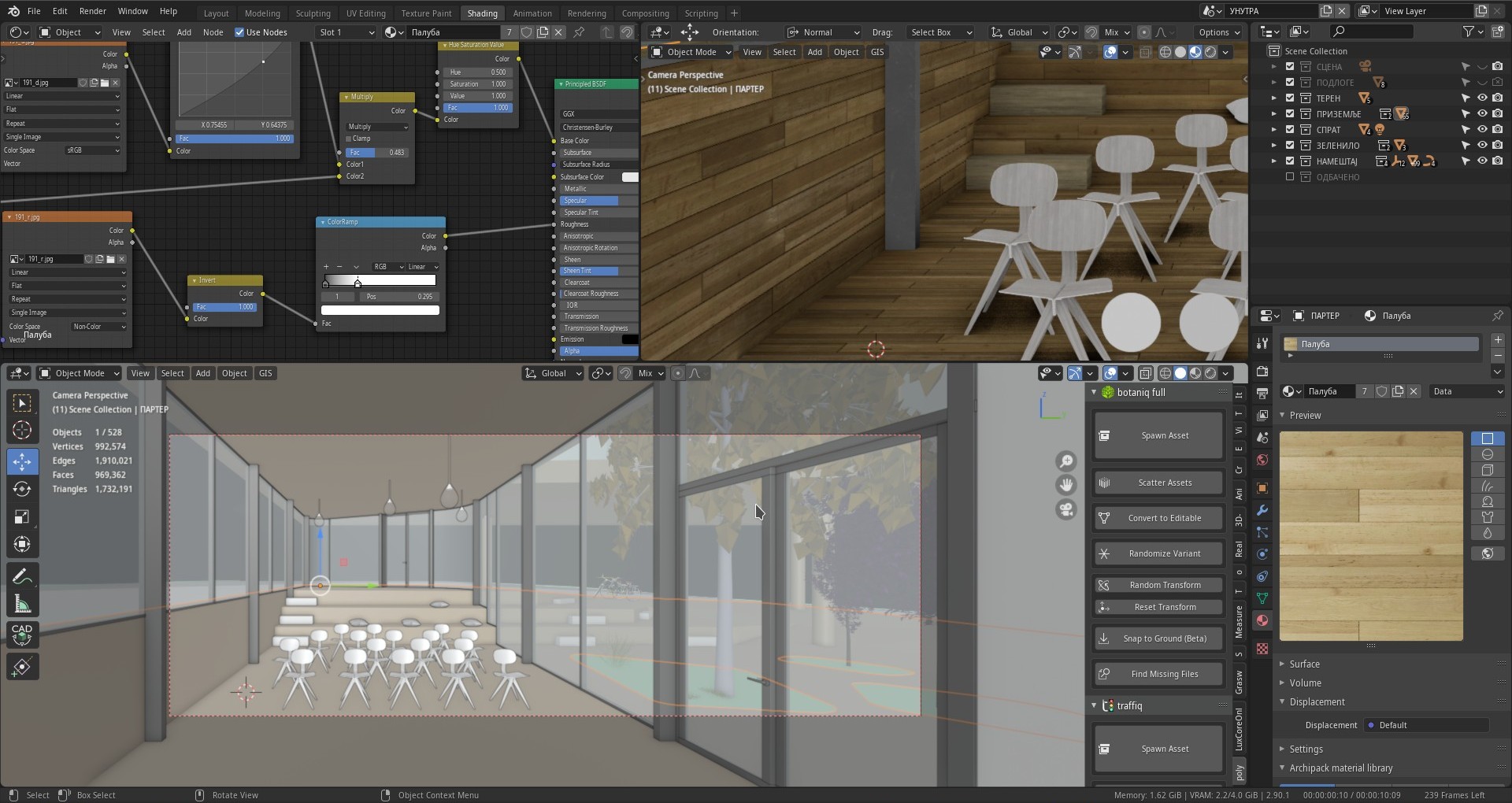

There's also this old PBR trick that makes the material simpler and lighter:
Luxcore boards.blend
(2.74 MiB) Downloaded 1271 times
