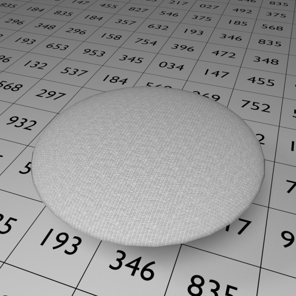

I fixed a problem in OpenCL code and now the output is the same. Can you check if this has solved the "seams" problem too, it working fine here:
Oh, fantastic. I will get back to this once build is ready and on dailies.
Can we test this already in the blender addon?
Yes, in latest daily, with Add Node > Mapping > Triplanar.
Awesome, thanks!
