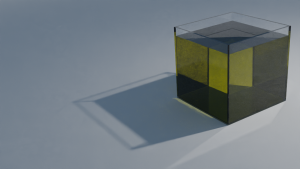

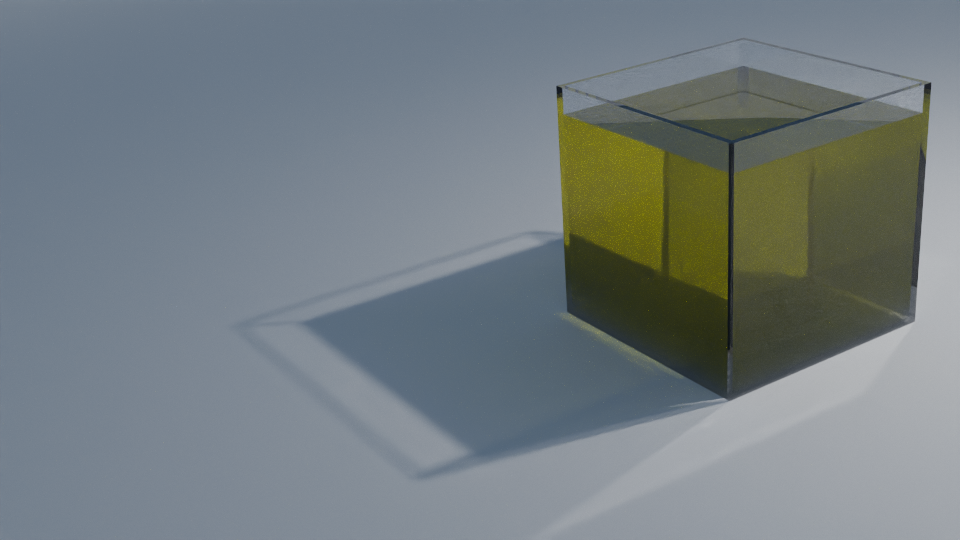

Posted: Thu Oct 16, 2025 6:42 pm
by FarbigeWelt

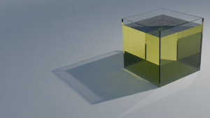

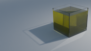

I've tested different settings for a simple glass cube box filled with a yellow liquid.
First tests are material settings without volume.
I've encountered an issue with GPU rendering.
GeForce RTX 2080 Super renders only about 5% faster than Radeon RX 5700 XT (see LuxMark 3.1)
But here the combination CPU/Radeon renders much slower than CPU/GeForce.
If Light Tracing is enabled in combination with GPU RX 5700 XT the CPU AMD 5950X renders with the same speed as CPU only.
Compare AMD with aRX/AMD times for 0.5 HD renders in the lists below.
AMD: AMD Ryzen 9 5950X 16 cores, 32 threads
aRX: AMD Radeon RX 5700 XT
nRTX: NVIDIA RTX 2080 Super
CPU: Apple M1 16 GB
GPU: Apple M1 16 GB
Glass Cube, no Volumes
Glass, sharp edges
Liquid, cube, sharp edges
Path-, Light Traycing Sobol
CPU, 128 samples, 2:38
AMD, 134 samples, 00:33
GPU/CPU, 128 Samples, 1:42
aRX/AMD, 134 Samples, 00:25
nRTX/AMD, 135 Samples, 00:15
aRX,nRTX/AMD, 152 Samples, 00:11
BiDir Metropolis
CPU, 128 Samples, 1:33
AMD, 131 Samples, d12, 00:23
CPU_BiDir MLT
CPU_BiDir MLT
CPU_Path, Light Tracing
CPU/GPU AMD, NVIDIA
CPU/GPU AMD, NVIDIA
CPU/GPU AMD
CPU/GPU AMD
CPU/GPU NVIDIA
CPU/GPU NVIDIA

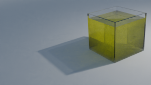

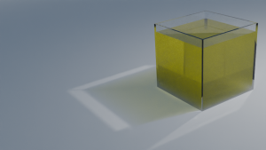

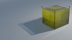

Glass Cube, Volumes clear
Posted: Thu Oct 16, 2025 6:51 pm
by FarbigeWelt
Air, prio 0, clear
Glass, sharp edges, clear
Liquid, cube, sharp edges, clear
CPU, 128 Samples, 2:38
AMD, 131 Samples, 00:29
GPU/CPU, 128 Samples, 2:08
aRX/AMD, 130 Samples, 00:31
nRTX/AMD, 138 Samples, 00:16
aRX,nRTX/AMD, 128 Samples, 00:11
BiDir Metropolis
CPU, 128 Samples, 1:41
AMD, 128 Samples, d12, 00:25
CPU_BiDir, MLT
CPU_BiDir, MLT
CPU_PLT, Sobol
CPU_PLT, Sobol
CPU/aRX_PLT, Sobol
CPU/aRX_PLT, Sobol
CPU/nRTX_PLT, Sobol
CPU/nRTX_PLT, Sobol
CPU/aRX,nRTX_PLT, Sobol

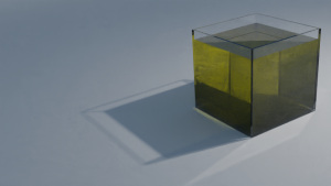

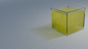

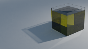

Glass Cube, Volumes homo, Shadows 0
Posted: Thu Oct 16, 2025 6:55 pm
by FarbigeWelt
Air, prio 0, clear
Liquid, cube, sharp edges, homo
AMD, 134 Samples, 00:34
GPU/CPU, 128 Samples, 2:29
aRX/AMD, 131 Samples, 00:32
nRTX/AMD, 141 Samples, 00:17
aRX,nRTX/AMD, 144 Samples, 00:12
BiDir Metropolis
CPU, 128 Samples, 1:40
AMD, 129 Samples, d12, 00:24
CPU_PLT, Sobol
CPU_PLT, Sobol
CPU_BiDir, MLT
CPU_BiDir, MLT
CPU/aRX_PLT, Sobol
CPU/aRX_PLT, Sobol
CPU/nRTX_PLT, Sobol
CPU/nRTX_PLT, Sobol

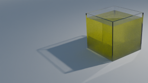

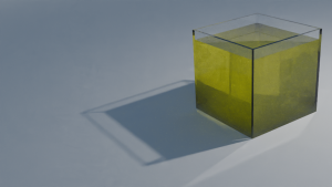

Glass Cube, Volumes homo, Shadows 1
Posted: Thu Oct 16, 2025 7:03 pm
by FarbigeWelt
Air, prio 0, clear
Glass, sharp edges, clear, shadow 1
Liquid, cube, sharp edges, homo, shadow 1
CPU, 128 Samples, 2:19
AMD, 128 Samples, 00:32
aRX/AMD, 130 Samples, 00:33
aRX,nRTX/AMD, 141 Samples, 00:13
BiDir Metropolis
CPU, 128 Samples, 1:51
AMD, 129 Samples, d12, 00:26
CPU_PLT, Sobol
CPU_PLT, Sobol
CPU_BiDir, MLT
CPU_BiDir, MLT
CPU/aRX_PLT, Sobol
CPU/aRX_PLT, Sobol
CPU/nRTX_PLT, Sobol
CPU/nRTX_PLT, Sobol

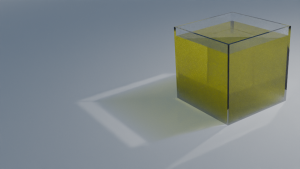

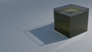

Glass Cube, Volumes homo, Shadows 0.5
Posted: Thu Oct 16, 2025 7:09 pm
by FarbigeWelt
Air, prio 0, clear
Glass, sharp edges, clear, shadow 0.5
Liquid, cube, sharp edges, homo, shadow 0.5
CPU, 128 Samples,
AMD, 133 Samples, 00:30 (no light T: 00:14)
aRX/AMD, 131 Samples, 00:32 (no light T: 00:12)
nRTX/AMD, 135 Samples, 00:16
aRX,nRTX/AMD, 135 Samples, 00:11
BiDir Metropolis
CPU, 128 Samples,
AMD, 131 Samples, d12, 00:26
CPU_PLT, Sobol
CPU_PLT, Sobol
CPU_BiDir, MLT
CPU_BiDir, MLT
CPU/aRX_PLT, Sobol
CPU/aRX_PLT, Sobol
CPU/nRTX_PLT, Sobol
CPU/nRTX_PLT, Sobol
CPU/nRTX,aRX_PLT, Sobol
