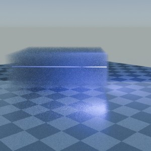

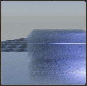

There is a gap in the Laser Beam rendering with BiDir, Metropolis.
Infos

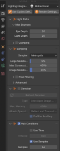

BiDir Settings
BiDir Settings

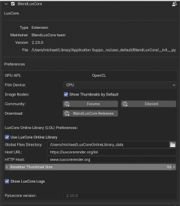

Info
Info

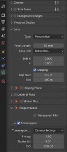

Camera Setting
Camera Setting
Pictures

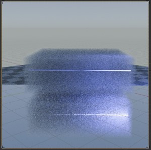

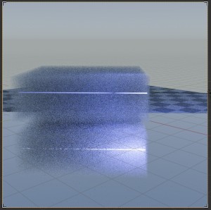

BiDir, cam x 7.94
BiDir, cam x 7.94
BiDir, cam x 10.00
BiDir, cam x 10.00
BiDir, cam x 11.88
BiDir, cam x 11.88

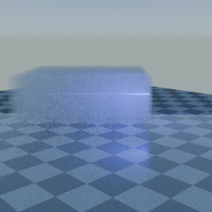

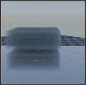

Rendering the same Scene with Path, Light Tracing doesn't show much of the scattering Beam.
Path, Light Tacing, cam x 11.88

I've encountered this too:

Additional Information
There is quite a difference enabling Multi Scattering for homogenous volumes.
BiDir Multi Scattering
BiDir Non Multi Scattering
