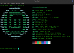

My Linux:
Linux Mint 21.2 in a AMD Ryzen 9 5900X
I am using 2 GPUs:
GPU: NVIDIA GeForce RTX 3060 Lite Hash Rate
GPU: NVIDIA 2d:00.0 NVIDIA Corporation Device 2786 (GeForce 4070 RTX)

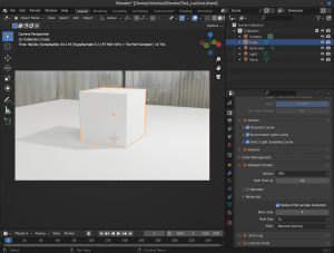

When I render in viewport in GPU mode, the render is correct. Please see picture GPU Render.png.

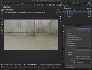

When I render in CPU mode, the geometry is not rendered. Please see picture CPU Render.png

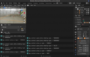

Here is the screenshot:
And here is the output in the console:
