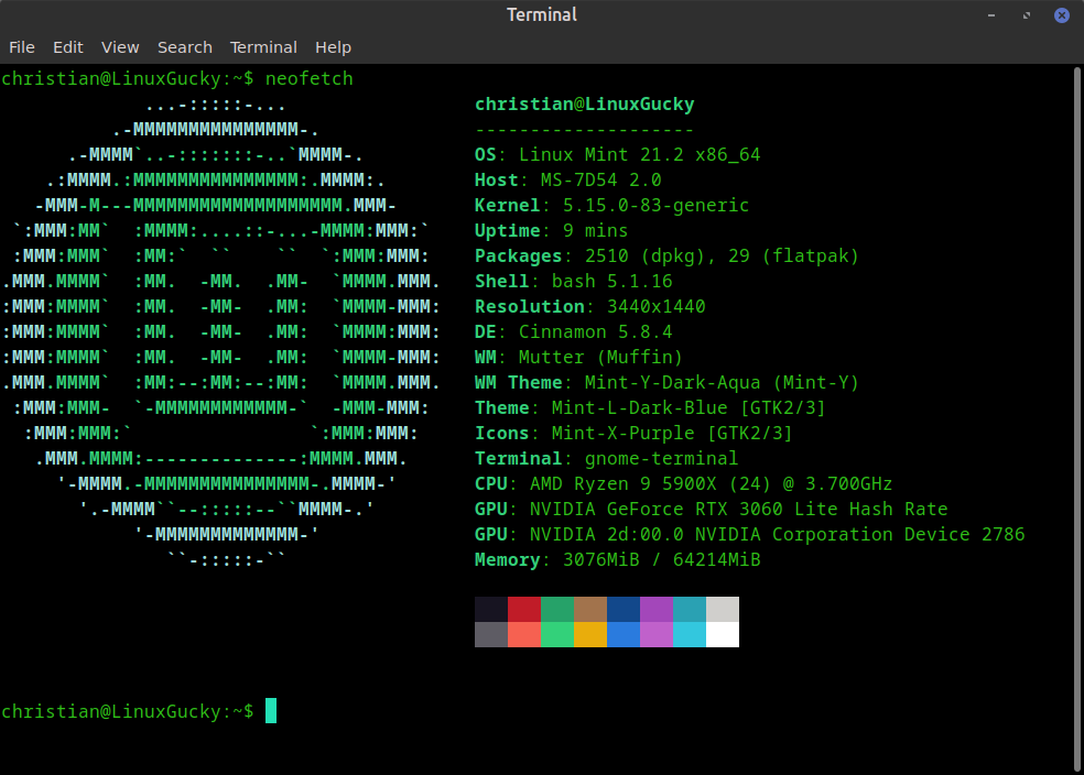

My Linux:
Linux Mint 21.2 in a AMD Ryzen 9 5900X
I am using 2 GPUs:
GPU: NVIDIA GeForce RTX 3060 Lite Hash Rate
GPU: NVIDIA 2d:00.0 NVIDIA Corporation Device 2786 (GeForce 4070 RTX)

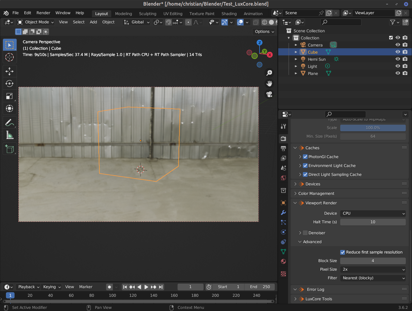

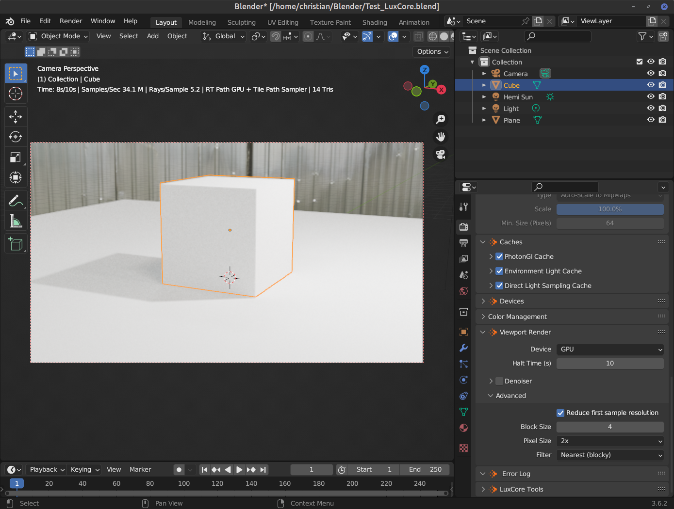

When I render in viewport in GPU mode, the render is correct. Please see picture GPU Render.png.
When I render in CPU mode, the geometry is not rendered. Please see picture CPU Render.png
Does anyone know what causes this issue?

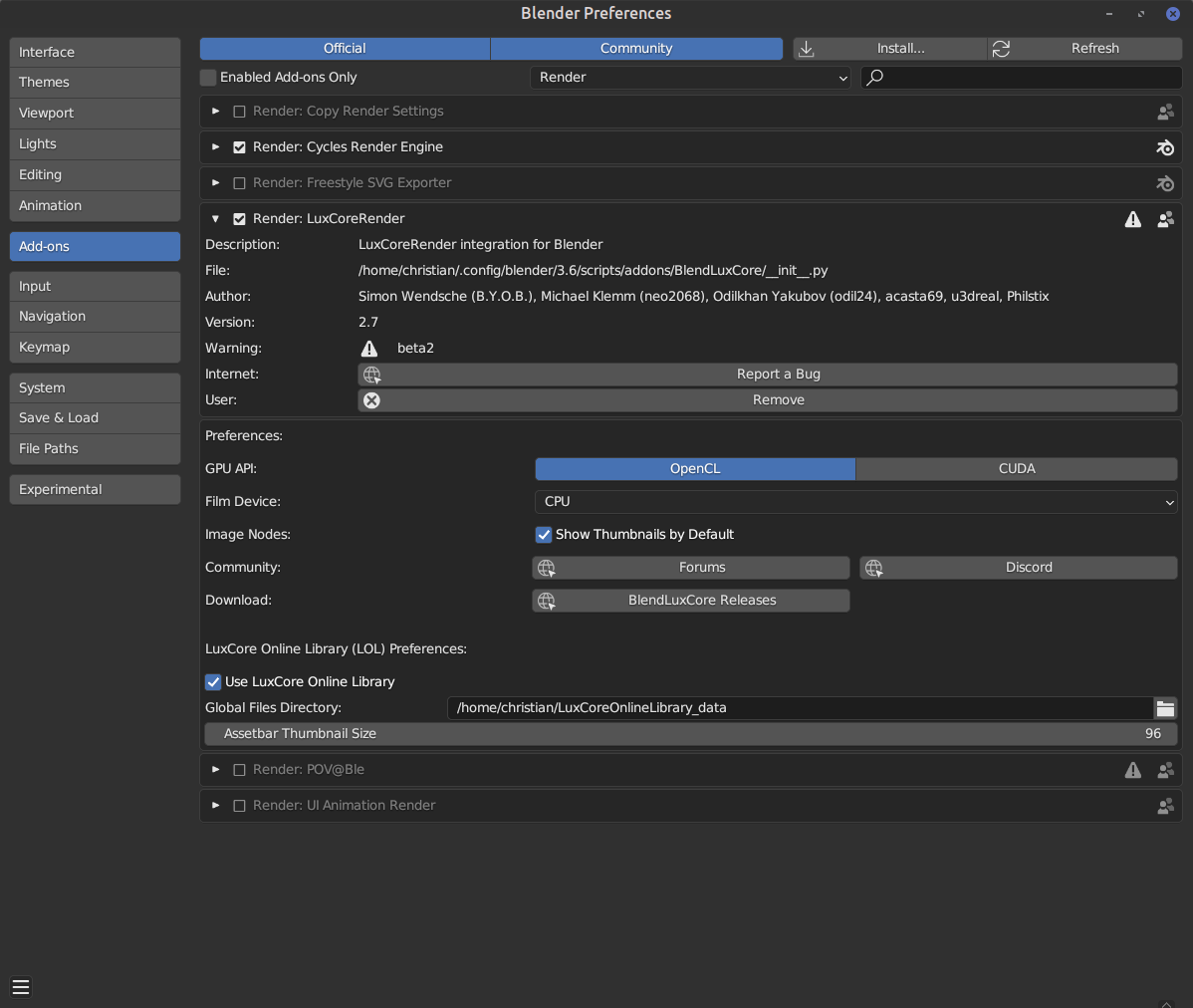

1. Can you make screen from User pref > LuxCore > Film device
2. Can you paste log from Blender console?
P.s.: also open an issue on bug tracker: https://github.com/LuxCoreRender/BlendLuxCore/issues
Re: Under Linux Mint 21.2 in CPU mode, Luxcore does not render geometrie
Here is the screenshot: And here is the output in the console:
