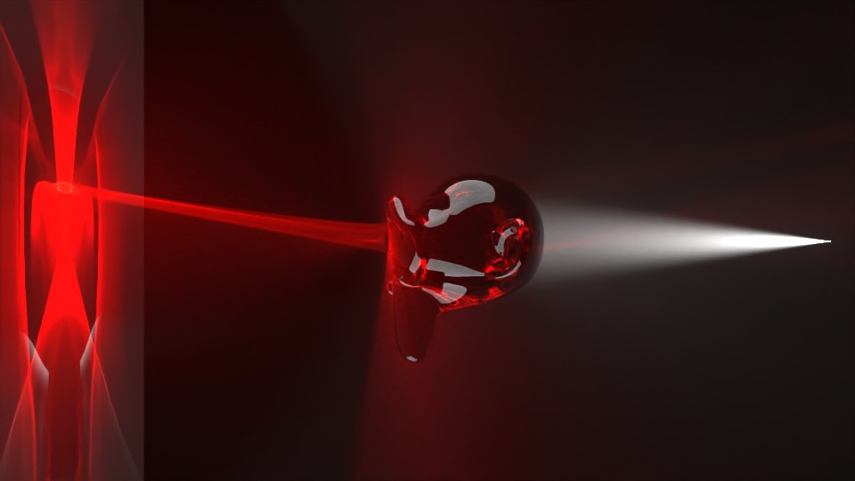

1__ Do it with bidir it will show path that are missed in PATHTracer+LightTracer.
2__ Create 2 volume one with air settings attached to your camera a second with homogenous fog attached to your spot light exterior volume
3__ Just added 2 area light to see the suzane head better.
4__ You can make the suzane head brighter by replacing the internal ""Clear volume"" by a ""Homogenous volume""
Like this:
