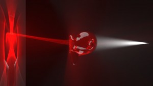

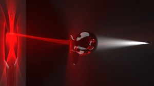

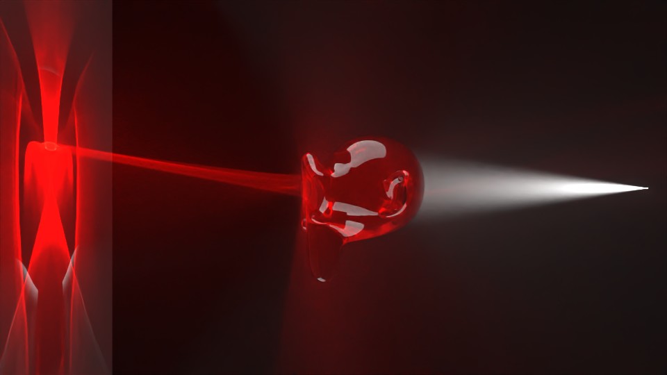

In brief the caustics path is weakened when the light is cast onto another surface. I wonder if there is a way to show off the caustics path and show the caustics on a surface at the same time.
Thanks in advance.
Light path is weakened with a caustics receiver
Light path looks great without a caustics receiver

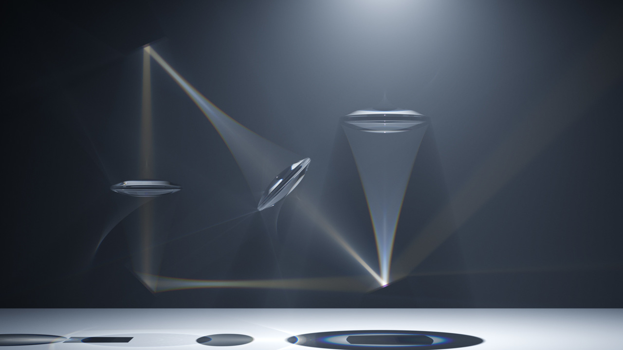

Something of a desired final result, image stolen from indigo

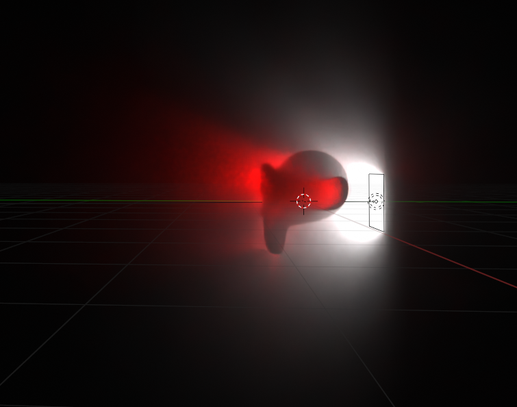

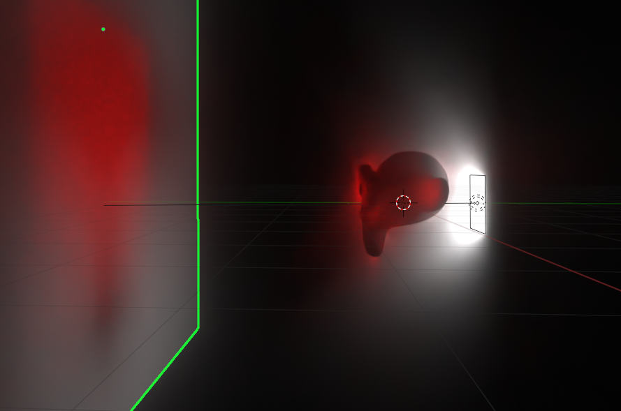

1__ Do it with bidir it will show path that are missed in PATHTracer+LightTracer.
2__ Create 2 volume one with air settings attached to your camera a second with homogenous fog attached to your spot light exterior volume
3__ Just added 2 area light to see the suzane head better.

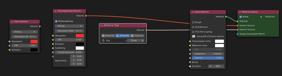

4__ You can make the suzane head brighter by replacing the internal ""Clear volume"" by a ""Homogenous volume""
Like this:
