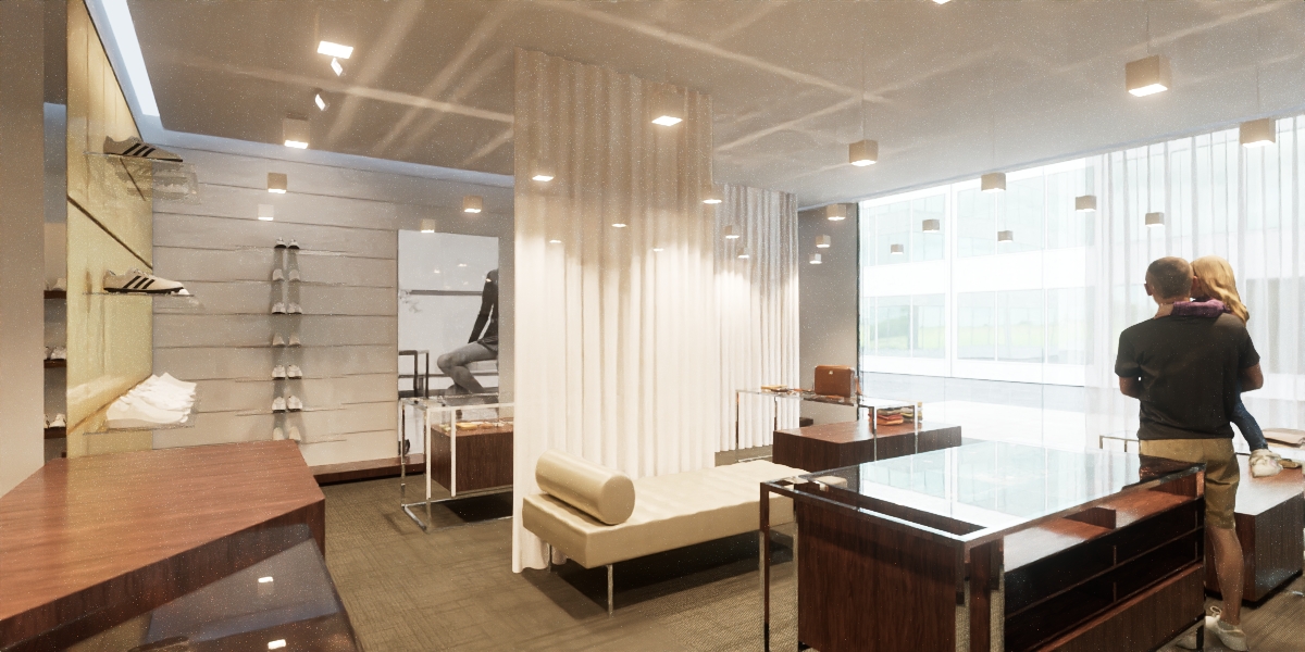

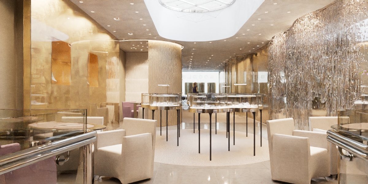

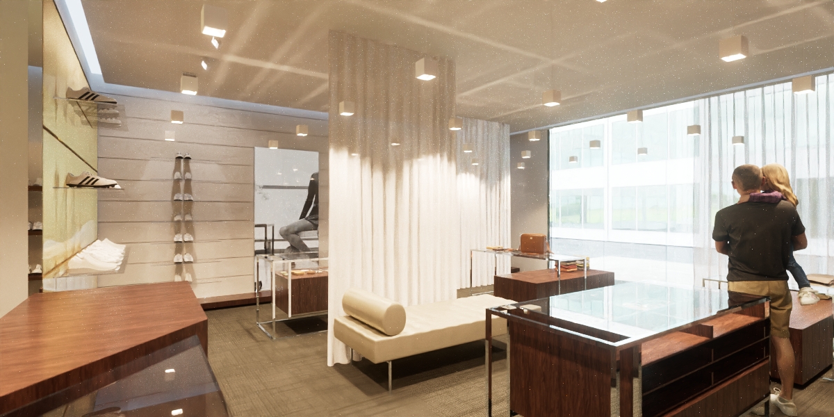

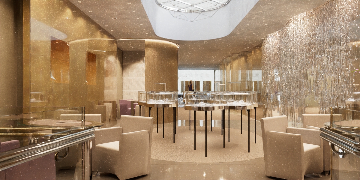

Some tests which do not make me wiser.
All glass surfaces have white shadow.
Bidir
Photon GI
Bidir
Photon GI

Some reflections are responding in a very different way wen using photon gi.

Re: bidir vs Photon GI (CPU)
In the second example I wonder why Pgi loose so much brightness compare to Bidir.
Different clamping Value ?

Posts: 311
interestingly in the second photon gi example the left wall is darker while the right /glass/chrome wall is brighter
