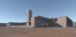

Hi Dade, we have started to study Lux's code but we didn't understand what we need to do to make the physical sky work with ACES. Can you give us some tips please about how to intervene?
This is with no ACES
no ACES.JPG (8.04 KiB) Viewed 98645 times
with ACES
In all other situations we get close to perfect results.

The sky model doesn't take any "color" as input so there is no color to convert from. It is just a model coming from a paper and it works in linear space. The output is converted to the color space you picked as any other pixel.
However I have the feeling your problem may be related to sky (color) temperature setting: it can have a quite dramatic impact on the end result and you should try to play with that parameter.

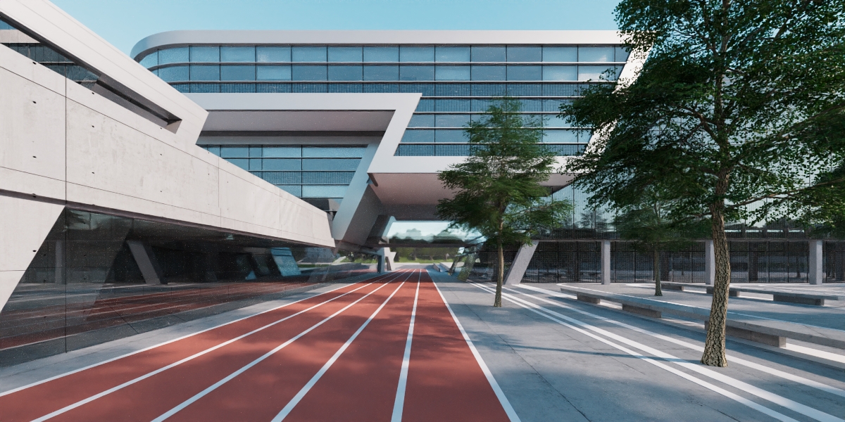

Hi Dade, i tried to put the sky color at 12k kelvin and still the cyan dominance is strong.
i cannot get a deep blue sky.

I have tested Dade Idea thanks to a Bender addon Dev on Twiter.
( @Dade By the way people seem to not be able to create an account on the forum)
And Temperature setting seems to give nice result :
Here are the full test : viewtopic.php?p=34152#p34152

I didn't had the opportunity to make some more scientific tests or accurate comparisons. For the moment i followed the advice of sharlybg, to vary the sun color temperature:
This is the reference HDRI result which seems great to me. I have many blue sky HDR's like this and all give more or less the same result. In any case no color shift to cyan.
