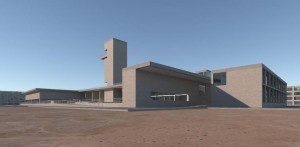

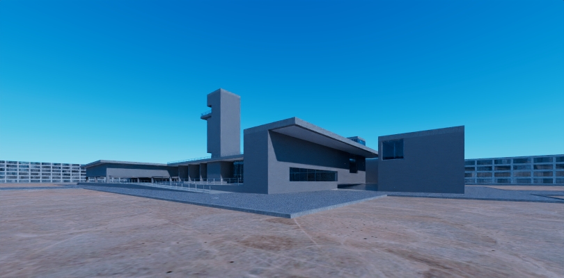

Hi Dade, we have started to study Lux's code but we didn't understand what we need to do to make the physical sky work with ACES. Can you give us some tips please about how to intervene?
This is with no ACES
no ACES.JPG (8.04 KiB) Viewed 98624 times
with ACES
In all other situations we get close to perfect results.

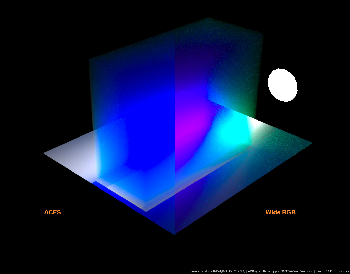

Unsure but, if blue skews then something's wrong (either implementation or engine) :|
Have you made any methodical tests to "establish color correction" or performed comparisons to see/show what happens to image data?
What I can observe here & there (ACES implementation in FELIX.), all appears subjective.
I.E.
ACES OT on Corona White Light through Blue volume
(source: https://corona-renderer.com/comparer/MxEqUe)

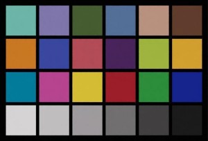

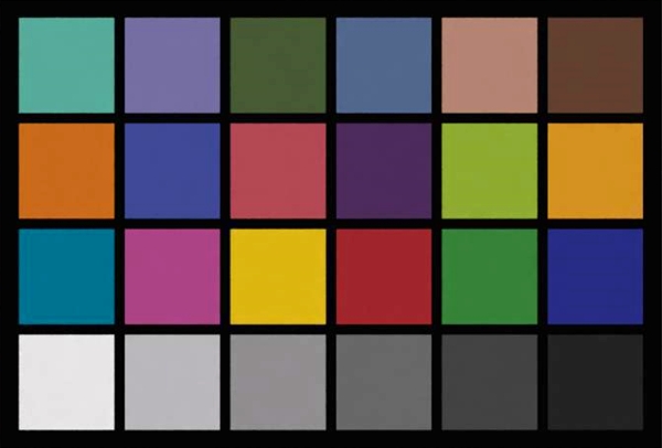

Hi Kintux, the following is one of the many many tests we did in order to tune ACES as good as we could to match linear.
No tricks, just applying the theory trying to avoid mistakes. The only thing i did was to adjust in post the exposure of the Linear in order to match roughly the greys of ACES.
If you have some specific ideas of other tests i could do in order to focus the problem please let me know, i will do them.
Lux Linear

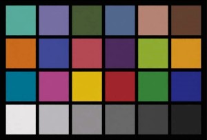

Aces

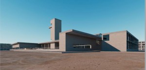

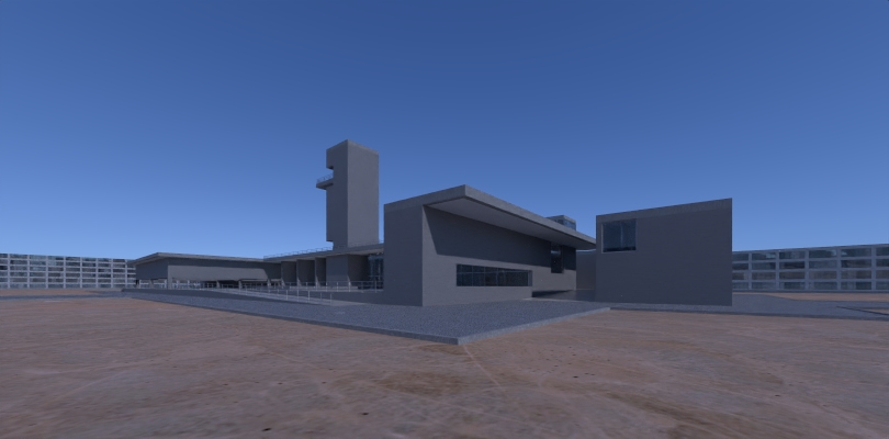

Hi Dade, i tried to put the sky color at 12k kelvin and still the cyan dominance is strong.
i cannot get a deep blue sky.
ACES off
ACES on

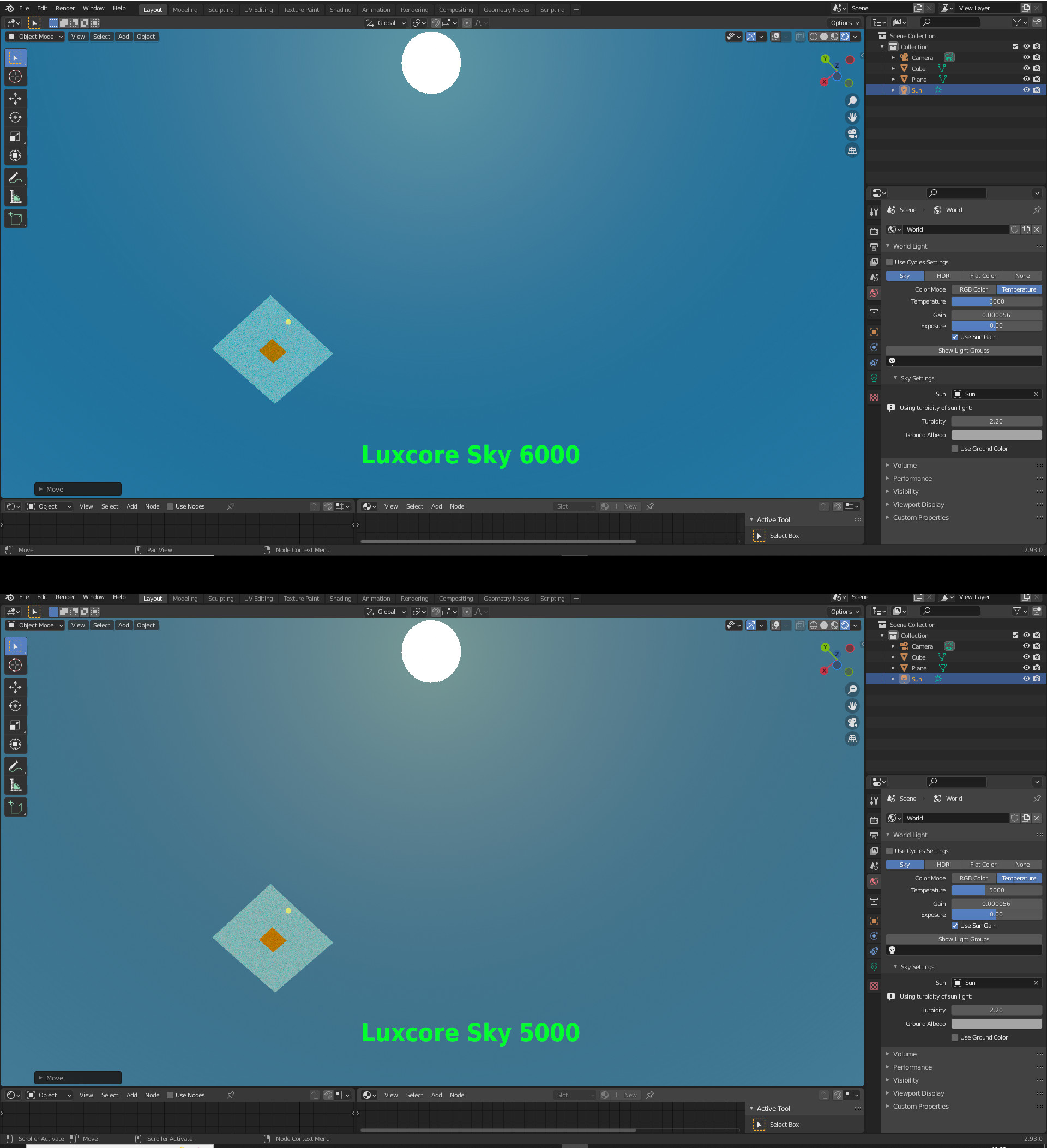

I have tested Dade Idea thanks to a Bender addon Dev on Twiter.
( @Dade By the way people seem to not be able to create an account on the forum)
And Temperature setting seems to give nice result :
Here are the full test : viewtopic.php?p=34152#p34152

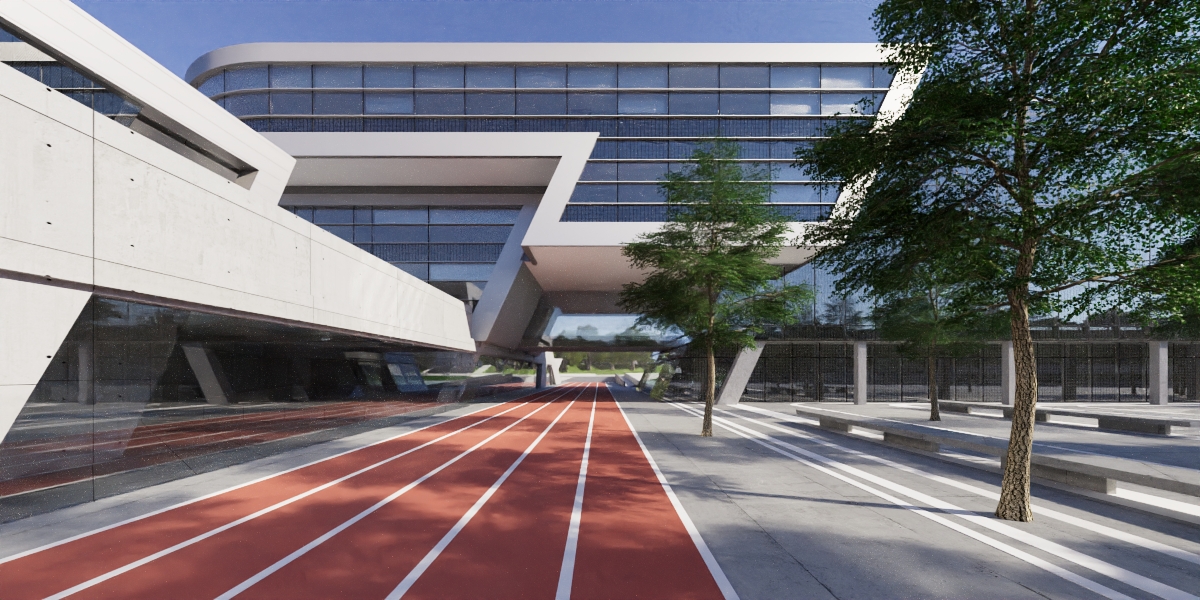

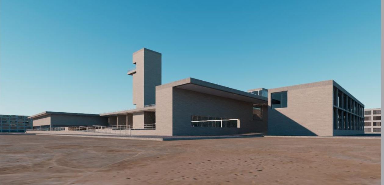

I didn't had the opportunity to make some more scientific tests or accurate comparisons. For the moment i followed the advice of sharlybg, to vary the sun color temperature:
This is the reference HDRI result which seems great to me. I have many blue sky HDR's like this and all give more or less the same result. In any case no color shift to cyan.

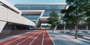

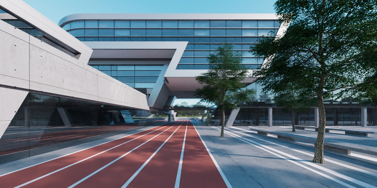

This one is physical sky at 6250K

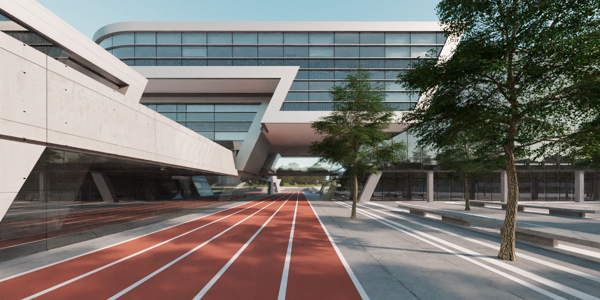

This one is physical sky at 5500K
This one is physical sky at 4750K
