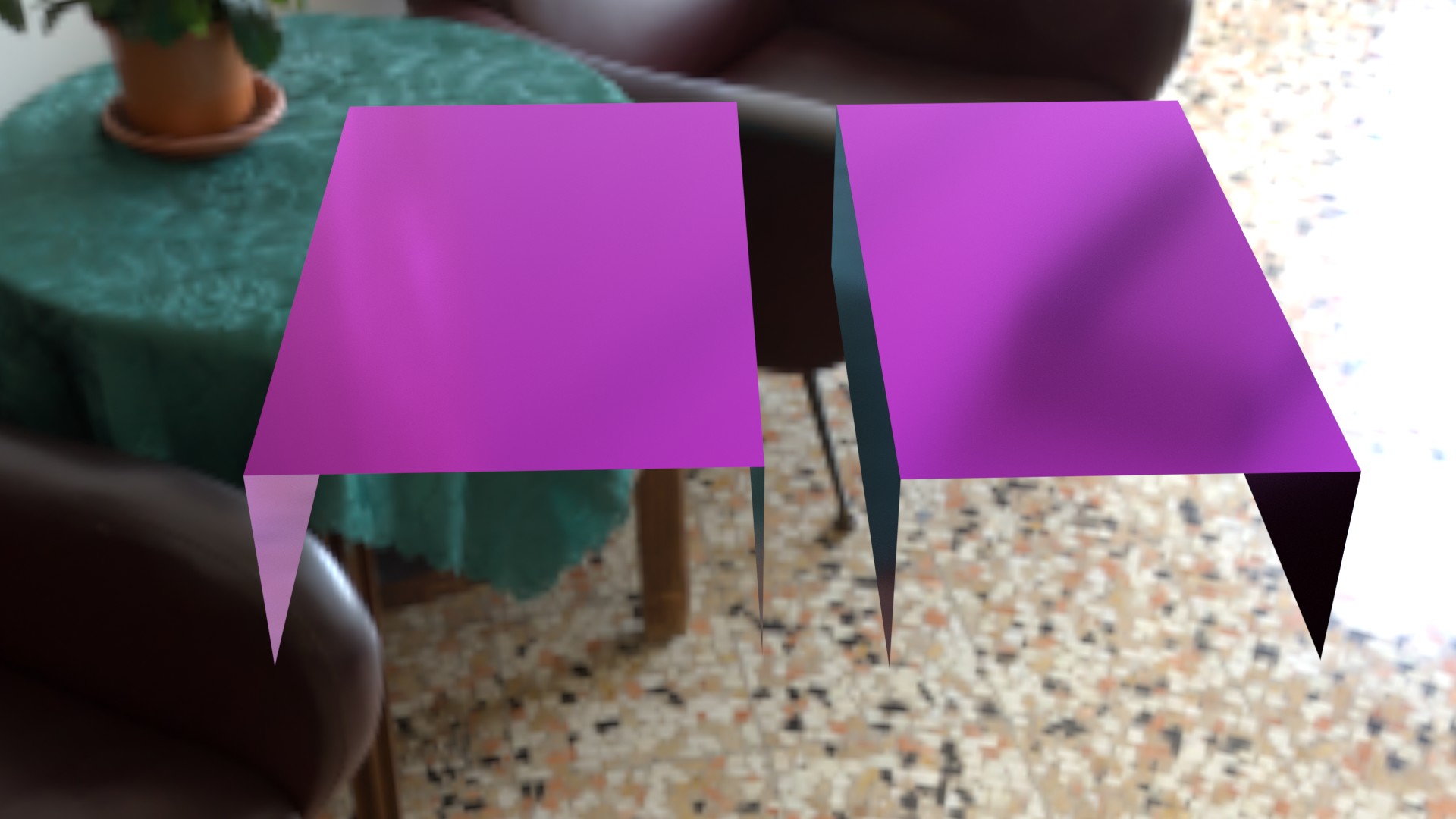

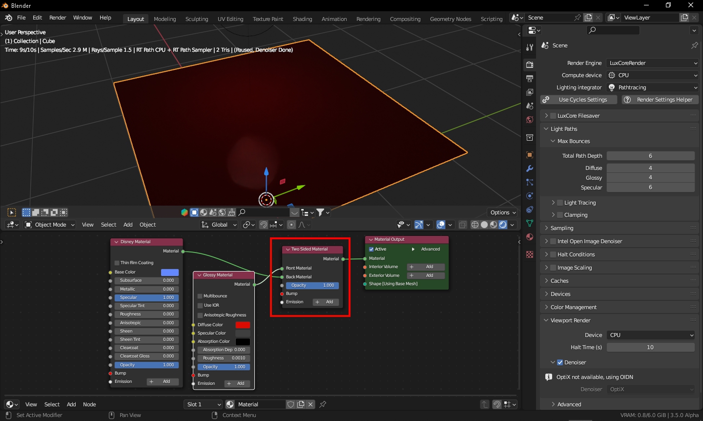

As the Title suggest i'm not able to get reflection on the back side of any geometry even while using
Two side material shader.Here is the blend and the screen capture.

Right, seems like a bug.
Cycles & other engines do fine with reflections, no matter which way normals are directed.
eg
Lux
Cycles
Re: Two side shader reflection broken ?
Posted: Tue Mar 01, 2022 3:39 pm
by epilectrolytics
Mirror and Metal materials work two-sided, Disney and Glossy only one-sided
