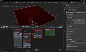

As the Title suggest i'm not able to get reflection on the back side of any geometry even while using
Two side material shader.Here is the blend and the screen capture.
Blend

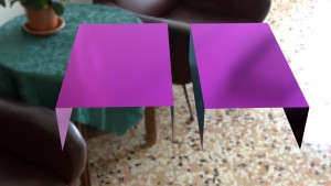

Right, seems like a bug.
Cycles & other engines do fine with reflections, no matter which way normals are directed.
eg
Lux
Cycles

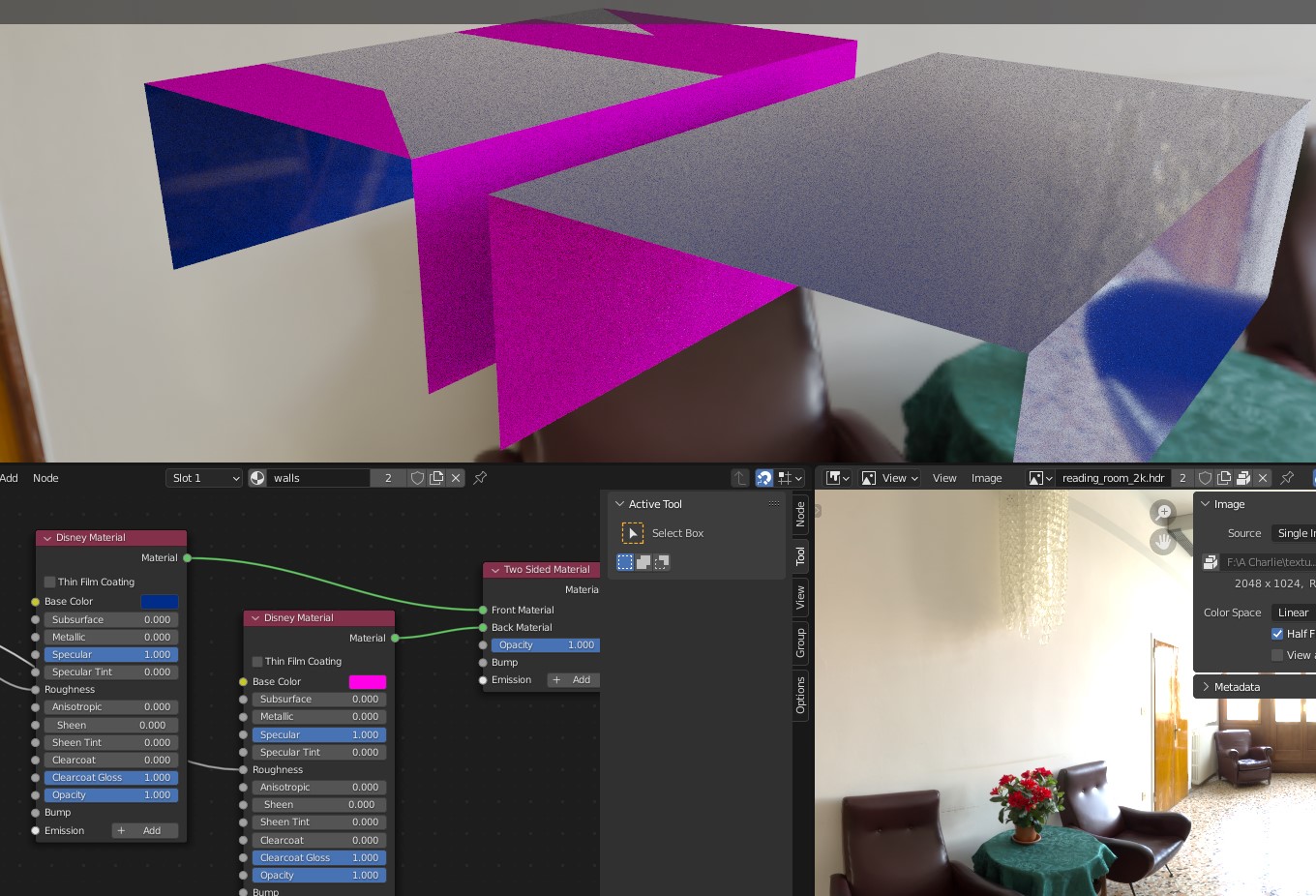

Mirror and Metal materials work two-sided, Disney and Glossy only one-sided :?

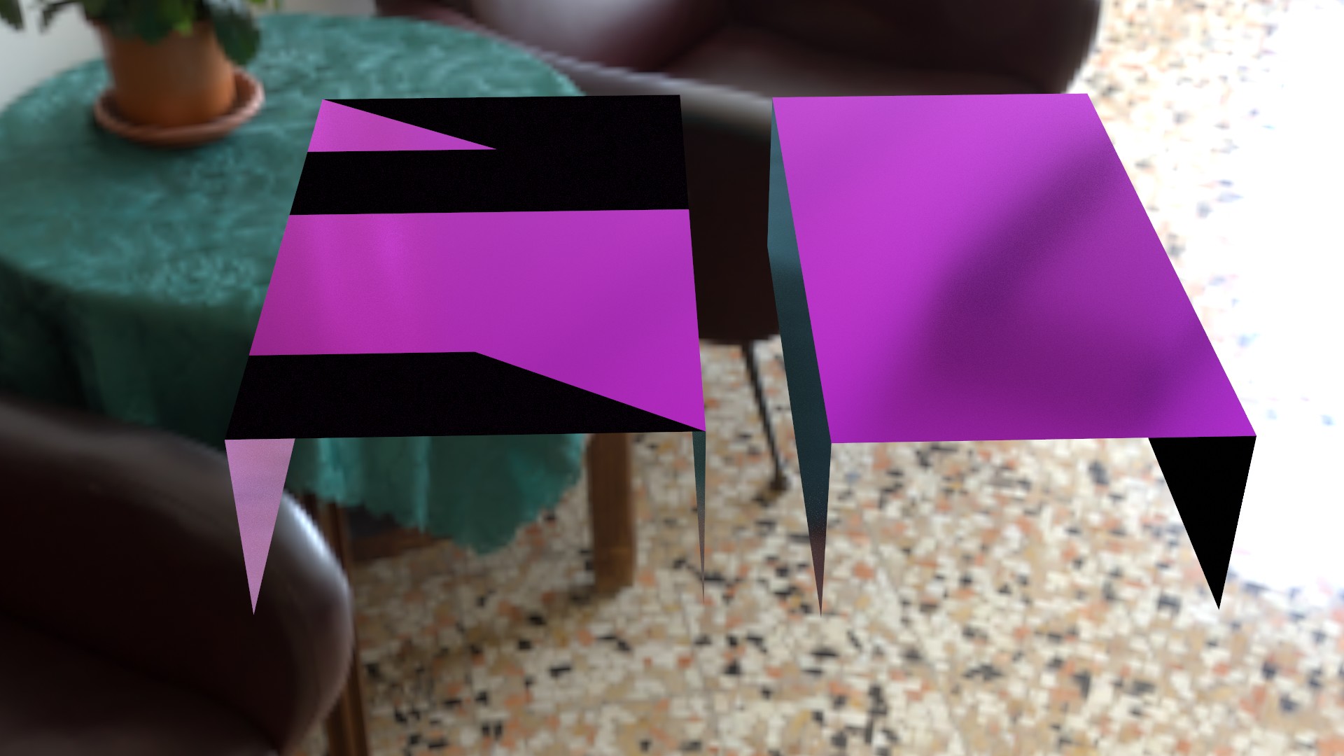

In version 2.62.1a from my test the reflection in 2sided material for the glossy and disney material doesn't work.
