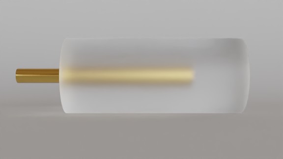

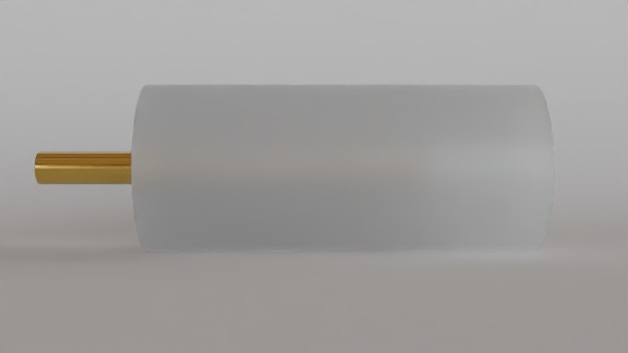

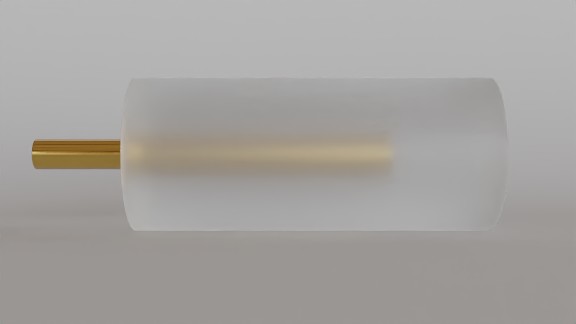

Posted: Fri Dec 24, 2021 8:14 am
by Sharlybg
few test :
rough glass + 75% white shadow without volume inside
rough glass + 75% white shadow + small volume inside
rough glass + 75% white shadow + high density volume inside
Blendfile : HDR : https://polyhaven.com/a/small_hangar_01
Dez.blend
(1.06 MiB) Downloaded 3230 times
