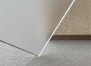

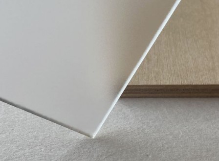

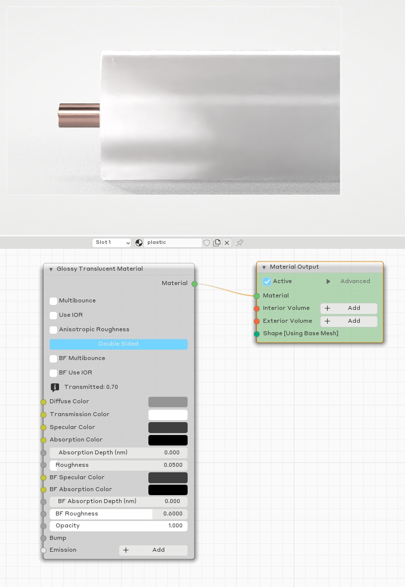

I'm having trouble making this kind of plastic.
I need help.
I need this kind of translucency
I need this glossiness (like porcelain)
I tried creating this in Cycles
It's about the same thing. But I want better, and I want Luxcore.

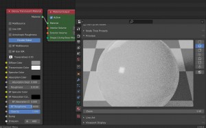

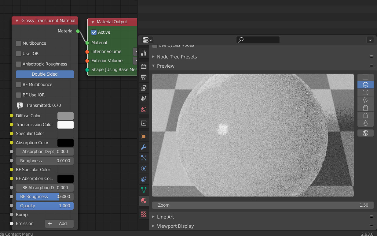

With these settings, the object does not become transparent.

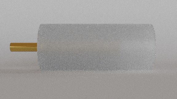

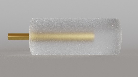

And here is the problem that accompanies me in every material that has a volume - the objects behind (which are visible through the transparency of the volume) have clear contours.
I get like this
and I need it to be blurred
and I don't understand what you need to do to get this blurring effect with homogeneous volume

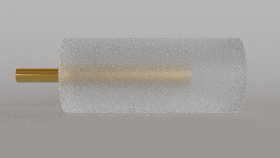

so just check the rough glass box.
It should do the trick.
Re: How to make white, translucent, glossy plastic

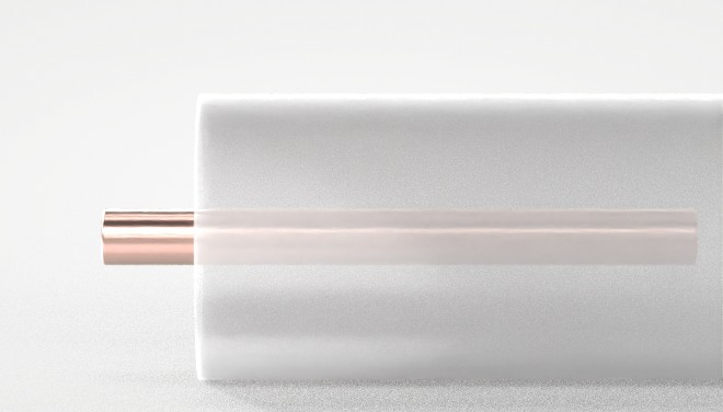

few test :
rough glass + 75% white shadow without volume inside
rough glass + 75% white shadow + small volume inside
rough glass + 75% white shadow + high density volume inside
Blendfile : HDR : https://polyhaven.com/a/small_hangar_01
Dez.blend
(1.06 MiB) Downloaded 3241 times
For sharp reflections, you can add a glossycoating material with low roughness.

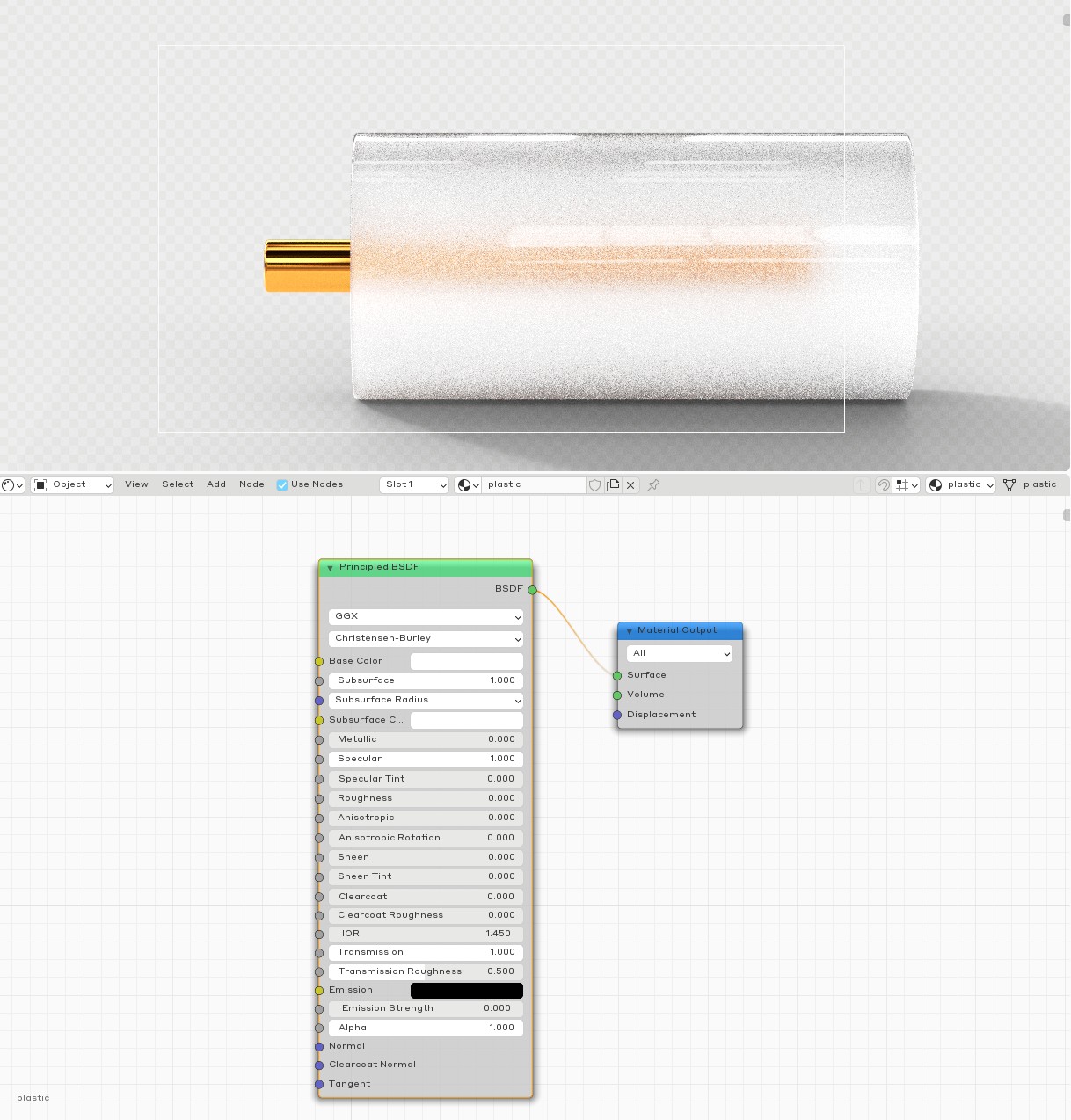

So, the glass material has the ability to blur the transparency through roughness, and then bring back the gloss by adding a glossy coating
It doesn't seem right to me to make plastic objects with glass material. Is it possible to blur the transparency of Glossy materials?
Dez!
Posts: 369
Location: Ekaterinburg
Post by Dez! »

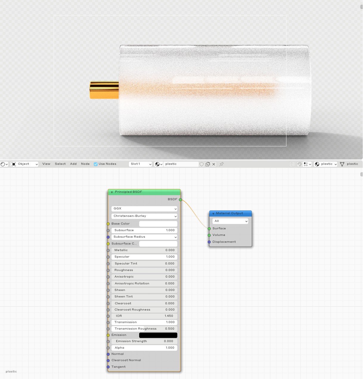

If I increase the Scattering Scale parameter, I get a darkening. And this is correct - the number of microparticles inside the material increases.
If I act similarly to the glass material and increase the Roughness parameter, then the glare is blurred, without affecting the transparency in any way:
