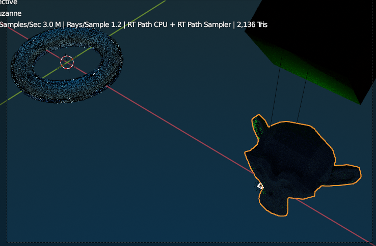

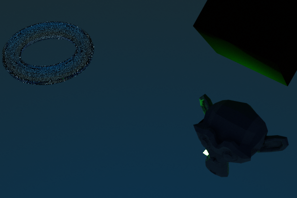

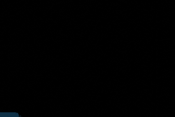

The attached file with activated PhotonGI Cache can't render properly (the image is almost all dark, with some non-black pixel in the bottom left corner). Without PhotonGI and render in view3d space work properly. It is a simple file, and I can't figure out what's wrong with it... Could you check it?
With Photon Cache:
Without Photon Cache:
View3D in render mode:

It looks to me that your problem is just in the halt condition: you have set to halt after 10secs and, with PGI enabled, the pre-processing phase is not yet over after 10secs so you just get an empty image with 0 samples per pixel.

Dade wrote: Mon Dec 06, 2021 4:29 pm It looks to me that your problem is just in the halt condition: you have set to halt after 10secs and, with PGI enabled, the pre-processing phase is not yet over after 10secs so you just get an empty image with 0 samples per pixel.
