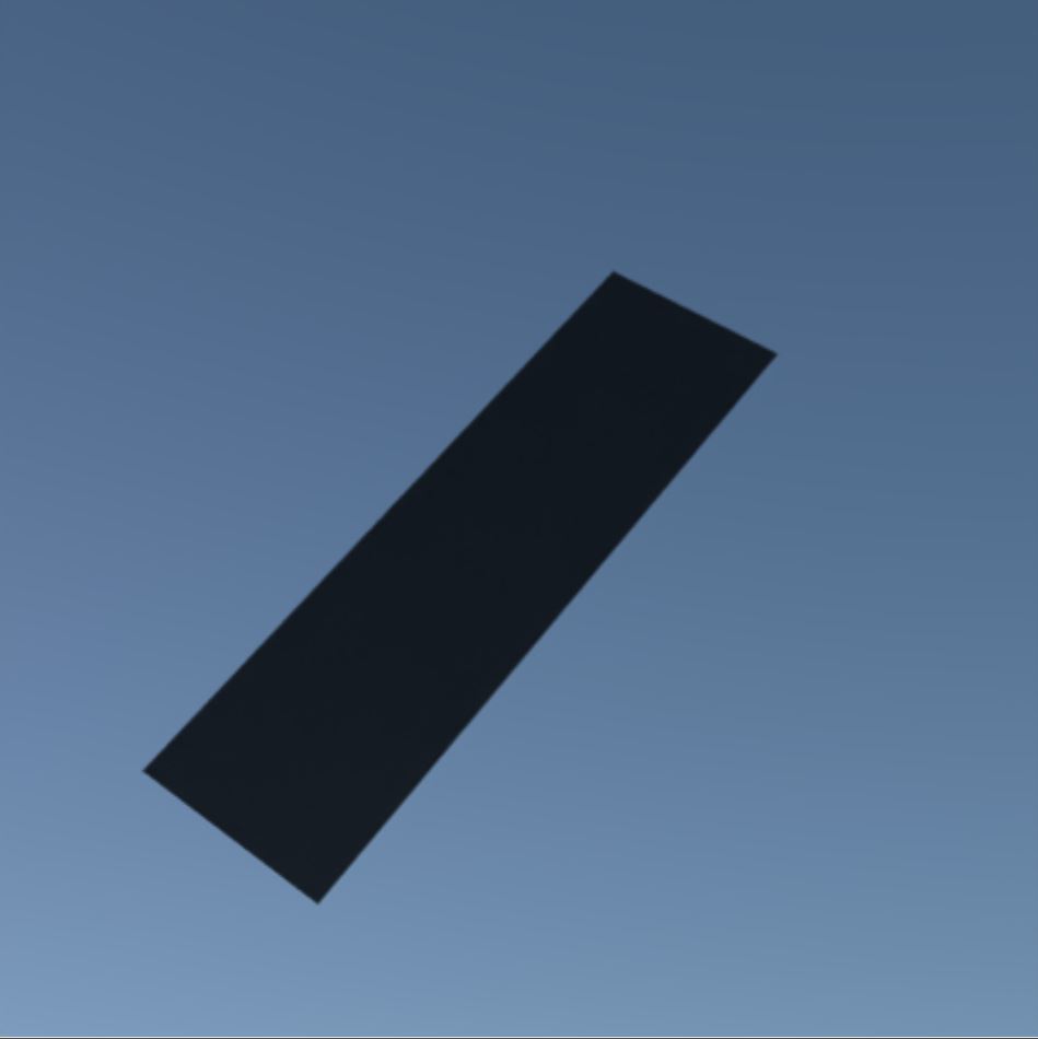

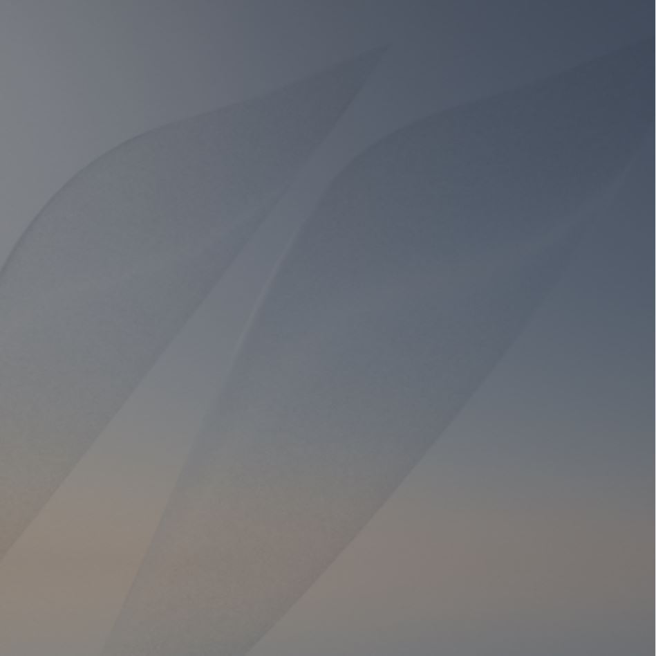

				Hi, i experiencing some strange behaviour with this geometry and glass material
geometry + physical glass material, rendered in maxwell
flipped geometry + physical glass material, rendered in maxwell

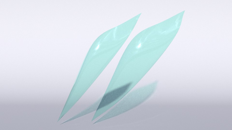

geometry + physical glass material, rendered in luxcore
				Re: two glass issues
				Posted: Sun Sep 05, 2021 10:37 am
				by Sharlybg
				You may need to post the known geometry for efficient help.
				Posted: Sun Sep 05, 2021 11:41 am
				by daros
				Ops, sorry, i edited the previous post and added the file, thanks.
				Posted: Sun Sep 05, 2021 11:56 am
				by Dade
				It is not a closed surface: it is not a valid volume.
				Posted: Sun Sep 05, 2021 12:21 pm
				by daros
				But in complex projects it can be a huge pain for non professional modelers to archive perfectly cosed volumes for glazings like this:
So it is a great + if the render engine can deal with them as maxwell does. The same is true for flipped glass surfaces.
Often this kind of 3D models arrive from nurbs based softwares which have even bigger issues in creating perfectly closed surfaces.
				Posted: Tue Sep 07, 2021 10:02 am
				by kintuX
				What app do you use?
At what scale, size & units is your object rendered?
Your "bug.obj" geo, though relatively big (~20m high) renders fine with BlenLuxCore...
				Posted: Tue Sep 07, 2021 11:20 am
				by daros
				interesting... are you using bidirectional? I think scale is meters, however it should be clear looking at the scene files i attached.
Yes, i revised it is in meters.
