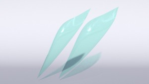

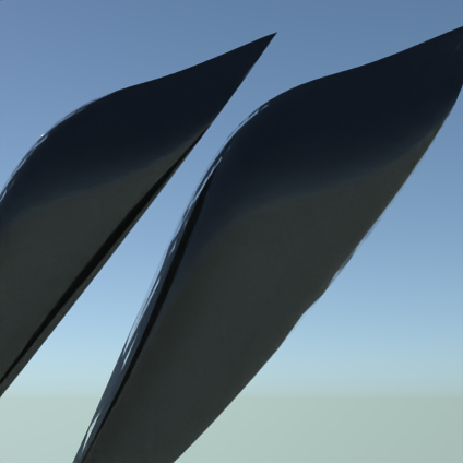

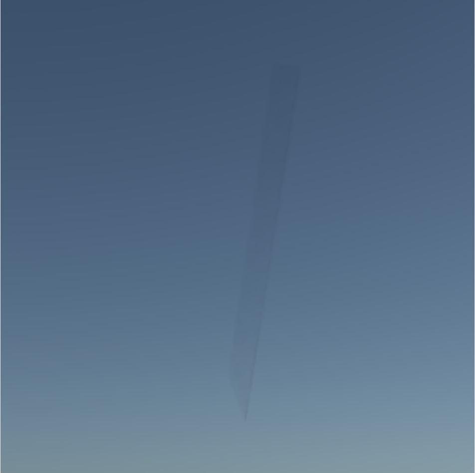

Hi, i experiencing some strange behaviour with this geometry and glass material
geometry + physical glass material, rendered in maxwell
flipped geometry + physical glass material, rendered in maxwell

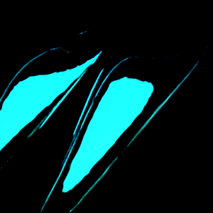

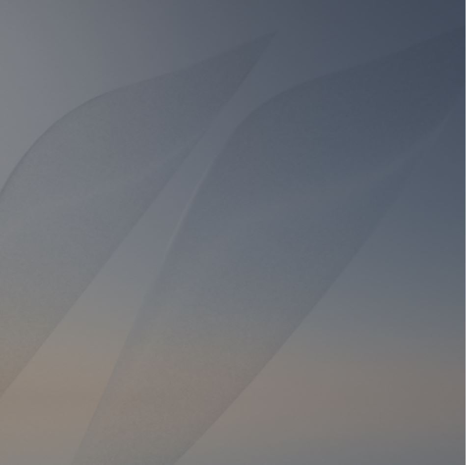

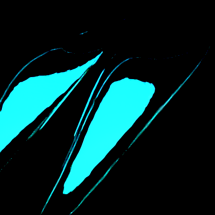

geometry + physical glass material, rendered in luxcore
bug.zip
(104.8 KiB) Downloaded 606 times

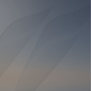

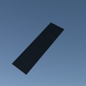

Posts: 309
Re: two glass issues
now i get this with identical scene and geometry, only camera angle varies
vetro1.zip
(2.75 KiB) Downloaded 642 times
vetro2.zip
(2.75 KiB) Downloaded 603 times

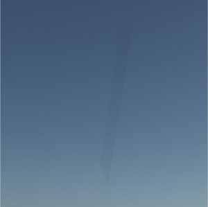

Posts: 309
this seems an issue of large glass surfaces with small thickness
Posts: 309
Is there a tolerance value which has to be lowered in order to get this kind of glass volume right?
