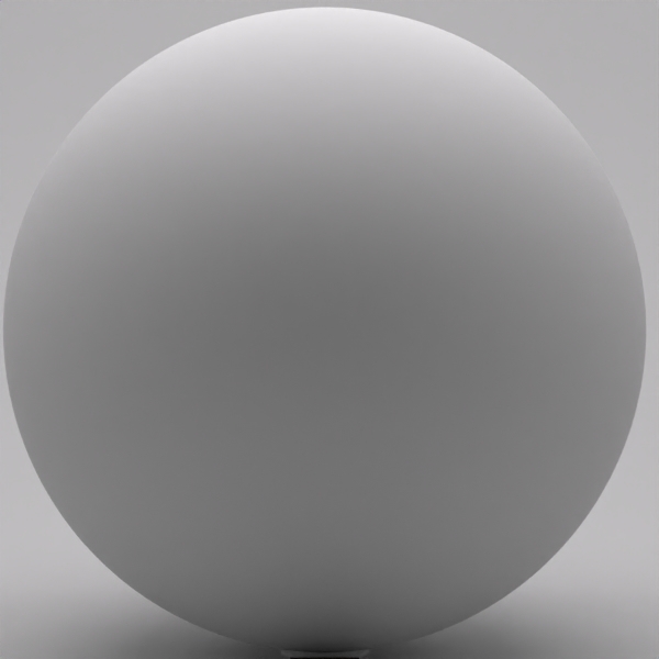

by daros
Linear
Linear -20% exp
LUT applied (lut pipleine or ocio identical results)
LUT applied - 20% ep
The LUT - 20% exposure shows clearly that the bright area is completely flattered.
