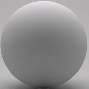

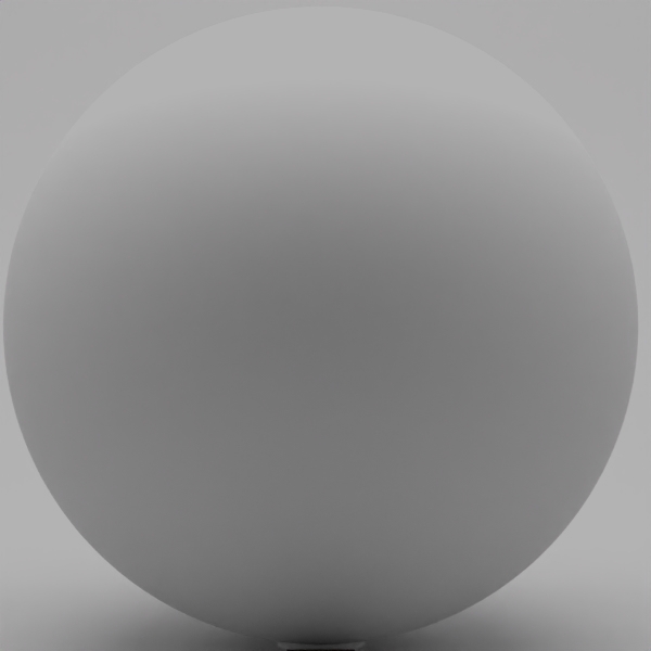

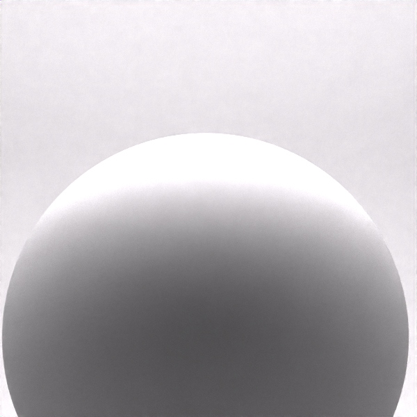

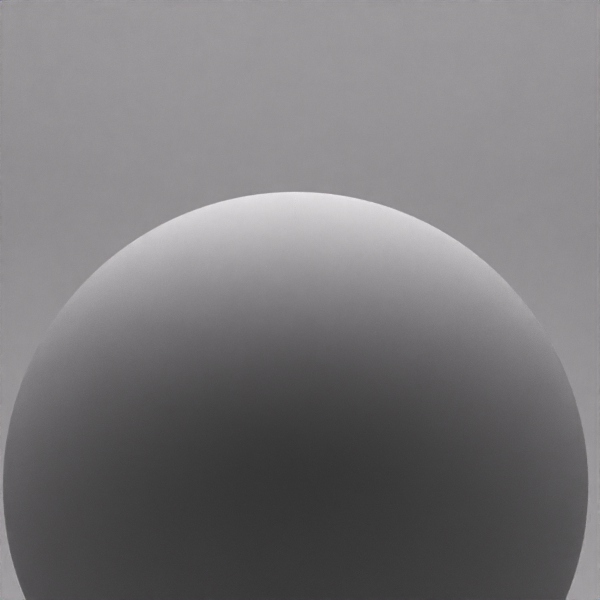

Linear
Linear -20% exp
LUT applied (lut pipleine or ocio identical results)
LUT applied - 20% ep
The LUT - 20% exposure shows clearly that the bright area is completely flattered.

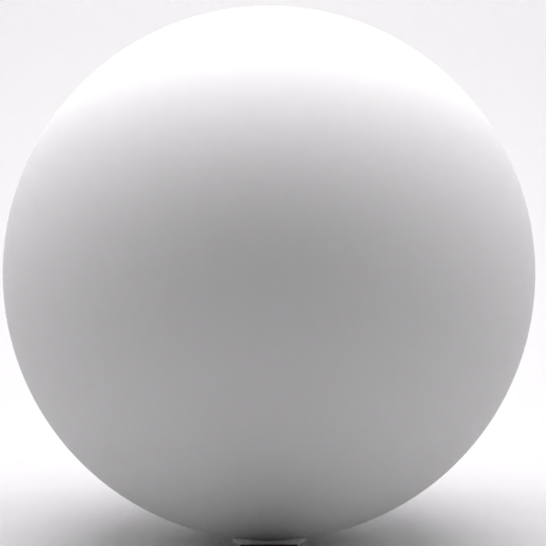

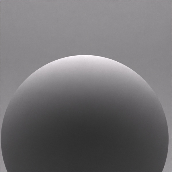

I'm unable to replicate your results.
This is an exposure 0.1 rendering without LUT:
This is an exposure 0.06 rendering without LUT:
This is an exposure 0.06 rendering with LUT:
The last image is clearly different from your result.

bartek_zgo wrote: Mon Aug 09, 2021 7:56 am We can recover burnt areas. If we add lut files, we can not recover them.
Yes, because LUT are expecting values between [0.0, 1.0], they are not defined outside that range. Because of this, the values are clamped between [0.0, 1.0]: https://github.com/LuxCoreRender/LuxCor ... ut.cpp#L80
The code linked above is my code but the proof it is correct is in the test with OpenColorIO: it produces exactly the same result (and it is written by other people).
It is your procedure to be wrong, you need to adjust exposure before LUT (like I did in my test above), not after. LUT expects values between 0.0 and 1.0 so you can use them only after tone mapping (i.e. exposure adjustment), not before.
