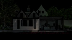

Noised image:
denoised by Luxcore:

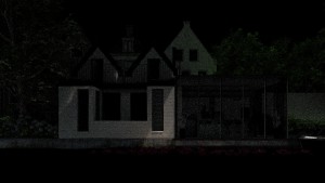

Caustics:
Denoised Caustics using Open Intel image Denoiser Node:

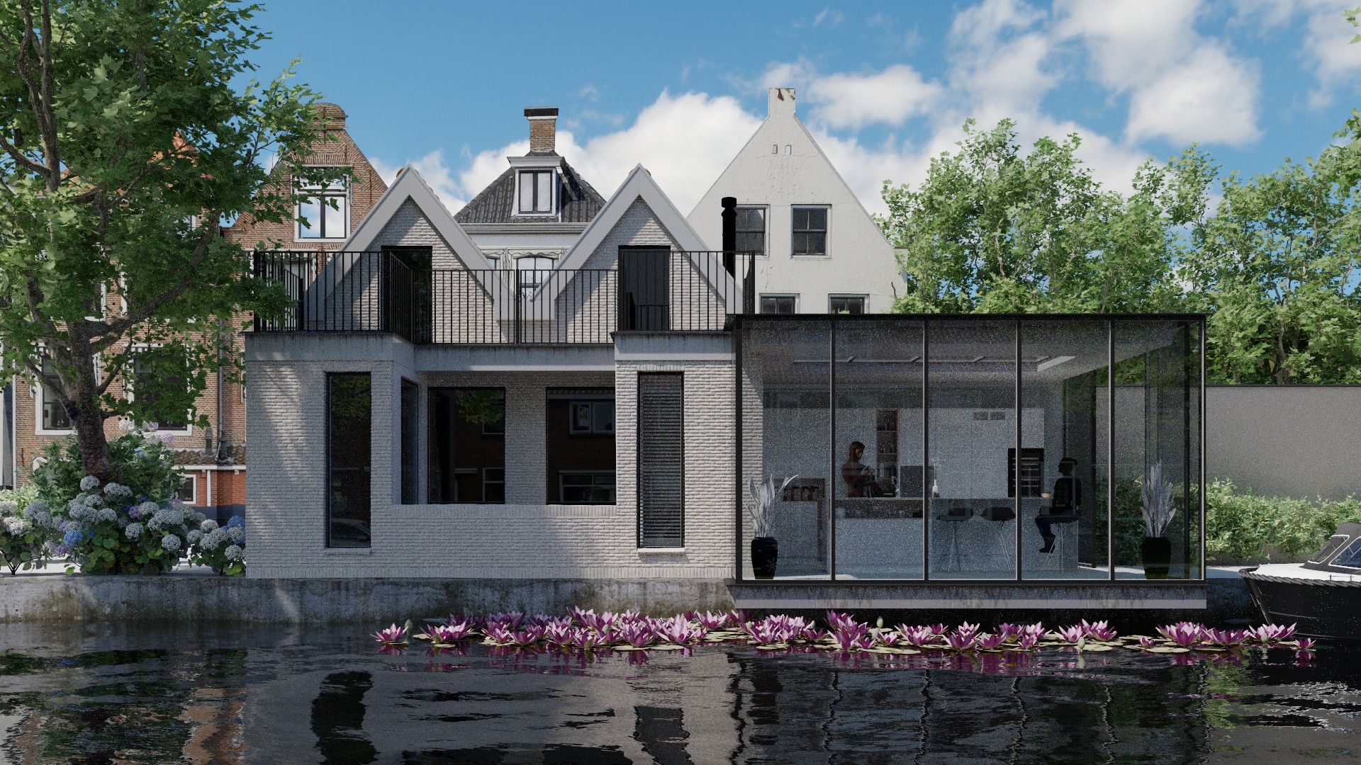

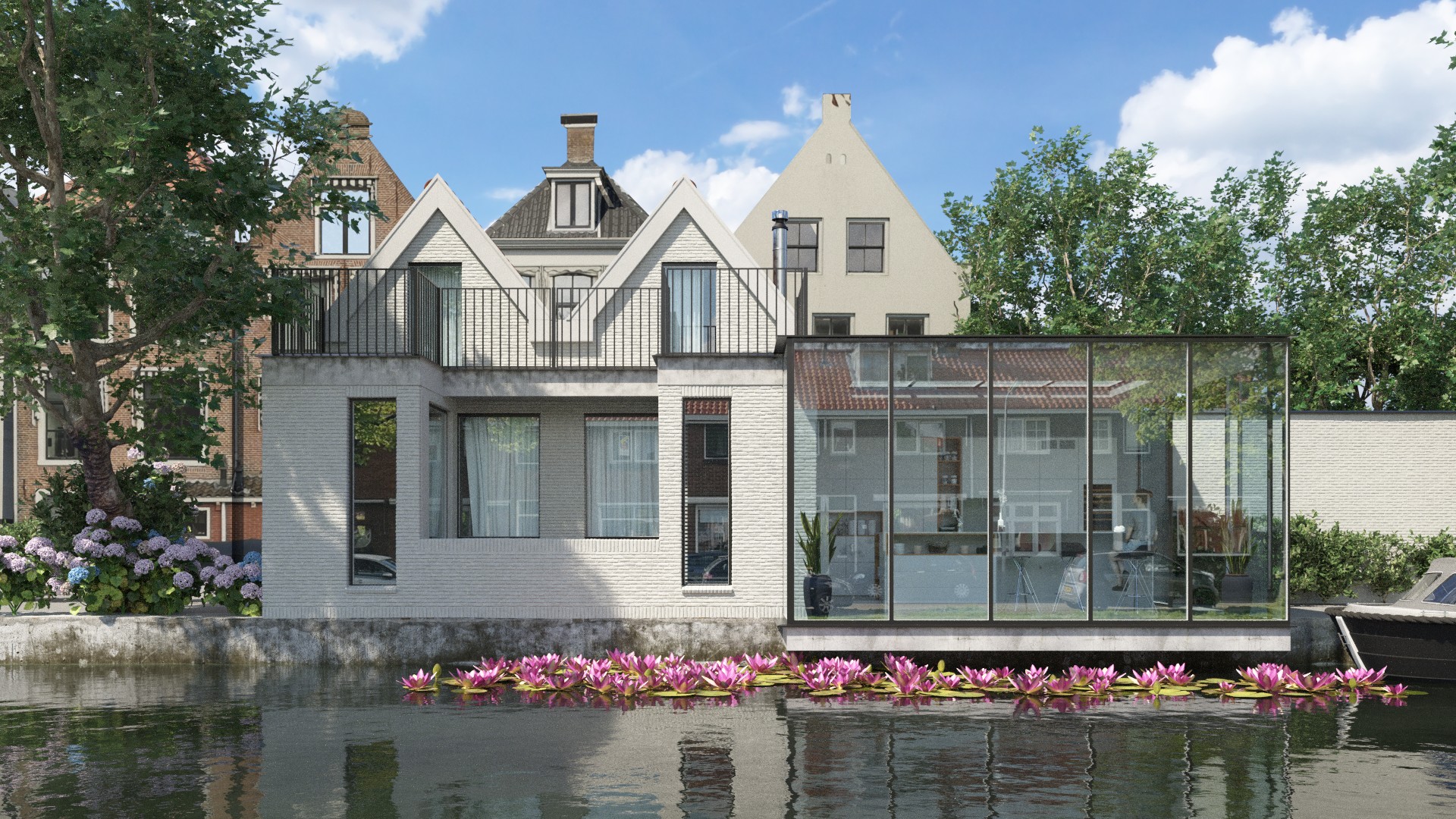

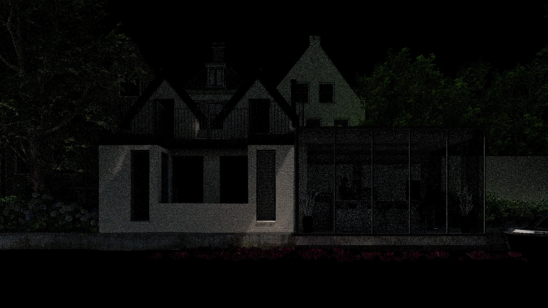

And here are Octane outputs, rendered in 3minutes and 35s
Noised image
Denoised image used Denoise node:

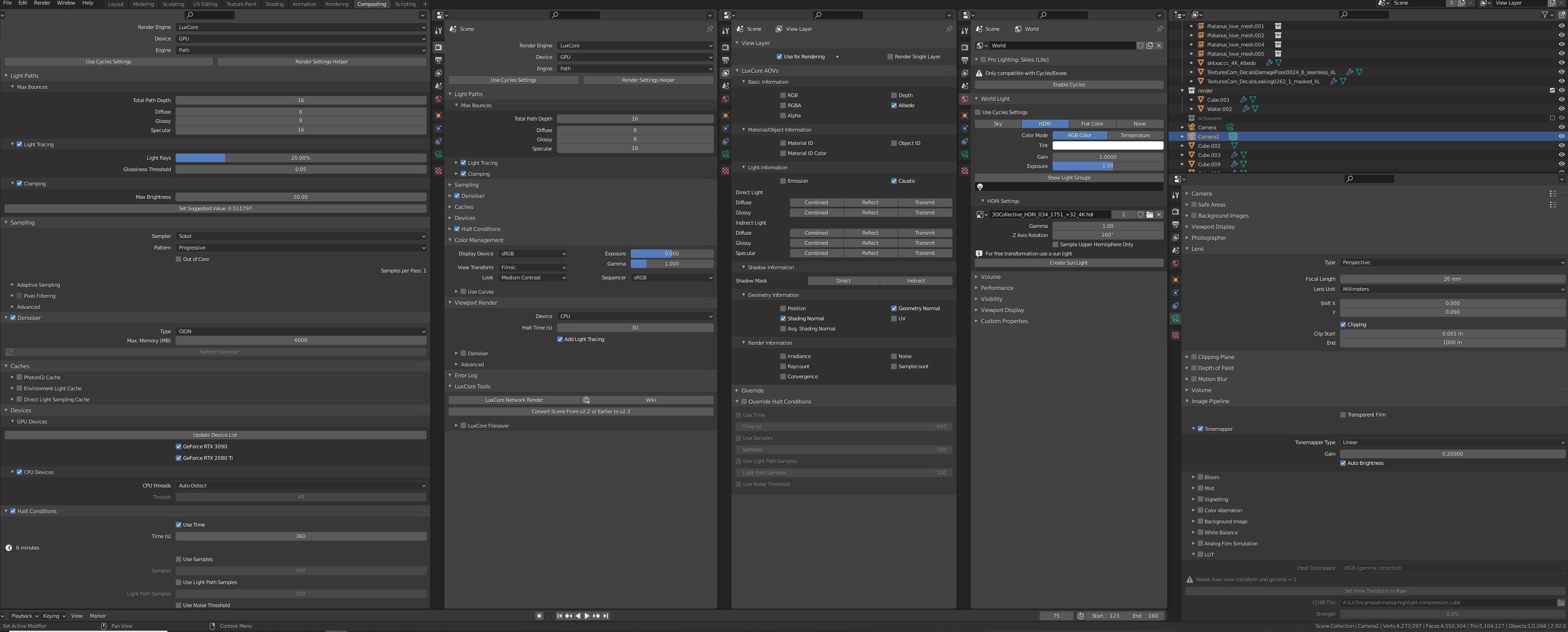

Here below are Luxcore settings:

First try to match octane lighting if you want to compare ( Hdri rotation and power)
Second it look like your clamping value is unnecessary high (Suggested value is arround 0.5 and you render with 100X higher value. try something closer to the suggested value until you loose to much details in lighting quality).
Third you really don't need Light tracing to be enable for this scene i think only a white shadow color on your glass panel will make it easier to render.
Fourth for a linear lighting approach disable auto brightness in your camera setting put something default like 1 and play with your HDRi power.

Sharlybg wrote: Sat Jun 05, 2021 8:21 pm First try to match octane lighting if you want to compare ( Hdri rotation and power)
It isn't a new project, I'm working on it quite long, and I made also versions where Luxcore scene is lightened similiar way as Octane (I didn't find any possibility to make Ray switch setup for environment, where lighting is caused by one HDRi and reflections/background by different, which is common in other render engines.) So I used Background image in camera Tab. The topic with Luxcore renders compared to the Octane renders are here: https://blenderartists.org/t/dutch-exte ... /1306520/4
Sharlybg wrote: Sat Jun 05, 2021 8:21 pm Second it look like your clamping value is unnecessary high (Suggested value is arround 0.5 and you render with 100X higher value. try something closer to the suggested value until you loose to much details in lighting quality).
The first test were made using suggested value, and in my opinion looked much worse, so I decided to play with this value.
Sharlybg wrote: Sat Jun 05, 2021 8:21 pm Third you really don't need Light tracing to be enabled for this scene, I think only a white shadow color on your glass panel will make it easier to render.
As far as I observe the world, there should be caustic on facade, especially in the shadows. Isn't this option responsible for reflection caustics? I do not need caustics from windows, only from water. Is there any possibility to render only caustics, without rendering other data?
Sharlybg wrote: Sat Jun 05, 2021 8:21 pm Fourth for a linear lighting approach disable auto brightness in your camera setting put something default like 1 and play with your HDRi power.
Will check it. First I had Camera settings exposures, but while testing changed it to linear.

For caustics underwater you need to enable caustic cache.
Theses caustics aren't the usual one you can render with light tracing.
You just render it and make the cache persistent so that you don't to rerender it again and again.
