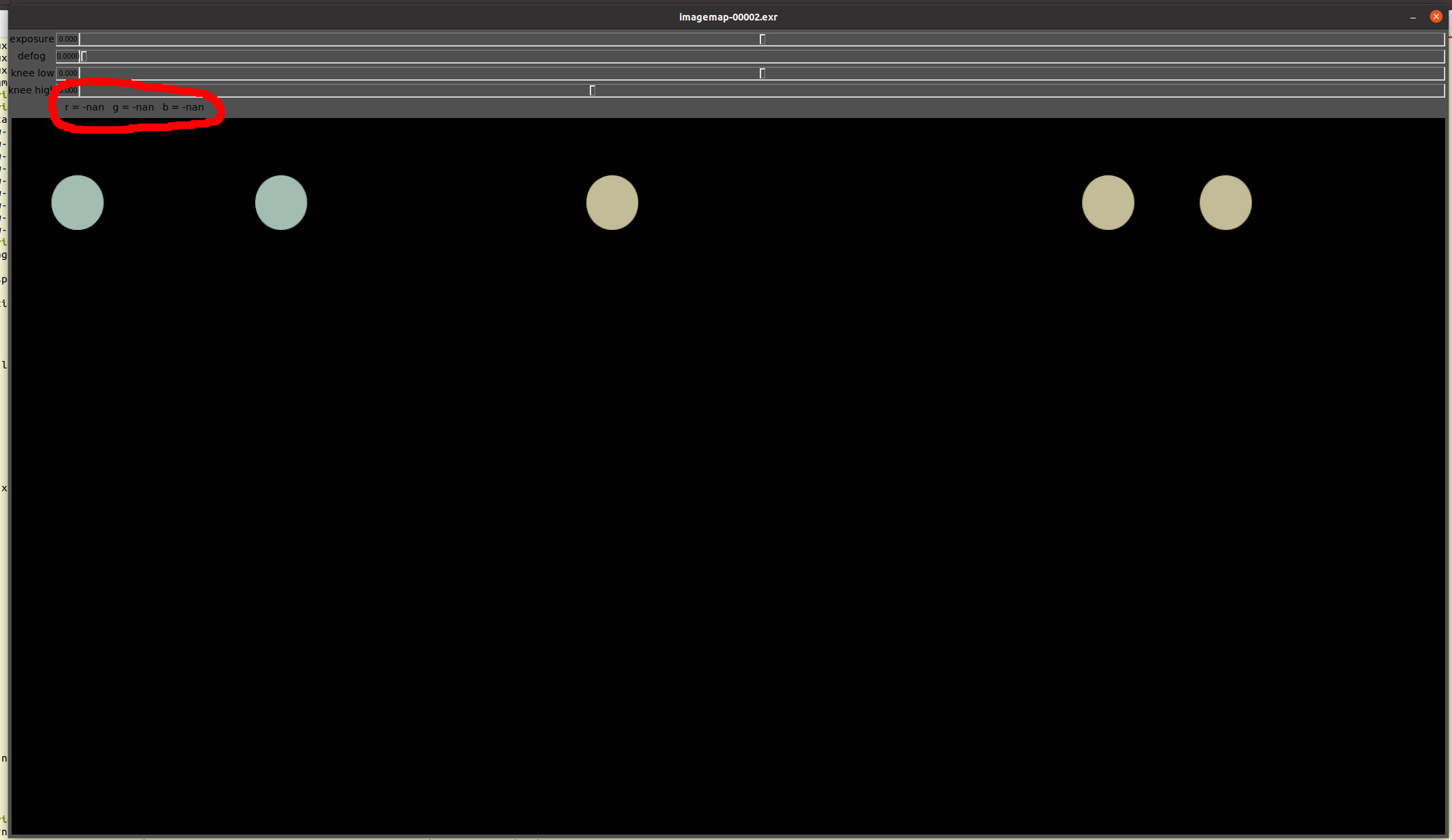

The problem is triggered by the broken/corrupted HDR used for your infinite light source:
As you see, it is full of NaN values. This cause a cascade of problems: building the importance sampling map will go horrible wrong, power base light strategy will not work, etc.

bartek_zgo wrote: Tue May 11, 2021 12:17 pm
The interesting thing is that original file do NOT have any NaN.
You original image doesn't have NaNs but have negative values:
It is still stuff a light source can not emit. Use exrtools (i.e. exrdisplay in this case) to check .exr files; it is the reference ILM OpenEXR implementation.
